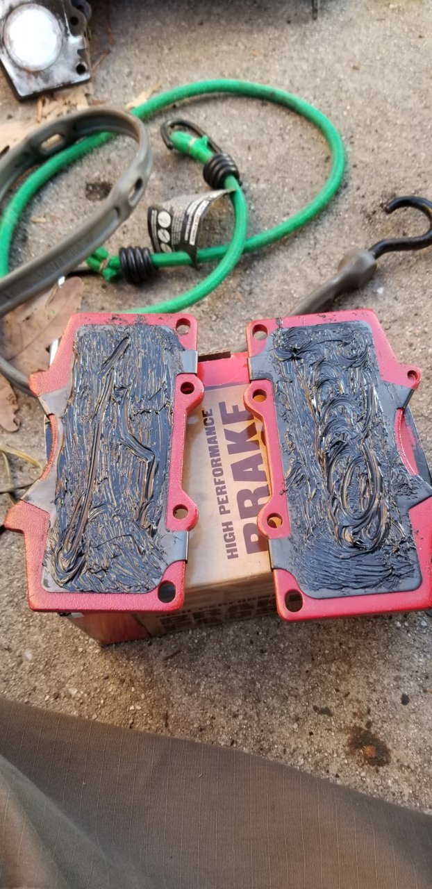

    That looks like a lot of lube. You greased them the first go around and ended up with squeaking? Did you discard the original anti-squeal shims, so that you are only running the TRD shims? I don’t typically run lube on the back of my pads.

    What you see in the pic is just the TRD ones. I just put the drive side back together gonna check passenger now

    That’s what I thought but just checking. Brake squeal can be very frustrating. I don’t have a lot of experience to offer with different lubes to fight squeal as the shims alone typically work for me. I’m assuming you have also bedded the pads?

    Yep I will try again after I relube...just wanted to make sure I didn't f up.
    I did bad them quite well and it definitely has crazy bite
    Just sounds like they're old pads

    Ok regressed it all. To include the little w clip that holds everything in place. Took it for a drive no squeals so far. Here is hoping it's gone.
    Bite still there.

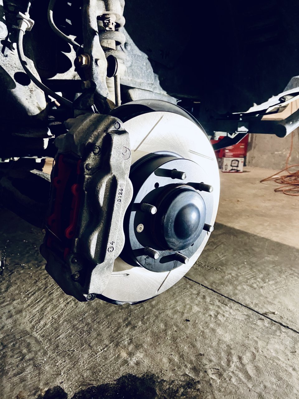

    This upgrade is pretty great. Just got them installed last Sunday with the help of a local member @whatstcp and I couldn’t be any happier with the improvements. We even did a full brake fluid flush and I have a firm pedal again. And no more steering wheel shimmying when braking at highway speeds. If your on the fence about this upgrade don’t be it’s well worth it. Thanks @crashnburn80 for providing such detailed information as always. 513F7A93-B2CE-48B7-A53F-E1F76DC2D738.jpg
