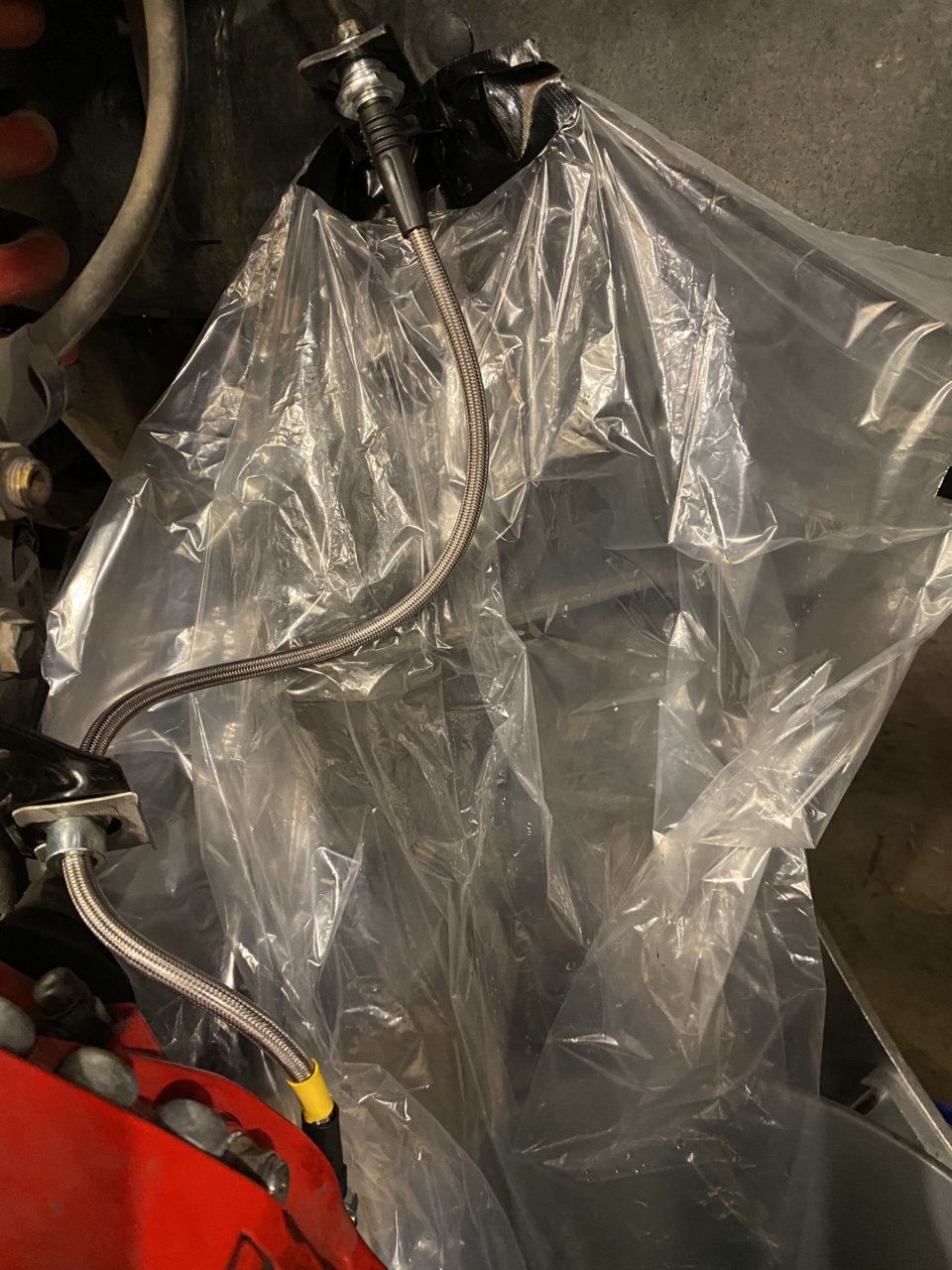

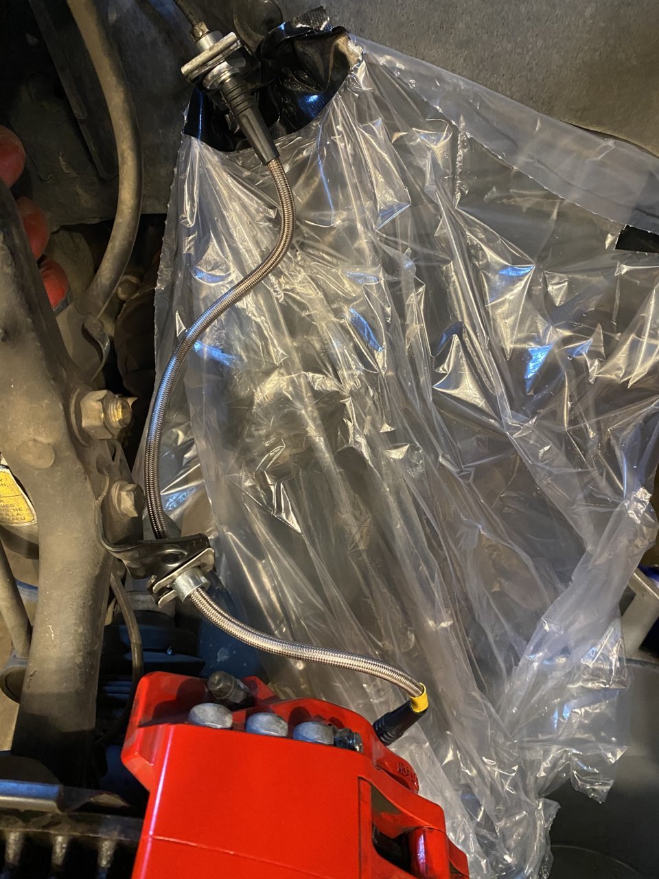

    Finally getting around to swapping pads for the StopTech Sports, and the correct length non-extended brake lines, and the new lines rub the bump stop mounts. Little hard to see with the plastic to protect against the brake fluid.
    Anyone else have this issue with the StopTech BBK kit? Running the 340mm ST60 kit on about 2.25” front lift.
    Jpmurph likes this.

    Zip tie it somewhere? Kinda funny the correct brake lines have issues

    I was trying to avoid the zip tie solution. Chafing on the lines isn’t your friend.
    I use some 17” pliers and bent the lower brake line mount so that rather than pointing directly at the caliper it angles the line closer to parallel to the caliper (keeping the line body away from the caliper) and directing the line more forward toward the chassis, keeping it away from the bump stop. Looks to clear adequately in all places now.

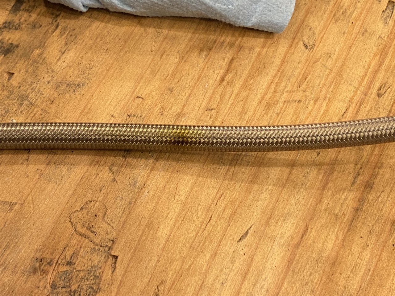

    And this is why zip ties are not your friend.
    I had placed a zip tie as a very temporary measure to keep my excessively long brake line clear of danger. Ended up staying on way longer than planned, but after just 2 months you can see the line is discolored where it rubbed on the zip tie.

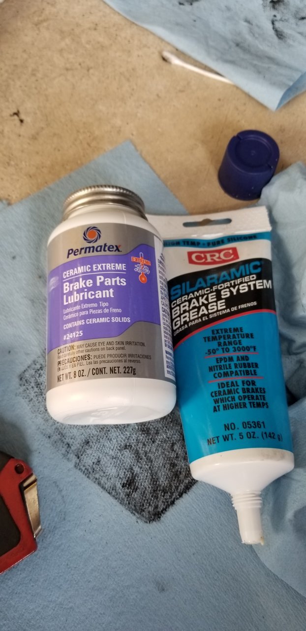

    Just as important in a brake job as good rotors and pads are proper cleaning and lubrication. Those are very good lubricants. I used Silaramic to fix squeal on my wife's car a while back, originally used the cheapest "high" temp silicone grease I could get locally, barely lasted 3 months before it squealed. Cleaned everything well, gave every contact surface and pins a good amount and squeal was gone. I used it while doing my brakes on my truck a year ago and haven't heard a thing. Permatex also makes Silicone Ceramic Extreme Brake Parts Lubricant 80653 which is probably as good, if not better than the regular Ceramic Extreme. I've heard of people swear by Napa Sil-Glyde for slide pins since its silicone-based instead of PAO based so it is compatible with rubber boots (won't swell boots). The same people swear by Silaramic or an equivalent on just stationary metal to metal parts since it contains a little solid lubricant (zinc oxide), so it may not be best for slide pins but probably great for extremely hot metal parts.

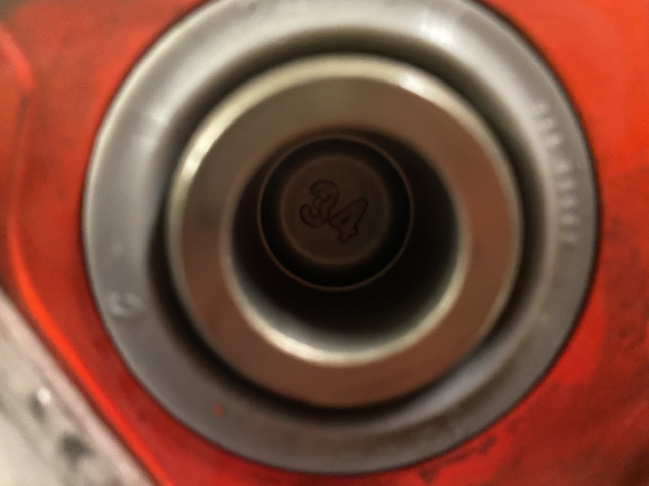

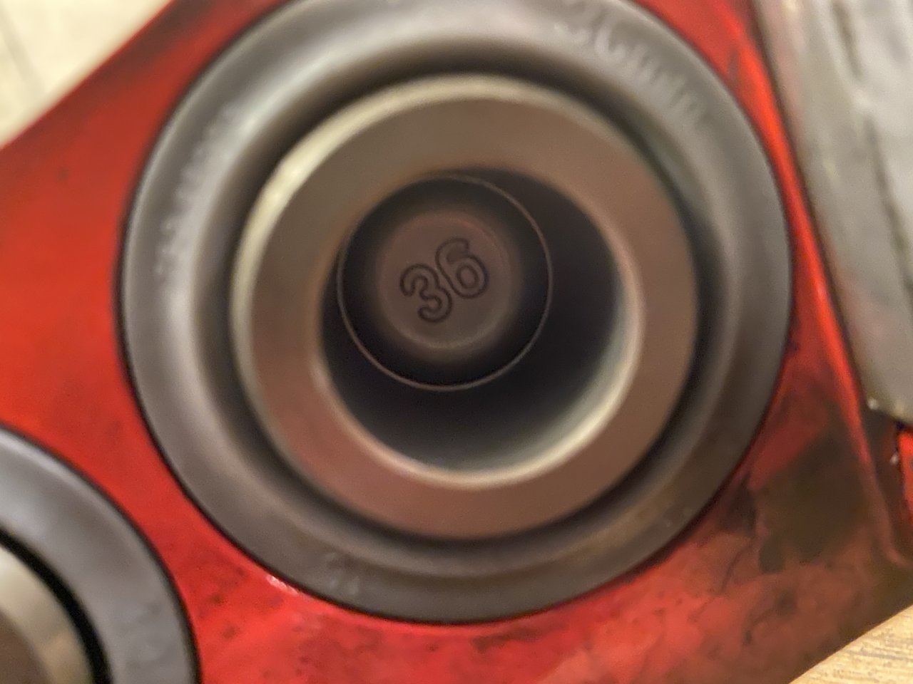

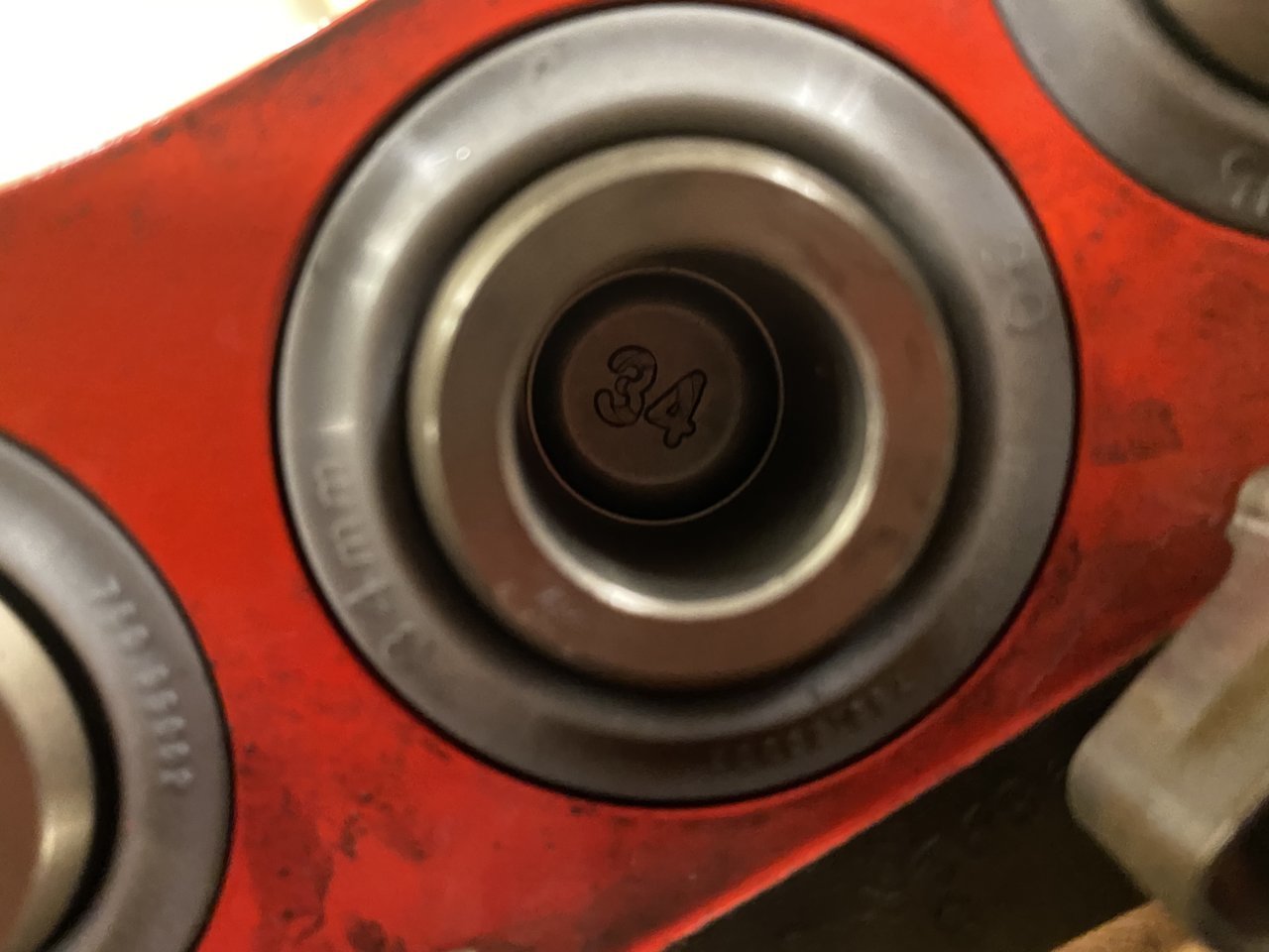

    The piston measurements of the ST60 calipers were imprinted on the pistons; 36mm, 34mm, 34mm.
    The StopTech Sport pads are light years better than the StopTech Street pads, even before proper bed in.

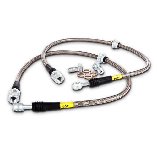

    StopTech is solid too. Running the StopTech BBK, you cannot use the OEM lines and have to use the StopTech stainless lines.
