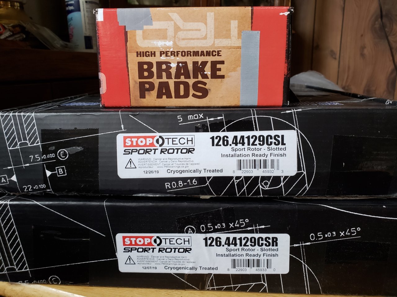

    Just got these in. Waiting on the lines.

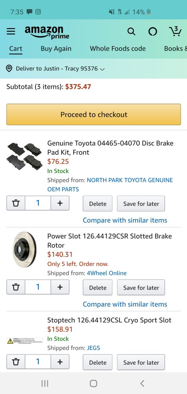

    These are the part numbers and price I'm going with.

    wonder why the left one is more, or why you cant get them in a set

    I had to ores mine independently from different sellers for different prices as well. If on Amazon I think it is just subject to who has it in stock for the lowest price.
