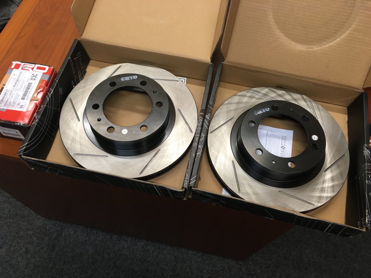

    I ordered and received the StopTech Sport Cryo rotors. Both weighed around 18lbs (one a few oz over, the other a few under). This is essentially the same as the OE rotors' weight as listed in OP's first post.
    So it doesn't seem like I'll gain any heat management benefits through increased mass with these...
