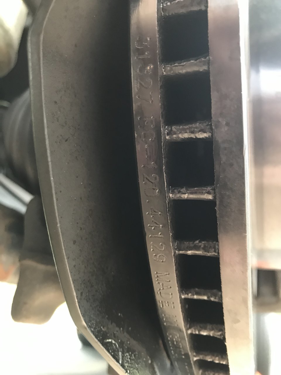

  12. Jul 25, 2020 at 5:08 AM
    #752
    JMM7171
    JMM7171 Well-Known Member
    Jul 29, 2017
    #225370
    64
    Jamie
    CT
    2017 Taco Limited
    TRD exhaust, TRD air filter, TRD OR/Sport grille, BD Squadron Sport combos/fog, Morimoto 2Stroke Hi/low, Baja Suspension Kit with TRD PRO leaf springs and Icon aal, HPS intake w/ Intake Flow Accelerator.

  14. Jul 25, 2020 at 12:28 PM
    #754
    matt2491
    matt2491 Well-Known Member
    Jul 28, 2015
    #160513
    116
    Massachusetts
    2015 TRD Off-Road Supercharged
    Thanks for taking the time to snap that pic, JMM7171.
    Yea, based on all our findings, I'm thinking I'm gonna return these 'Sport' rotors and just order the Ultra Premium blank rotors (but with cryo treatment) at half the price.
    I think we've discovered that the Sport rotors are nothing more than Ultra Premiums with slots and/or holes cut into them.
  15. Jul 25, 2020 at 12:47 PM
    #755
    crashnburn80
    crashnburn80 [OP] Vehicle Design Engineer
    Jun 6, 2015
    #156893
    14,752
    Kirkland, WA
    2003 DCSB TRD OR
    That is disappointing if that is the case, which it now appears to be. Be sure to measure the cooling fins again on the new ones, though I expect them to be the same.
