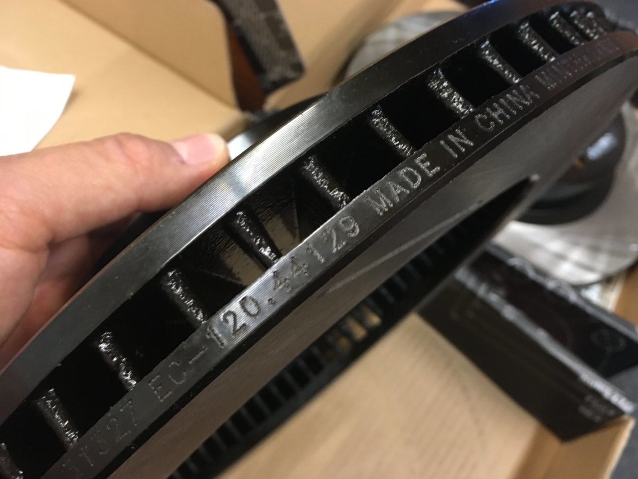

    FYI stoptech stated that the 120 is what they make the slotted rotors from. In an email I received from them today

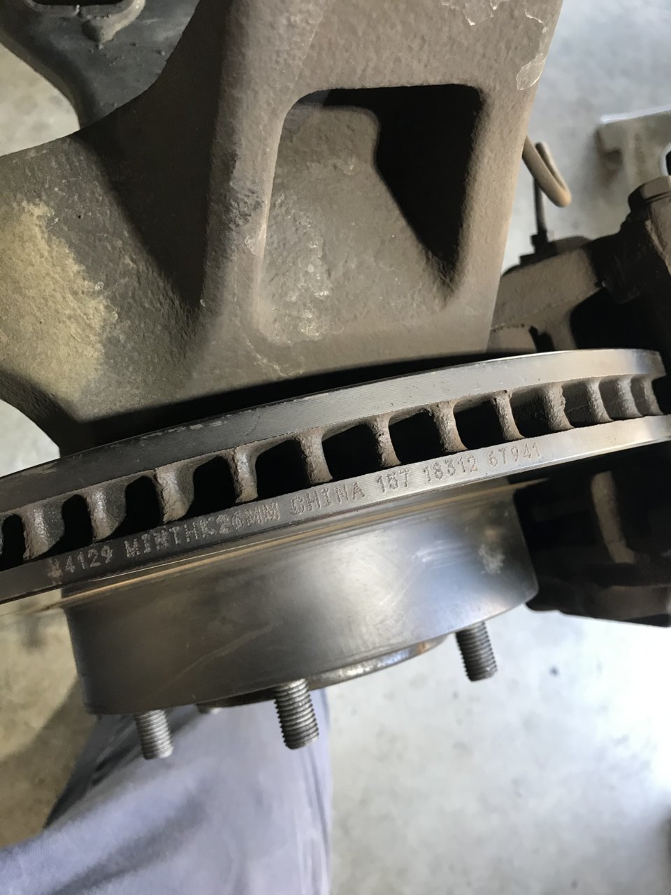

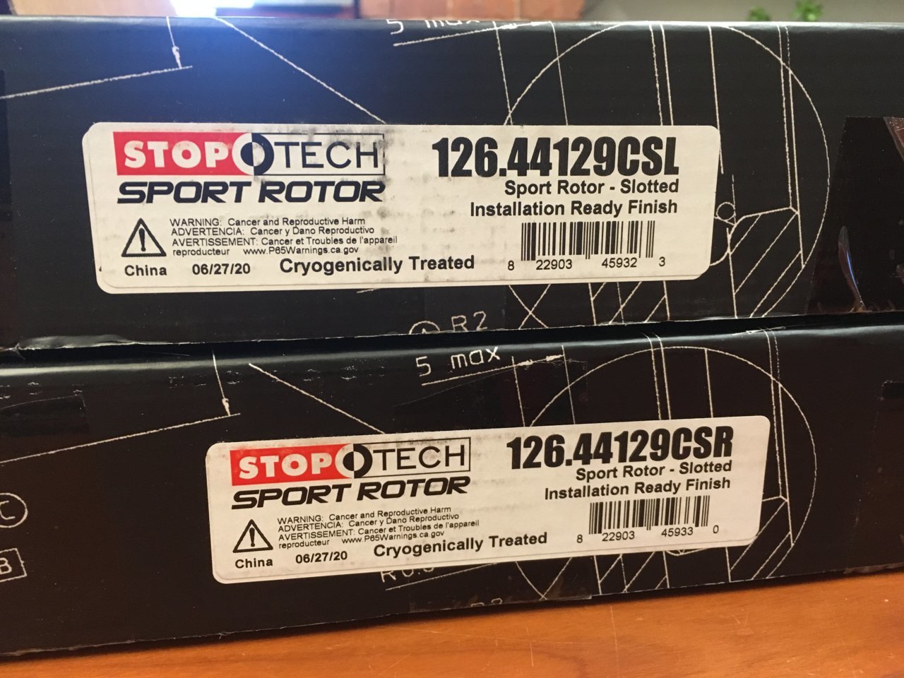

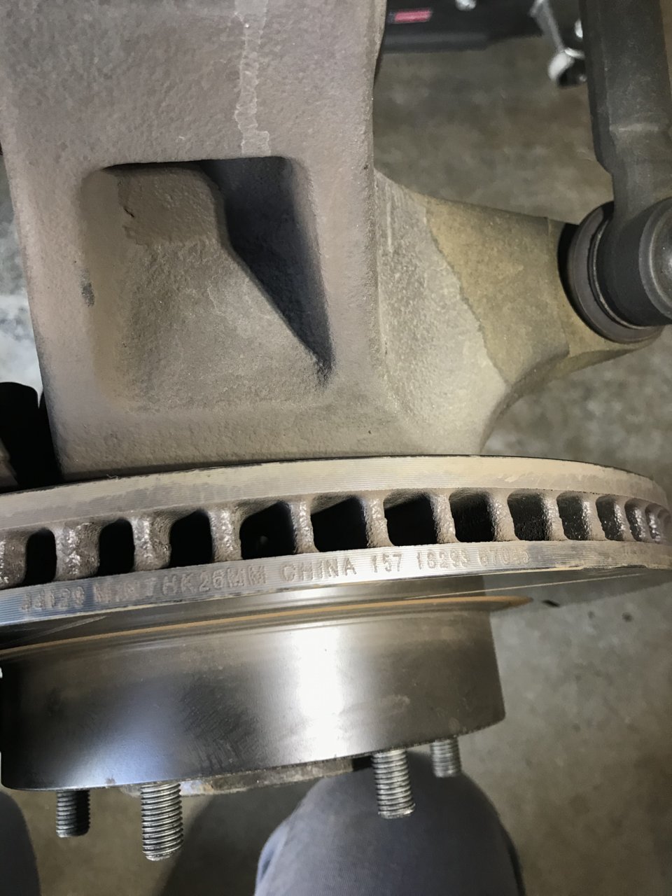

    @crashnburn80 what do you make of these numbers on my rotors? DD7C5CDB-20D5-465E-B947-9860414F6263.jpgFA4AF8EB-4EAA-4998-BF2F-73F5068484DF.jpgE4FBF2D6-6250-4972-B998-89C644AF3245.jpg

    Man I have no idea. Those are StopTech and not one of their other brands?

    Yeah they are stop tech. I bought them off of auto anything and they came in all the proper packaging that the cyros are suppose to come in. So they are the cyros sport rotors then? Just to clarify. Those were there only imprintings on the rotors themselves. @crashnburn80

    I'm not sure what to make of the numbers, the Cryos have the white painted Cryo make on the rotor hat, or at least they did when I got mine. Your spacing indicates you have the performance rotors, just the 'updated' ones with thinner veins and stock weight.
