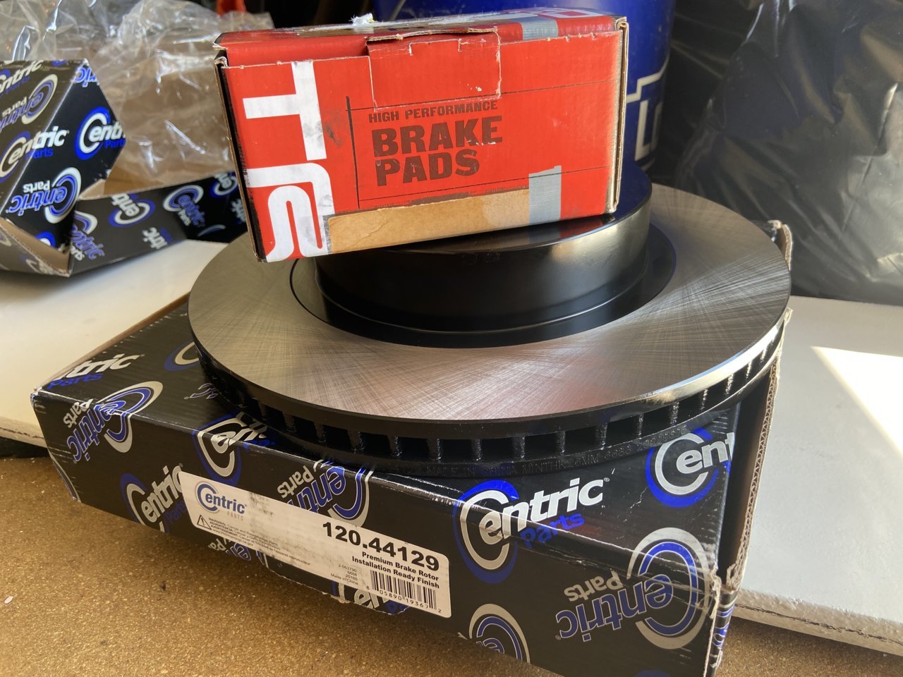

  18. Mar 9, 2021 at 12:55 PM
    #838
    Jared8907
    Jared8907 txtaco07
    Feb 1, 2017
    #209347
    478
    Texas
    2015 DCLB 4x4
    Weathertechs Tint Led Interior Method NV TRD Pro Bilstein Suspension Icon AAL CaliRaised sliders
    I ordered the Centrics off Amazon. Part number in pic. Rock Auto has them for a few dollars cheaper but Amazon had them to me in 2 days.

  19. Mar 9, 2021 at 12:57 PM
    #839
    moxjr
    moxjr Well-Known Member
    Feb 28, 2018
    #245892
    68
    Houston, TX
    2012 White Tacoma DCSB OR
    ok cool so like $45 vs $135 hmm
  20. Mar 9, 2021 at 1:05 PM
    #840
    Jared8907
    Jared8907 txtaco07
    Feb 1, 2017
    #209347
    478
    Texas
    2015 DCLB 4x4
    Exactly. I’m not sure if slotted rotors (stop tech) can be turned either, someone else can chime in on that. Since centrics are so cheap I’d rather just replace them every pad change which for me is about 60k. Hard to justify the cost difference tbh.
