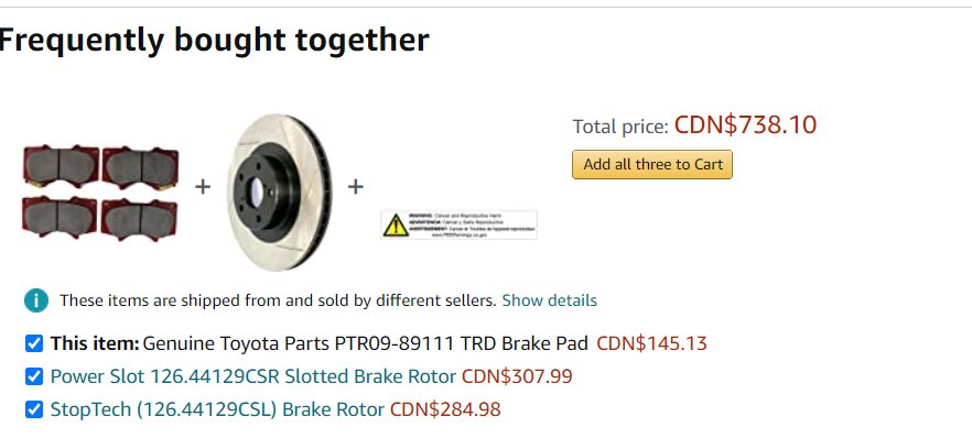

  13. Apr 7, 2021 at 10:12 PM
    #853
    tbraumb11
    tbraumb11 Well-Known Member
    Nov 13, 2019
    #310580
    310
    nanaimo
    2015 tacoma double cab magnetic grey
    what are those?
    stoptech.jpgman these are expensive up here in canada....
    crashnburn80[OP] likes this.

  15. Apr 7, 2021 at 11:18 PM
    #855
    tbraumb11
    Nov 13, 2019
    #310580
    310
    nanaimo
    what are those?
    wonder if I could get away with just doing the TRD pads and getting rotors turned... my truck only has 70,000 KM (not miles) on it but my wear indicators touch when I press the breaks. I don't know what the original owner did with the truck.... I carry a fair bit of weight though...2 x 12 foot kayaks, prinsu, kb voodoo bars, tent and skids with E rated tires and did a lot of city driving over last few years. I could wait until boarder finally opens and order rotors to there for much cheaper and go pick them up for way less... that is if the boarder ever opens...
    Round the world likes this.

  20. Apr 8, 2021 at 4:20 PM
    #860
    tbraumb11
    Nov 13, 2019
    #310580
    310
    nanaimo
    what are those?
    we will see how this goes... i went with the non cryo ones I couldent justify the extra $250 for cryo... will let you know how it goes.
