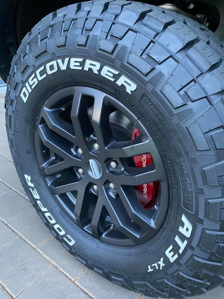

    Here's a photo from the Powerbrake FP page showing a Ranger with my same size tire, 285/70/R17's, on what look like stock wheels (not sure if there's a spacer though). Strange enough, my 17" wheels were on a Ford Ranger at SEMA before I purchased them. :notsure: (I understand I'm splitting hairs and comparing apples to oranges :laugh:)

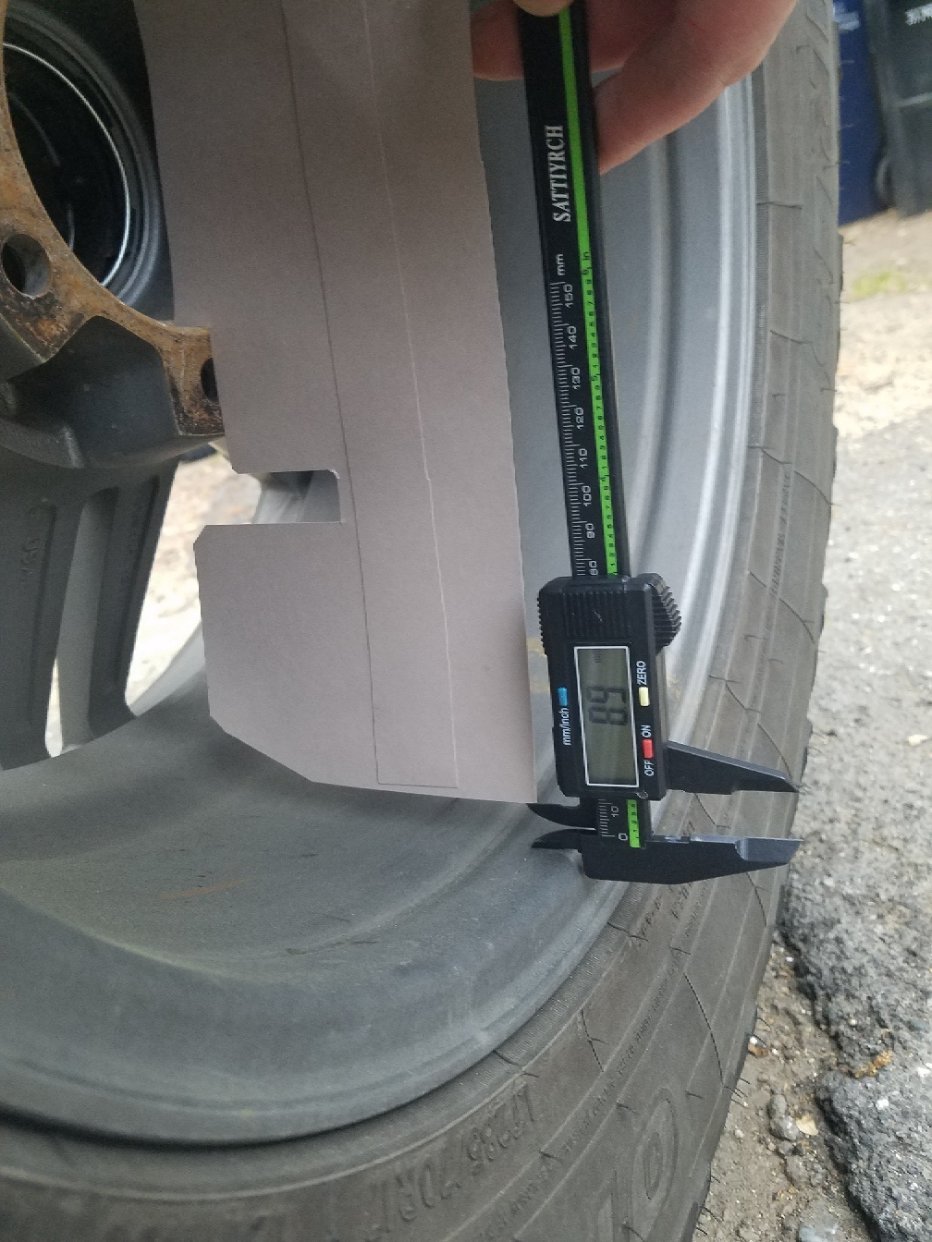

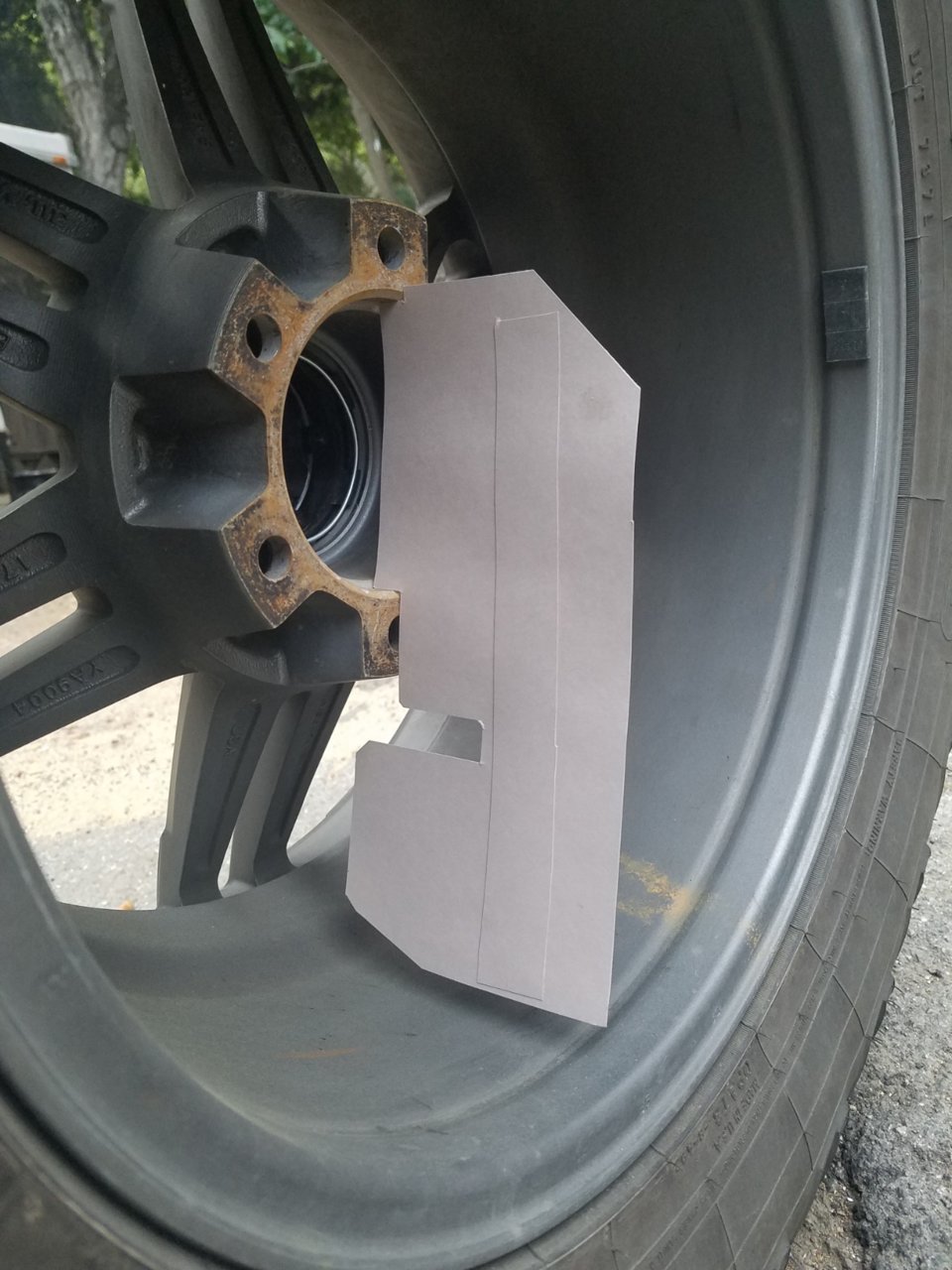

    Attached is the Powerbrake X-1 template if anyone wants to check fitment. Note: the "stock wheel register" part goes into the hub void in the wheel. Print actual size on landscape. Paste onto cardboard (or print on card stock) and cutout. I'll report back with my findings on Venomrex 17's.
    From the rep:
    our brake kits fit under most 17 wheels incl the OE which are often the most difficult.

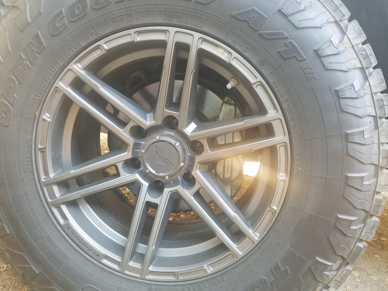

    It looks like it's going to work! 350MM Big Brake Kit on Venomrex 17's.

    Looking forward to the install results. If you can fit 350mm rotors with directional cooling in a 17" wheel, that would potentially be the highest performance setup available without going to 18s.

    Here's the official word from Powerbrakes:
    ...the Venomrex 17” wheels, I would say we have more than sufficient clearance for the Powerbrake S1 kit.

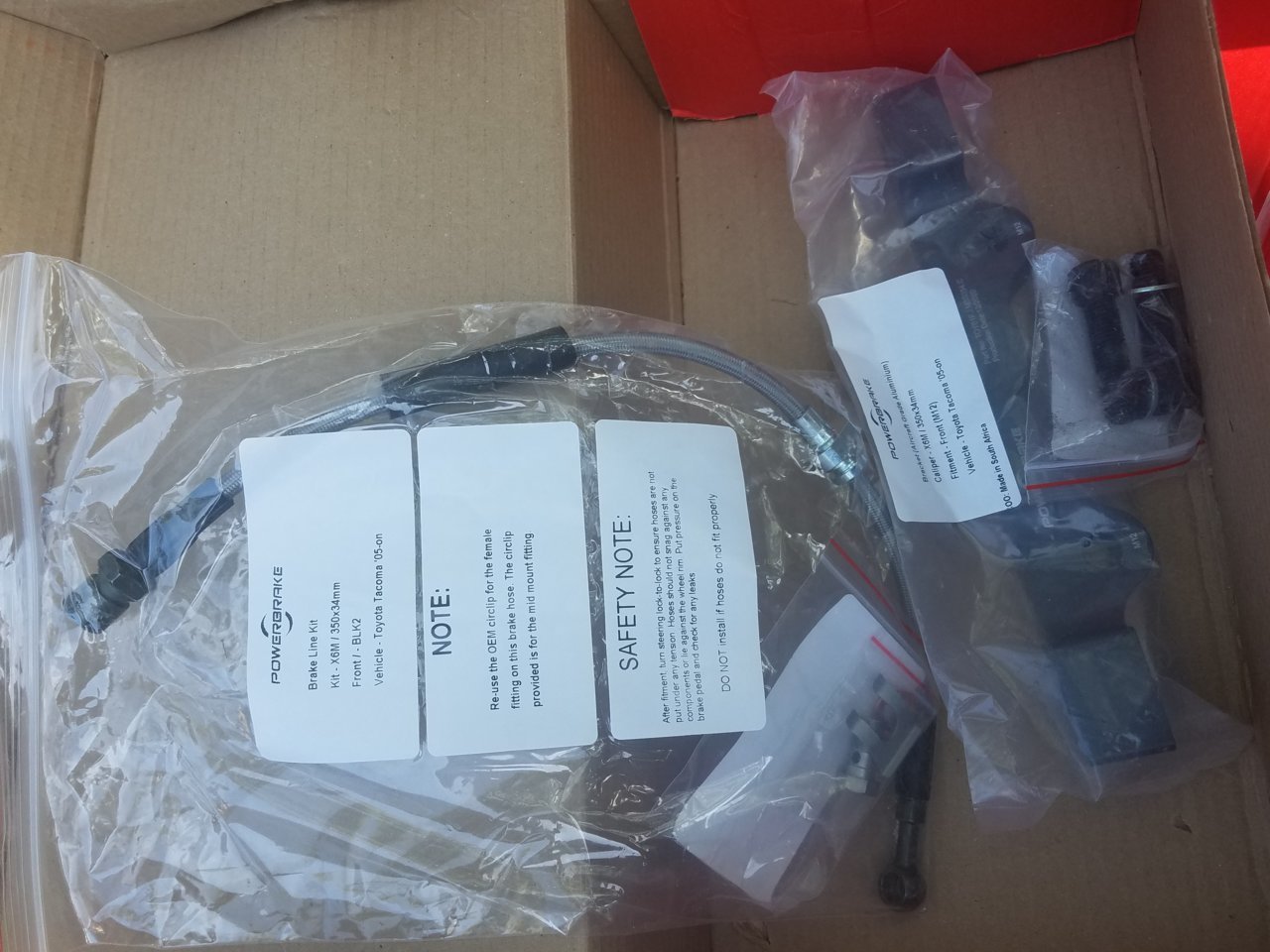

    Also, Powerbrake supplied the stainless braided front lines with the kit, and I purchased rear lines from Wheelers. I'm going with Motul 5.1 fluid.
