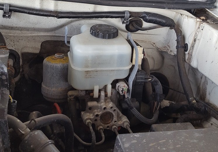

    That is the electronic brake actuator found ATRAC equipped trucks (OR and Pro), it doesn't use a a traditional vacuum system with a booster like the Sequoia system. So no, the Sequoia upgrade will not work with that setup. You need a Tacoma with a vacuum boosted brake system for the Sequoia upgrade.

    Thanks for the info! Guess I have a 2009-21 SOS Sequoia upgrade kit available for purchase. New in box, just been hiding in storage for years. $250 shipped obo. Will probably make a few other posts on it in the proper forums

    my next question would be, with ATRAC being there, is there even any need for an upgrade when installing the rear disk conversion?

    Likely yes. Rear discs use more fluid volume than the stock drums. People report excessive pedal travel (due to needing to move more fluid) without upgrading the MC after going to rear discs. I think the right fix would be using the electronic actuator from an ATRAC equipped 4runner that has rear discs stock, but that would be pricey and I haven't seen anyone that has done it. The part is more expensive than the rear disc swap, and at that point I don't see it as being worth while.

    lol, dang....I may have a whole kit for sale then. It was more of a *want project than a *need, but would've been nice to have matching rear disc's since I've already done the front.

    The rear discs should work, but the brake feel and pedal travel will not be like stock, and not in a good way.
