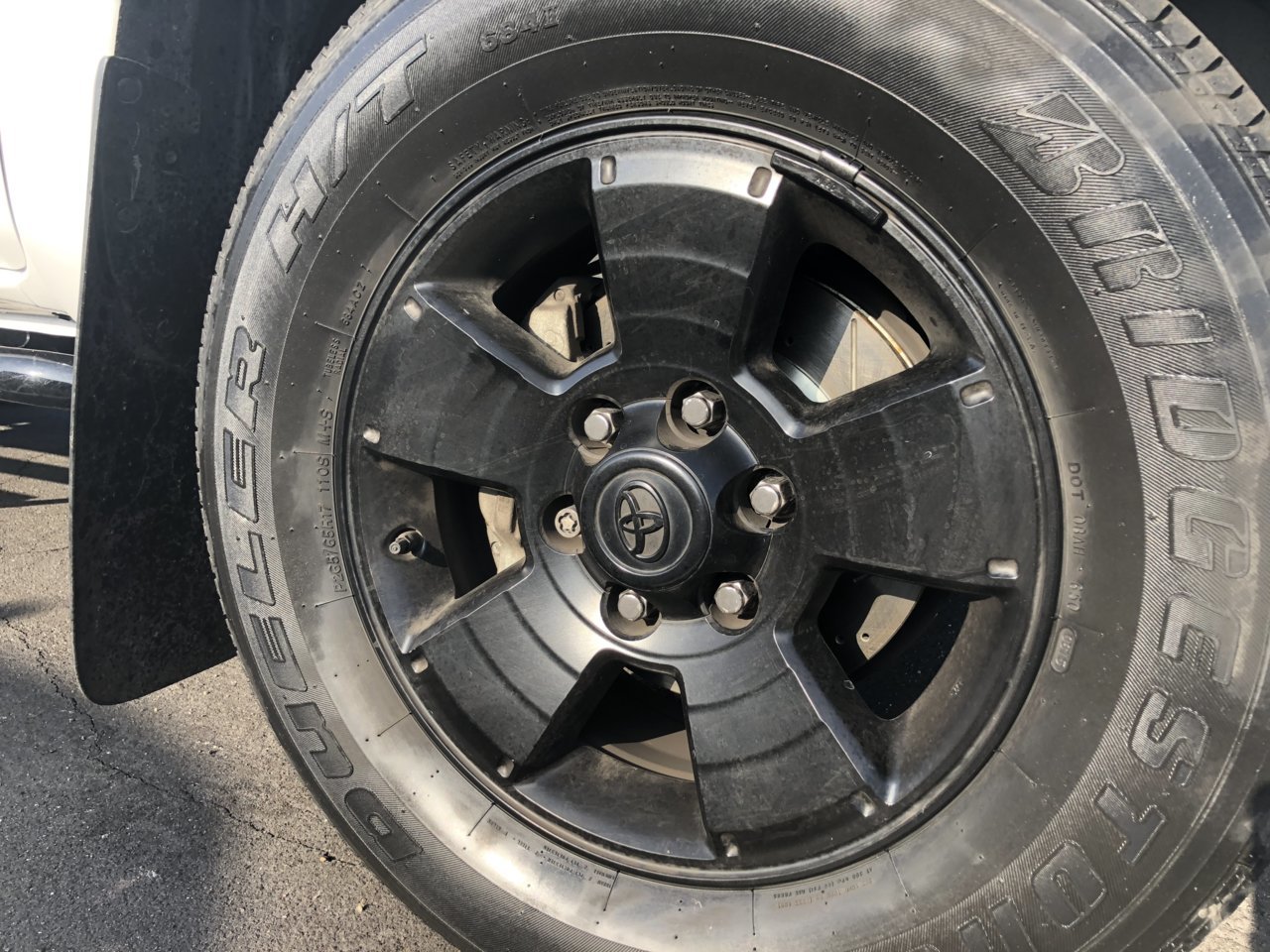

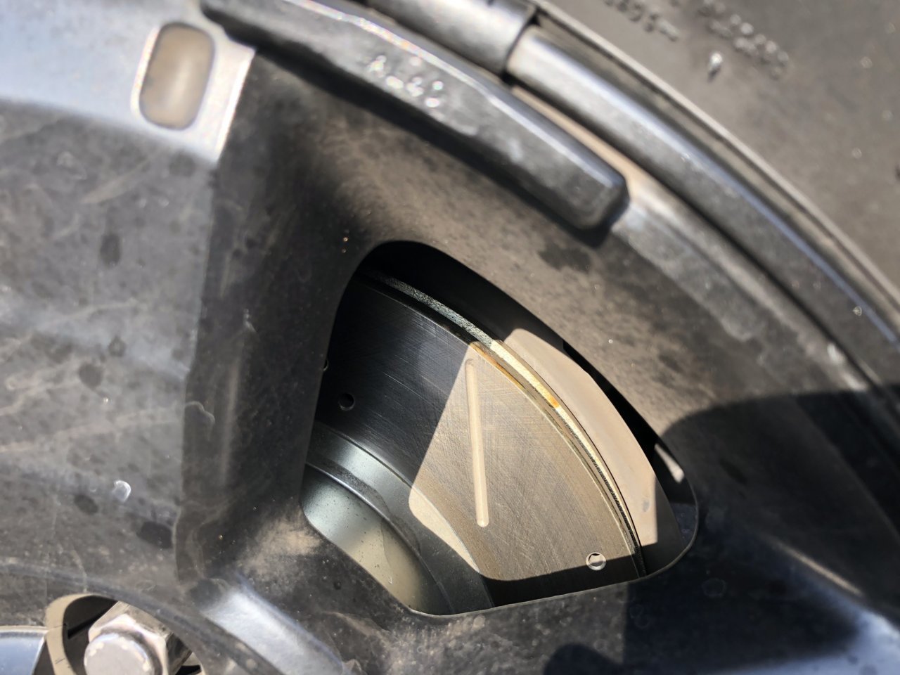

    Upgraded my truck with some stoptech rotors, drilled and slotted, and pads.
    Pics of them at the Dodger Stadium Spartan Stadium run today!
    Hope they last a while :fingerscrossed:
