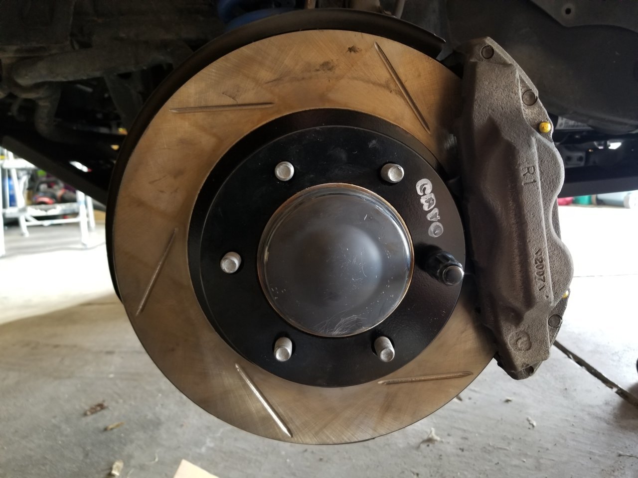

    Do you happen to have a part number on those puppies?

    Why are the 2 rotors from different brands. Stoptech and powerslot?

    Stoptech Rotors: 126.44129CSL and 126.44129CSR
    Powerstop Pads: Z36-976
