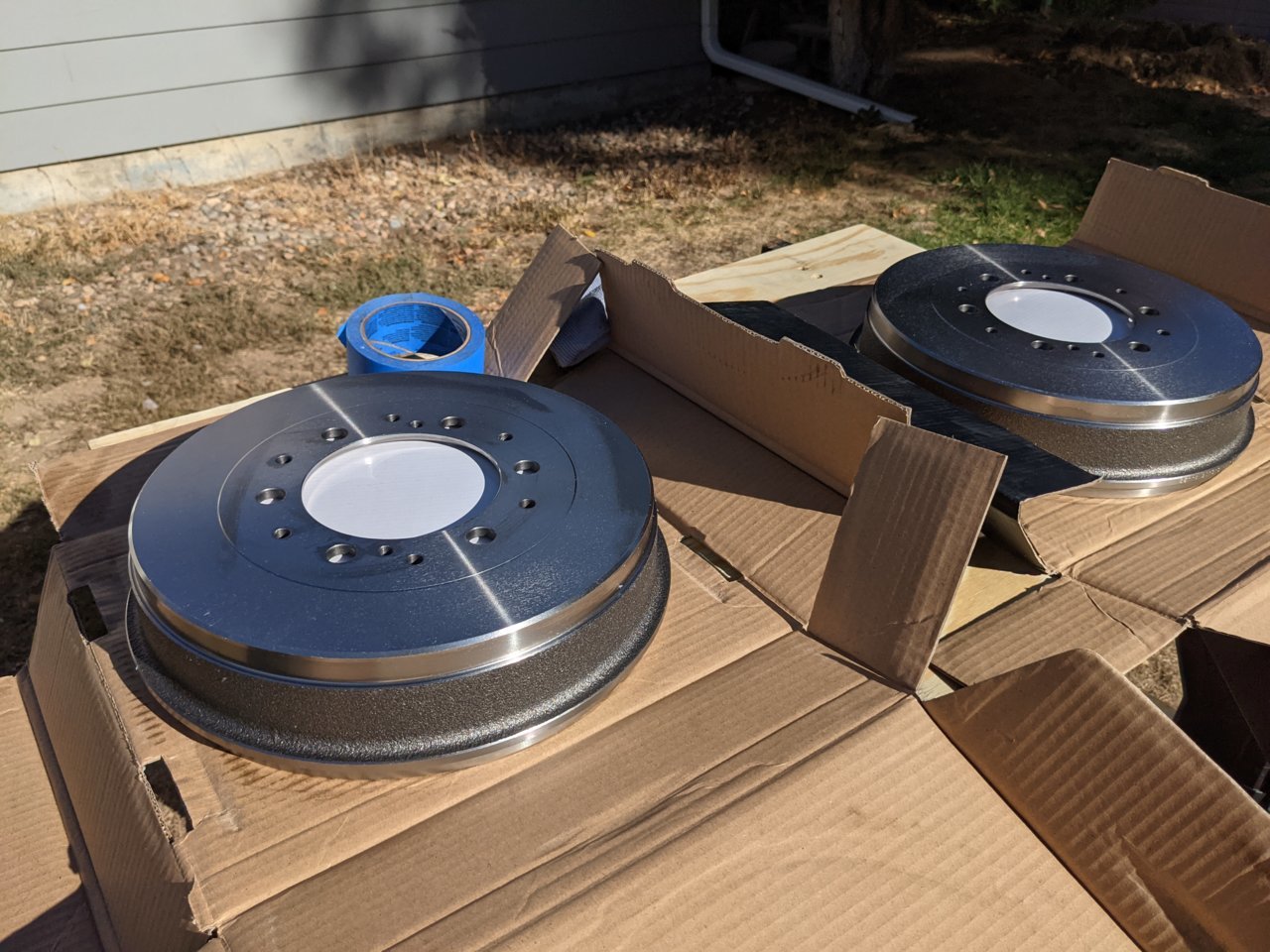

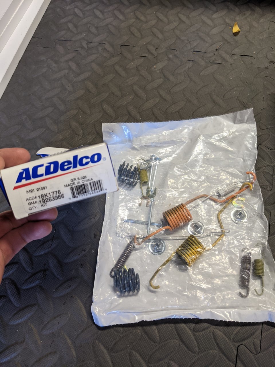

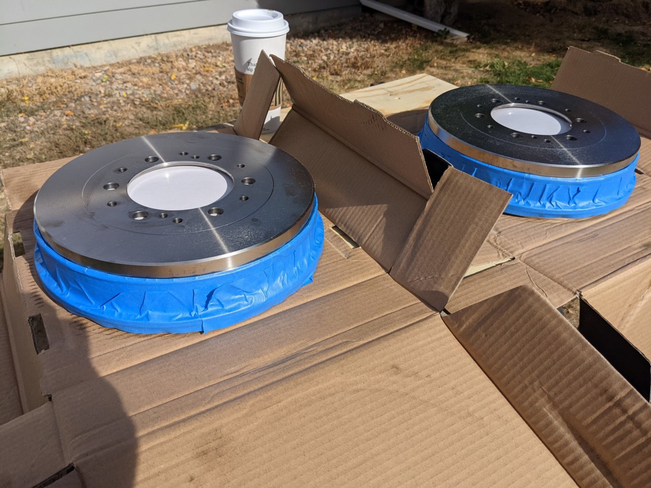

    Rebuilding rear drums. Will post progress here. Bought a set of TRQ drums and pads, also a set Beefed Up brake pads to compare, and an ac Delco hardware kit. Painting the drums red to match the front stoptech 6 piston calipers.

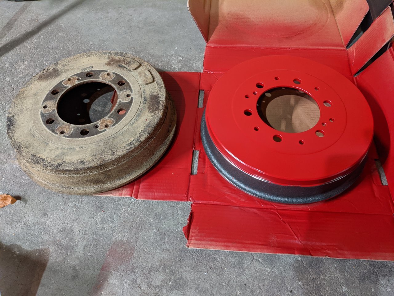

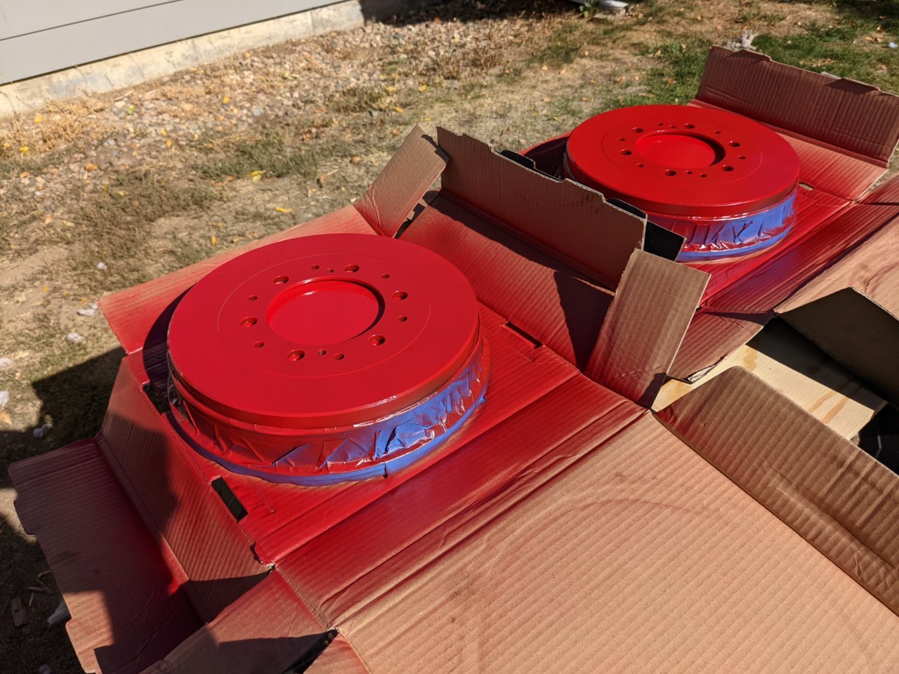

    Got a few coats in on the first pass before the can ran dry, used most it it previously on the valve covers. Gonna sand a little, buy a new can, and respray tomorrow. Planning on installing next weekend

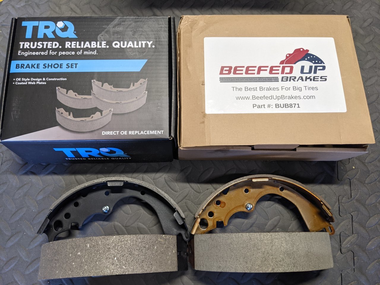

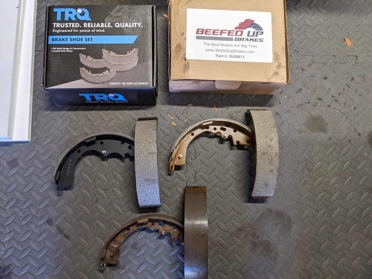

    OE vs Beefed Up Brakes

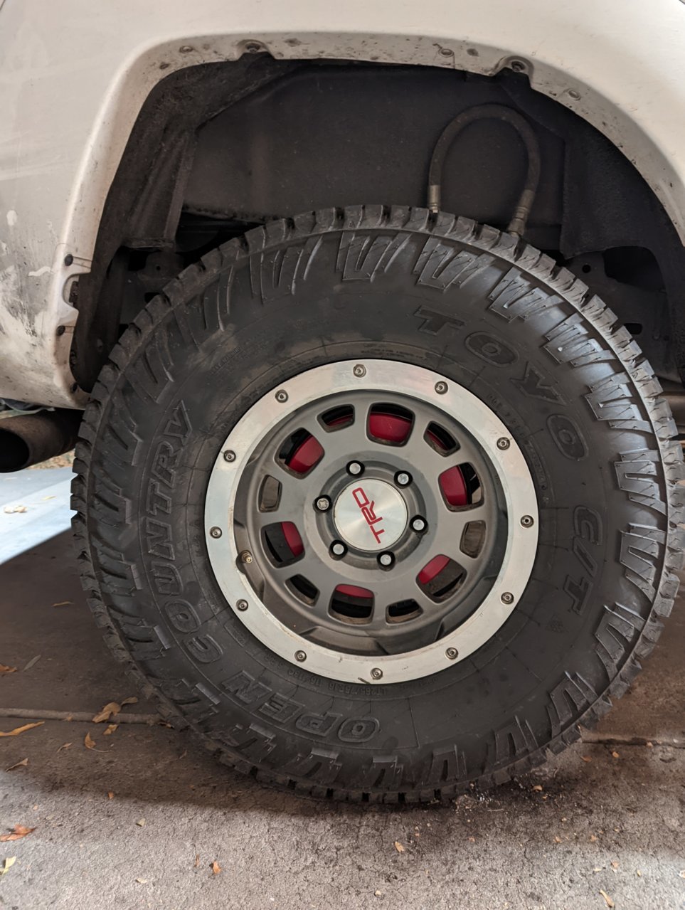

  12. Oct 30, 2021 at 11:21 AM

    Curious to know how that krypton holds up with the heat compared to high temp brake caliper paint, but I like the red. I've used rustoleums high temp black bbq paint on a 2 stroke dirt bike header, so I know that would work, but it only comes in black.

    I used the same stuff on my valve covers mid summer and still holding up fine. Did multiple coats over several days on the drums

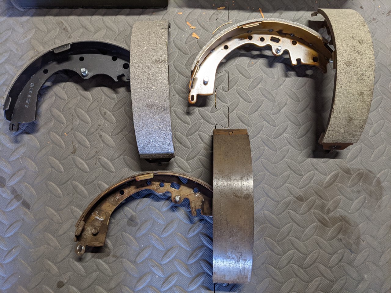

    Hmmm, Beefed up Brakes looks exactly like oe, and the TRQ oe brakes look premium.... probably gonna put on the TRQ brakes.

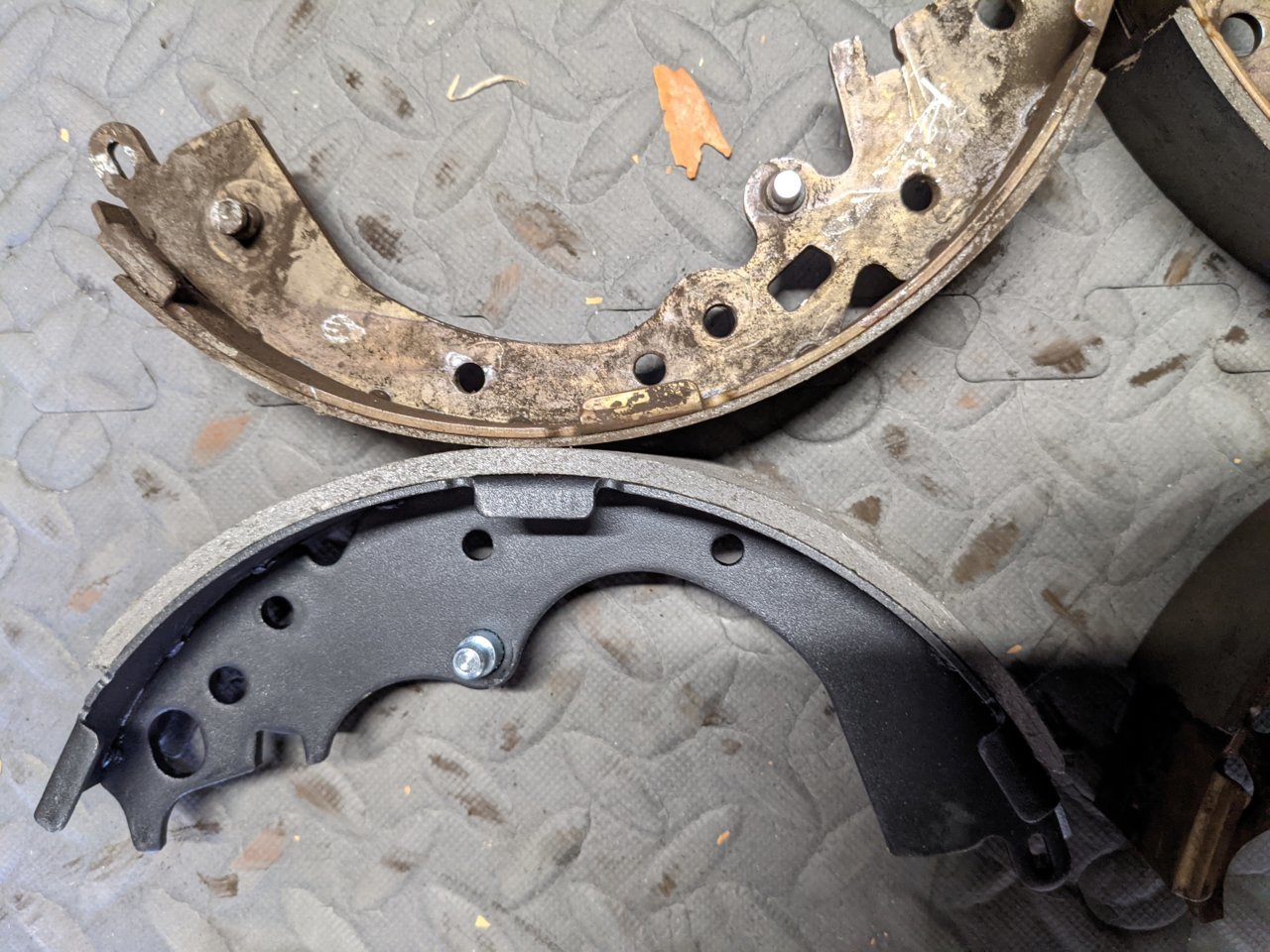

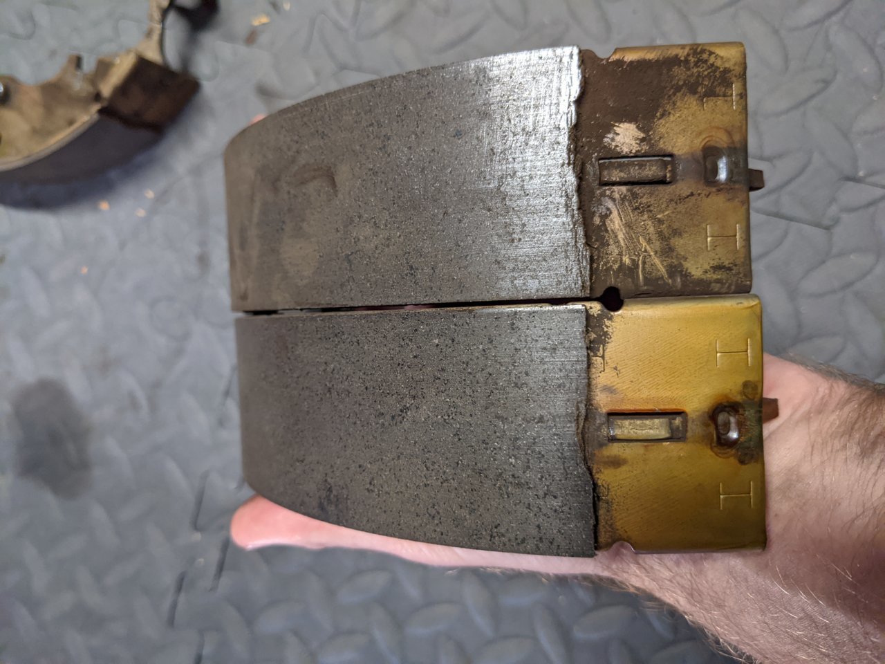

    Up close damage of of drum pads, and thickness comparison to new pads
    86k miles on old pads

    Drum brakes are a pia! But the rears now match the front!
