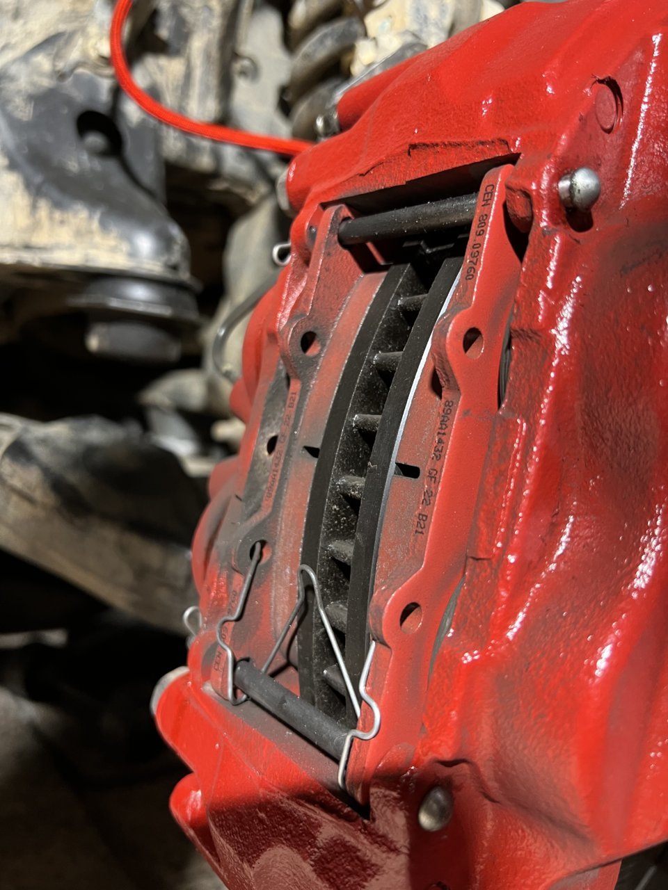

    Just a word of warning, I don’t know what the deal is with these StopTech rotors but they are a little undersized compared to stock. The pads are riding all the way to the very outside edge, even past the chamfered edge of the rotor. I would say for the headache these have caused they aren’t worth it anymore after going to cheaper Chinese manufacturing. It’s probably better to spend your money on a different option. Unless I’m unlucky and no one else has had this issue :bananadead:1A01317F-9FD0-4793-A00C-4224829BA00E.jpgFCC40BC9-EE37-45D5-AC63-6CB318CCF600.jpg
