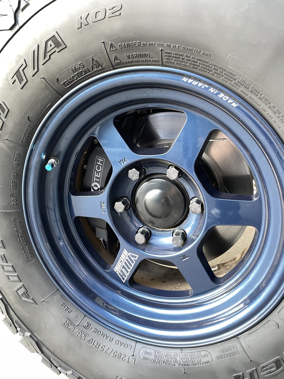

    Finally got around to install. 16 inch wheel kit with stoptech slotted rotors.
  18. Dec 21, 2022 at 3:03 PM
    #1138
    crashnburn80
    crashnburn80 [OP] Vehicle Design Engineer
    Jun 6, 2015
    #156893
    14,772
    Kirkland, WA
    2003 DCSB TRD OR
    Nice! That is a lot of fanciness riding on those hubs!
