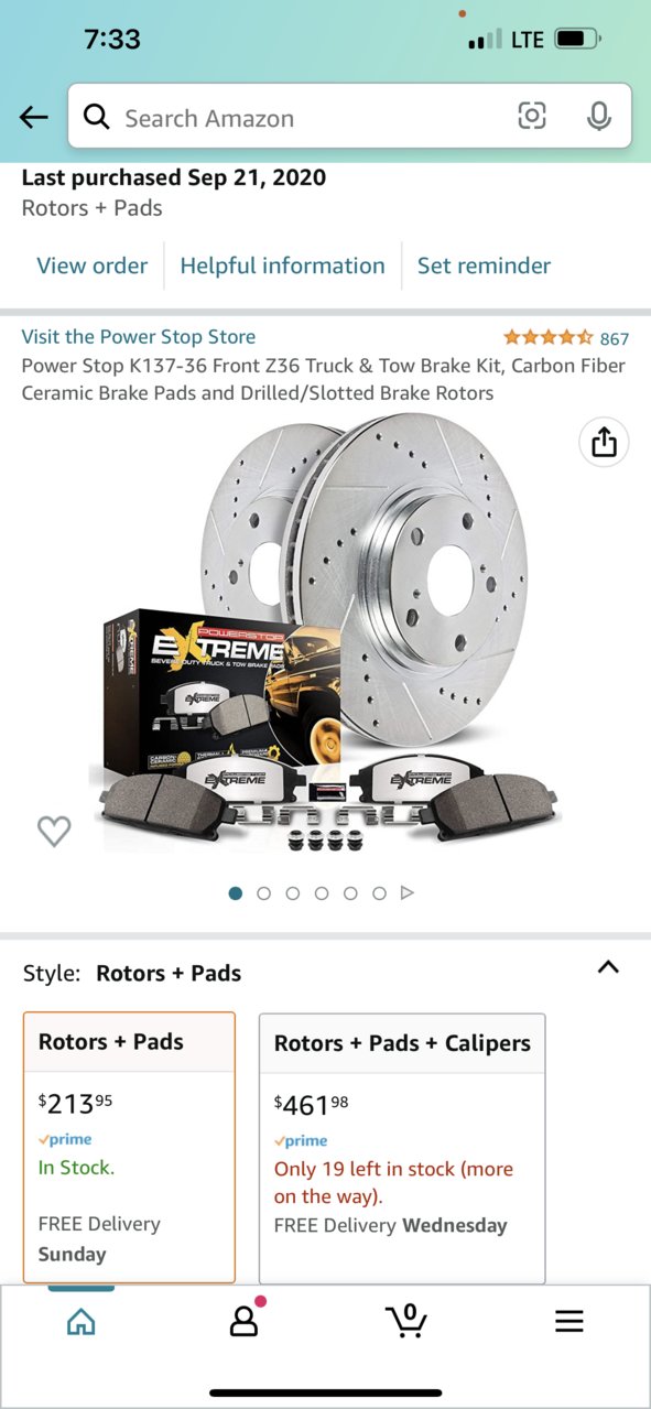

    Is everybody enjoying this brake upgrade? Any adjustments or regrets @crashnburn80 on your selections? I changed brake rotors and pads October of 2020 and went with power stop rotors and pads k37 z36 tow and haul kit I believe it was… I’ve been less than impressed with them since installing. Been getting vibrations while braking for the last couple months and I’m positive it’s warped rotors. I did the 60-0 break ins after install without completely stopping. Maybe I messed it up bc they’ve been horrible since install tbh.
    I’d like to make a better selection this time without going full big brake kit and I’ll be changing rears as well

    The power stops I put on about 40,000 miles ago were z36 tow and haul kit with carbon fiber and ceramic. Rotors came drilled and slotted. I’m definitely going with trd pads this time. Which Toyota rotors did you end up recommending if stuck with oem? The Tacoma or 4 runner?FF988D29-5E40-404A-B3DE-B115E4D65384.jpg here is the exact kit I installed October 2020

    I can't comment on how the pads compare. The TRD/ST Sports do tend to put off some dust. Drilled rotors are not an upgrade. You are removing material from the rotor that reduces the thermal mass and introducing stress points that can lead to cracking. No tow rotor should be stock size and drilled. The StopTech rotors have increased internal vein count over stock, giving improved cooling over stock, resulting in lower braking temps.

    Yeah these brakes have been horrible for my truck. Now I know the pads are about toast so I’m replacing whole system again once and for all hopefully. They advertise it as tow and haul kit and it comes with drilled and slotted. I honestly should’ve known better
