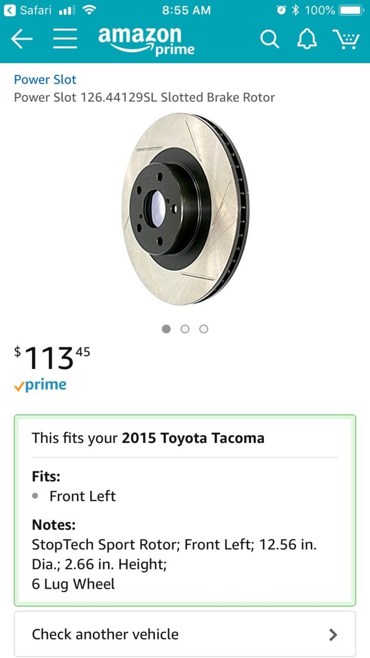

  9. Jul 7, 2018 at 7:16 PM
    #109
    BenMara
    BenMara That Asian RedNeck
    Apr 14, 2011
    #54903
    1,951
    Ben
    Belton, SC
    2011 DC 4x4 SCed
    TRD Blower, Ham Radio, DBA T2 Rotors
    Only finding the Right side rotor on Amazon, havent see the Left at all in 6 months thats ive been searching
    Does anyone have sources for these rotors?
  10. Jul 7, 2018 at 9:02 PM
    #110
    crashnburn80
    crashnburn80 [OP] Vehicle Design Engineer
    Jun 6, 2015
    #156893
    14,772
    Kirkland, WA
    2003 DCSB TRD OR
    Shop by googling the part number, makes finding exactly what you are looking for much easier.
    https://www.summitracing.com/parts/sph-126-44129csl
    Norton and BenMara[QUOTED] like this.
  11. Jul 7, 2018 at 9:10 PM
    #111
    BenMara
    Apr 14, 2011
    #54903
    1,951
    Ben
    Belton, SC
    2011 DC 4x4 SCed
    Thank You Sir
    Is SPH-126-44136SL just a non Cryoed version?
  12. Jul 7, 2018 at 9:38 PM
    #112
    crashnburn80
    Jun 6, 2015
    #156893
    14,772
    Kirkland, WA
    2003 DCSB TRD OR

  15. Jul 8, 2018 at 8:42 AM
    #115
    BenMara
    Apr 14, 2011
    #54903
    1,951
    Ben
    Belton, SC
    2011 DC 4x4 SCed
  16. Jul 8, 2018 at 8:58 AM
    #116
    crashnburn80
    Jun 6, 2015
    #156893
    14,772
    Kirkland, WA
    2003 DCSB TRD OR
    Cross check on a different site. Note Amazon shows them as fitting.
    Many of those sites ‘fitment wizards’ may not lift all the models it is applicable to, such as list it under 4runner but not Tacoma.
    BenMara[QUOTED] likes this.
