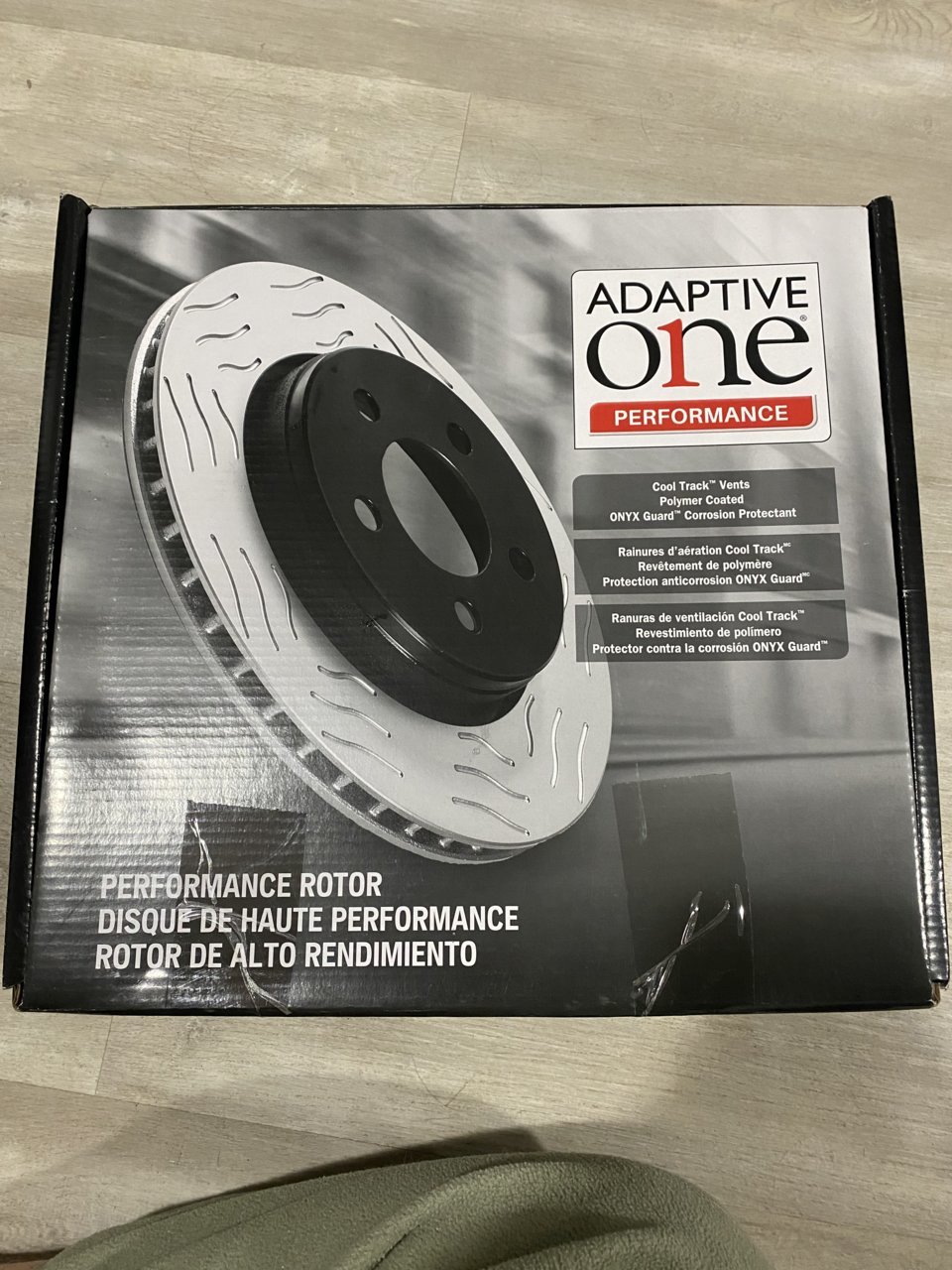

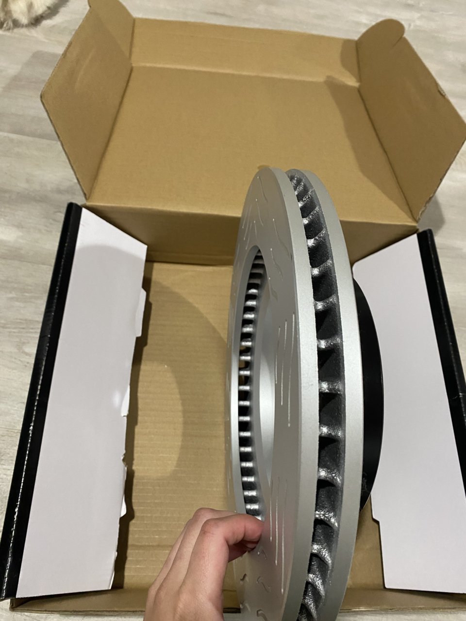

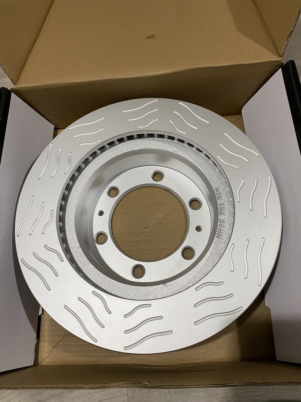

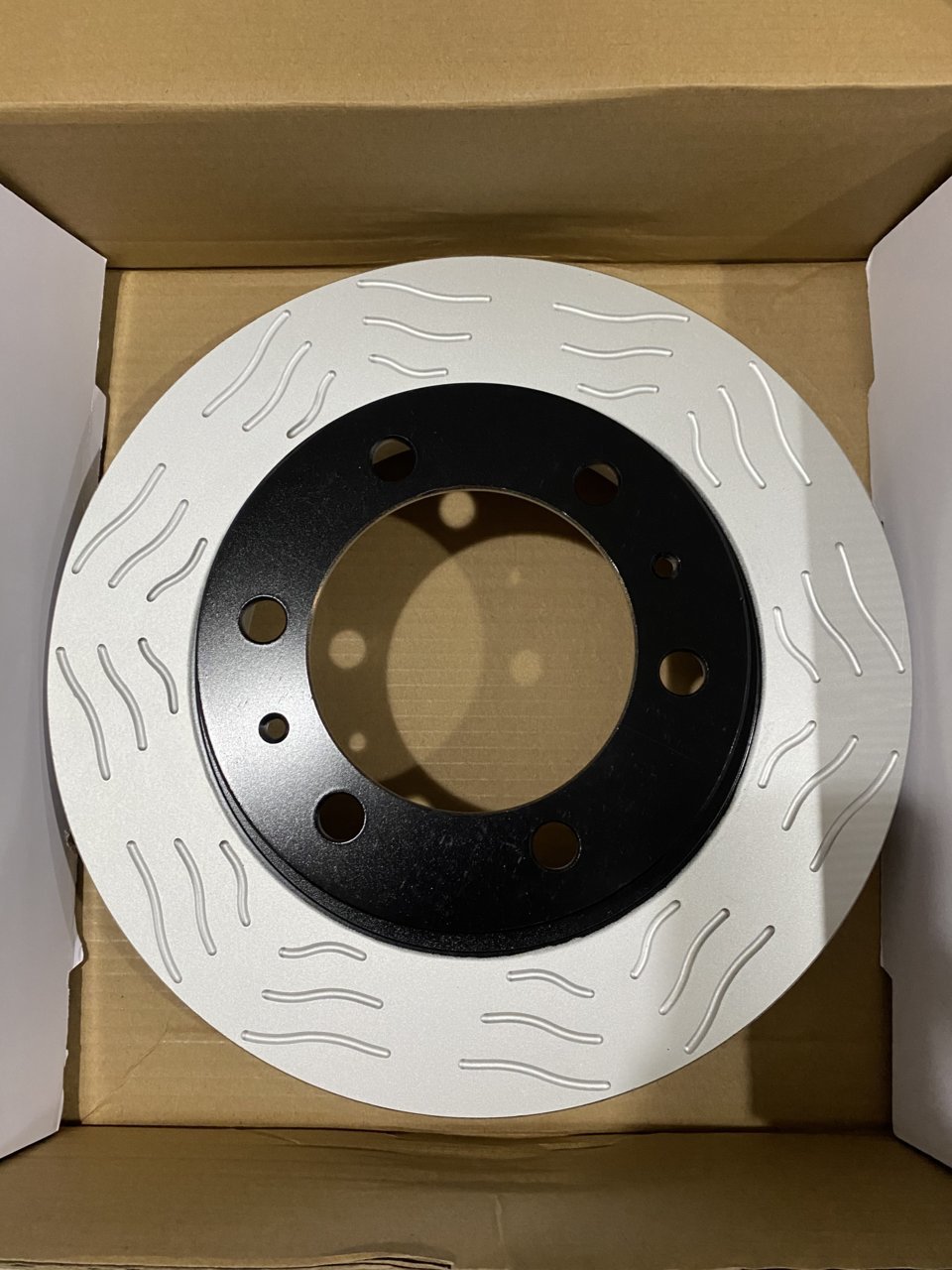

    Hey @crashnburn80 what do you think of these Adaptive One Performance rotors from NAPA? I believe Raybestos makes them. Just picked them up on sale for $124 each. Weight looks to be 22lbs. However, veins are inverted like OEM. Haven’t looked to see if it has more vines yet.
    edit: Onyx coated as well

    I am unfamiliar with those. Based on the reviews on NAPA's site, the slotting looks very shallow, having the rotor turned 0.010 resulted in slotting nearly being eliminated.
    https://www.napaonline.com/en/p/UP_RA880279
    For weight, compare your OEM take offs vs the new units on the same scale. My weight comparisons were accurate between units, but slightly skewed by setting the rotor far enough to the side to capture the measurement in a picture resulting in a slightly lighter than actual measurement. The big gain in the rotors is the internal cooling veins, if you can get some calipers to measure the distance between veins that would tell you if the rotors have more internal cooling surface area or not, which would allow them to better resist brake fade under heavy use.

    I had a feeling you were going to bring this review up lol.
    “Had my brakes recently done and they turned my rotors, this was the first brake job since I did my brakes last time, which was roughly 40k miles ago. After they turned them, 1 rotor lost almost all the "slots" the other is still showing slots. Unfortunately this is considered wear, so I either live with 1 slotted rotor, and 1 non slotted up front. Or buy a new set of rotors. If I have to turn the rears when the brakes are replaced, they will lose all marks as well. The rotors both got turned .010 and are still well above safe limits. Needless to say I wouldn't recommend them to anyone, and won't be getting them again. They look good, but aren't practical after 1 rotor turn”
    He claims it only happen on one of the two rotors? Wouldn’t t that indicate brake PAD failure?

    It would likely indicate grooving on one rotor, where that rotor had to be turned more aggressively to eliminate the grooving. If both rotors were turned .010 then they should look the same, unless the manufacturing tolerances on the slotting depth were very sloppy. Hard to say if these are decent or not. I personally prefer simplistic slots over fancy designs. Their slots also seem shallow. You'd need to measure the vein count to see how it compares to stock, the rotor page offers no information about improved internal vein cooling abilities, just the slot "cool track venting".
