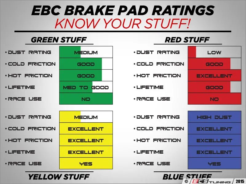

    With the weirdness going on at Stoptech I was curious what other options people have enjoyed? The ones I’ve been eyeing are the Hawk LTS and the EBC Yellows.
    I have run the Hawk HP+ (I know they are not even remotely similar) on my track cars and my track buddy has good things to say about the EBCs.
    Update: I ended up getting the Hawk LTS and have put about 1000 miles on them. Initial bite was mildly increased ~15%. Required brake pedal pressure to decelerate at the same rate on the stock pads was about 25% less. I find the largest benefit to be as you heat the pads and rotors up (i.e. mountains, aggressive driving, towing) the brakes bite and deceleration improves noticeably. I used to have an issue when I would switch between my other cars, including a Miata and 718 Cayman, where I would not brake the truck hard enough initially and would have to add more braking to stop where I expected. With these pads that issue is basically nonexistent. Otherwise, no noticeable increase in brake dust and no brake noise even when cold. Cold morning bite is adequate and have not caused any scary situations.
