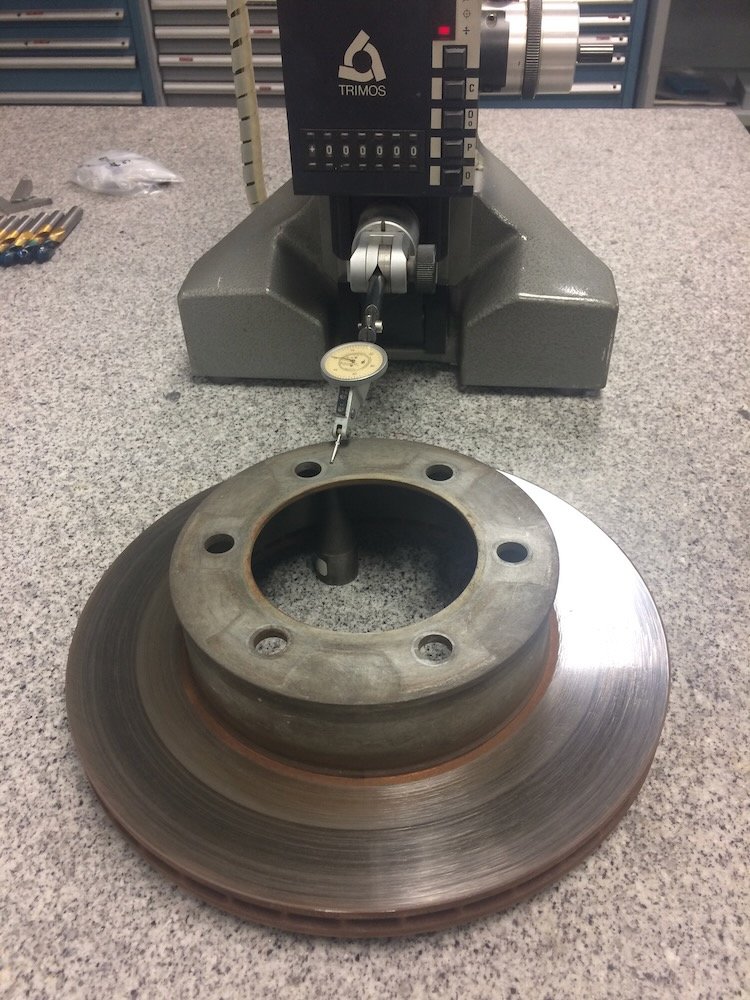

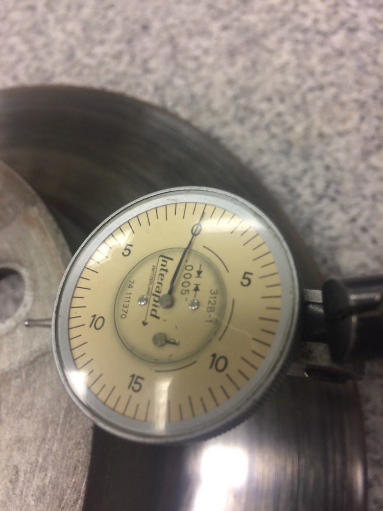

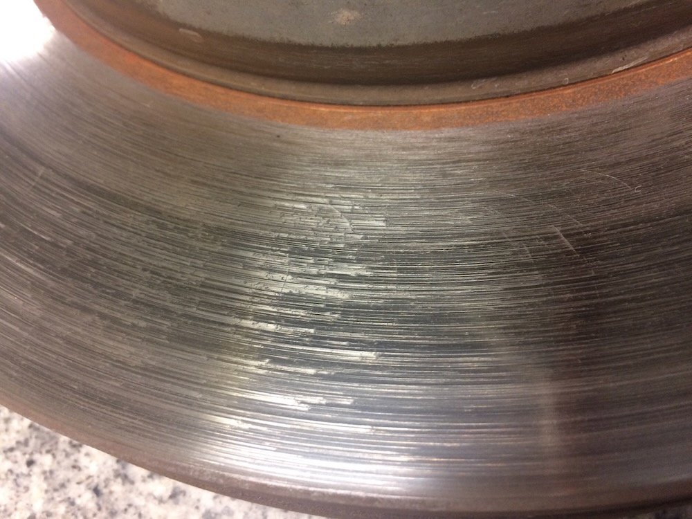

    So much this. Looking at phase diagrams for cast iron, the temps and quench rates necessary to "warp" a rotor are beyond what happens on the street. Now, pad deposition, here's my pics and story from 2017. 2002 Tacoma, camping gear often, tent trailer sometimes. Couldn't believe the "warp" but the pulsating was unmistakable. Took them to work to measure, 3 point on the mating flange, indicator roving around the braking surface. Yes, change in the texture of the braking surface.
    The mating surfaces and the mounting surfaces are planar - within 0.001", but the texture on the braking surface is immediately noticeable. Oh, and the statement about rust holding the rotor to the hub? In Phoenix there isn't enough wet to cause that to happen, they have been loose each time I remove the wheels.

    Not sure what you're measuring in the 2nd pic...that surface is not a good datum. The other side of it is though. When you pulled that rotor off, is the hub mating surface as it looked out of the box? Is the hub surface still nice and clean and shiny? If there's any discoloration, that's from something other than nothing between the hub and the rotor.

    The second pic was showing the equipment, with the 3 point inside the hat. I did check the land next to each of the clamp down areas as a curiosity. They were surprisingly planar. My established datum are the 3 points to the inside and measure against the wear surface. The inside looks very similar to the top you see in the photo. Not shiny, but not rusted either. The rotor has ~90k miles on it and was more of a curiosity of "did they warp?" my bias says no way, or did they have buildup due to a long downhill pulling my tent trailer/then stop and hold at a light causing changes in friction coeff. After seeing the streaks and roughness in the 3rd photo, that convinced me it was a surface finish change not a warp.

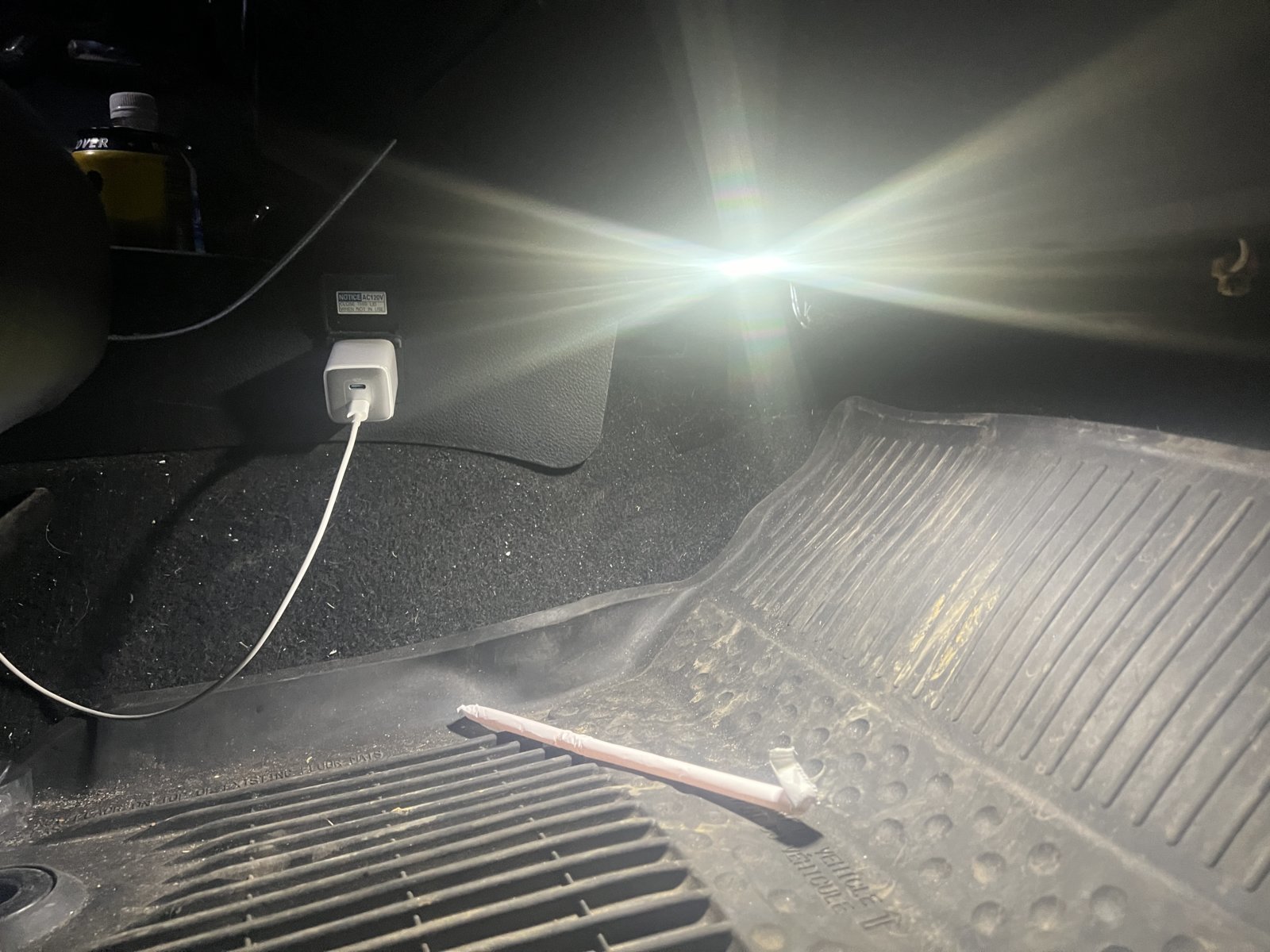

    IMG_7991.jpgInstalled VLEDS footwell kit last week and I’m liking it… very straightforward install probably do the back too when I order the bed kit whenever it’s released!IMG_7989.jpg

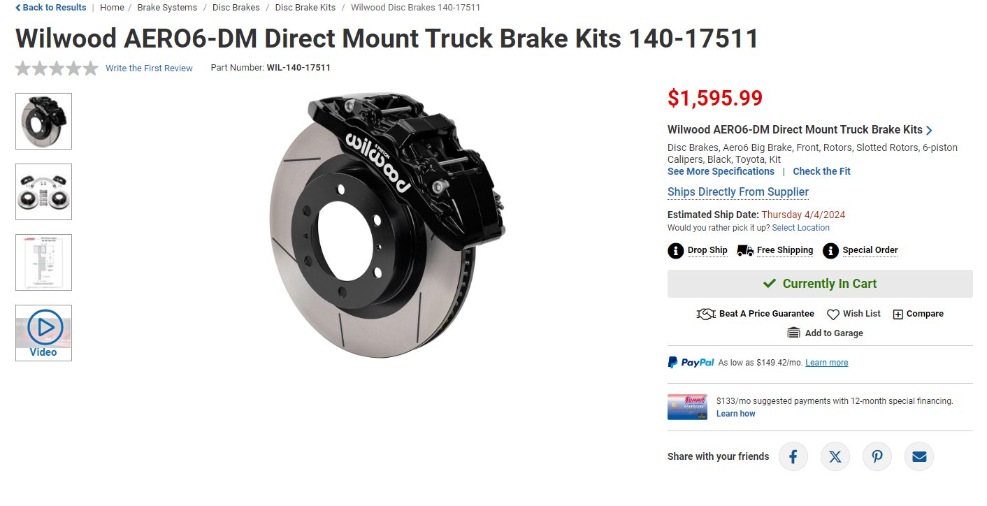

    @JuanitoBonito may have some insight here as well. IIRC, he ran a Wilwood BBK on his Tacoma.

    @BabyBilly yes, I ran the Wilwood kit. Well worth the money, I bought mine on a Black Friday deal. Easy install as well. I just had to ever so slightly bend the dust shield. I also ended up taking them off my second gen when I sold it and put them on my 3rd gen. I’d buy them again for sure. I do not however have any experience with stoptech. I don’t think you’ll ge wrong either way though.

    Hey thank you for the reply. Good to hear you're happy with the Wilwood. If no one else chimes in with a good reason to go with StopTech over Wilwood I'm gonna go with the lower price for sure.
