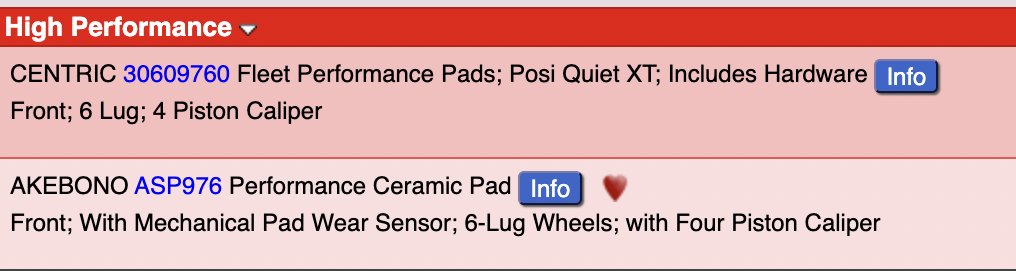

  6. Apr 21, 2024 at 5:16 PM
    #1306
    BenMara
    BenMara That Asian RedNeck
    Apr 14, 2011
    #54903
    1,944
    Ben
    Belton, SC
    2011 DC 4x4 SCed
    TRD Blower, Ham Radio, DBA T2 Rotors
    Ended up with the AKEBONO pads from Rockauto for $50 hope they are worth is.
