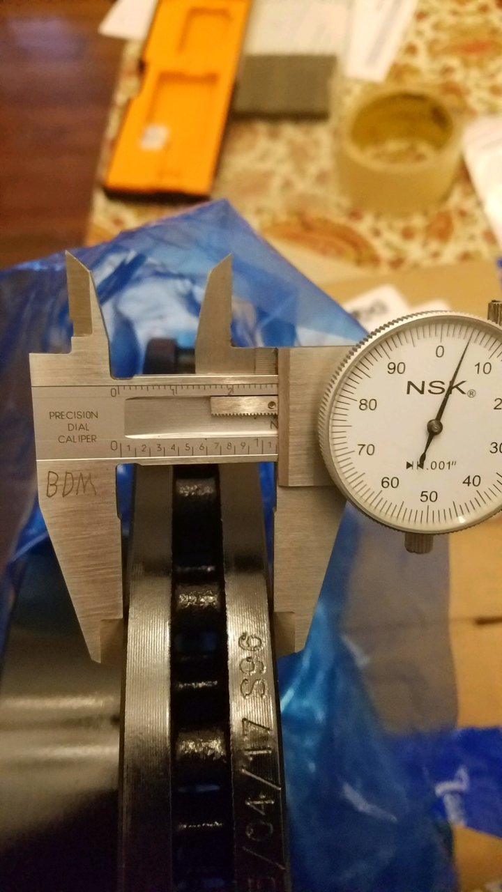

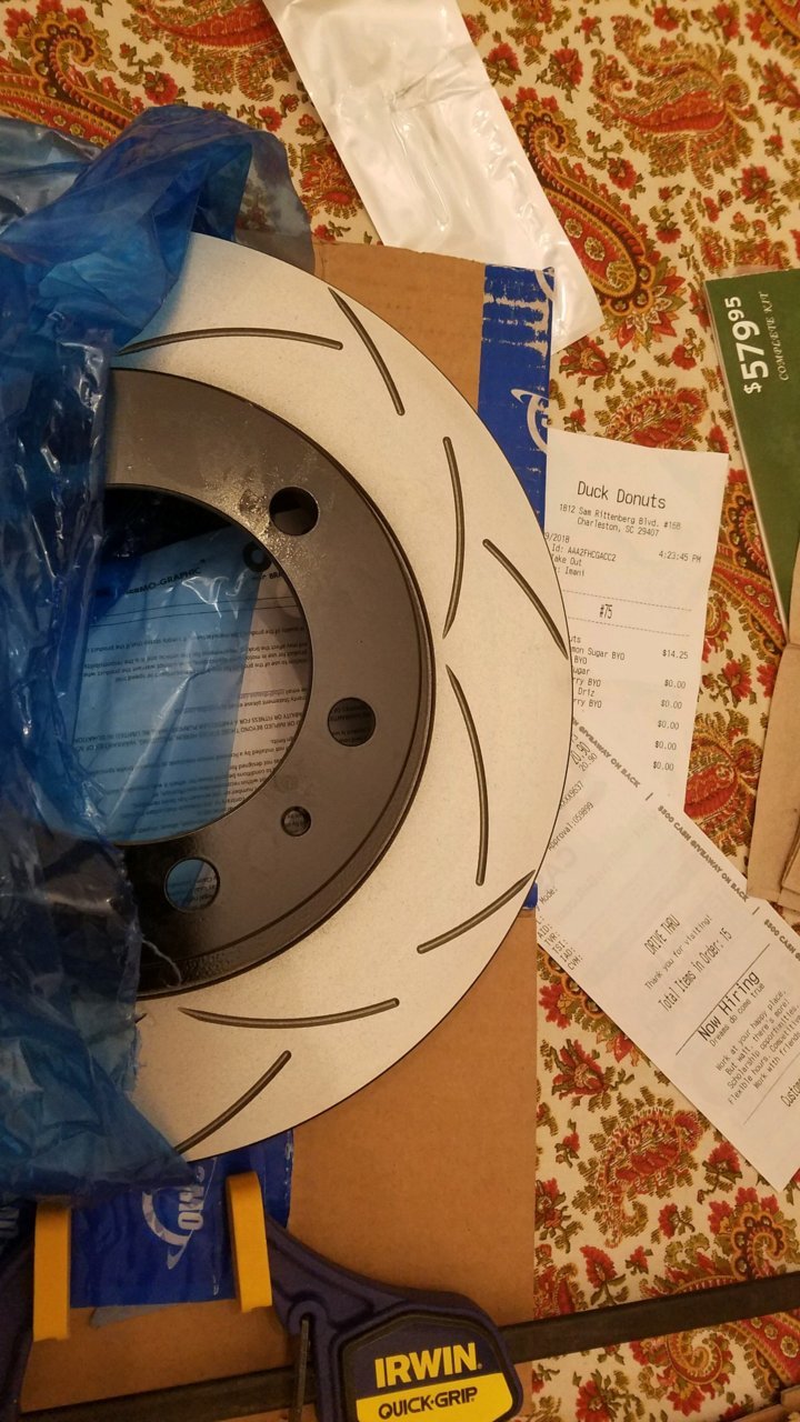

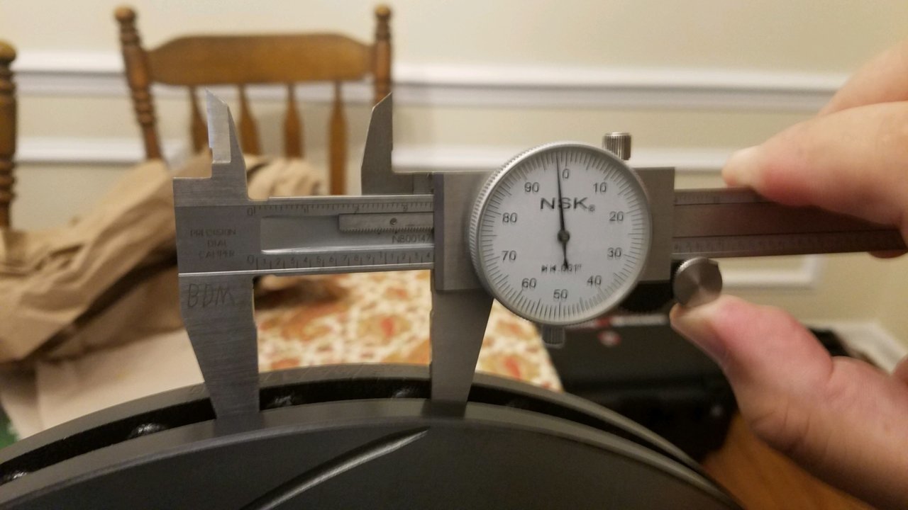

    2011 DC 4x4 SCed
    TRD Blower, Ham Radio, DBA T2 Rotors
    20181201_152058.jpg 20181201_152945.jpg 20181201_153244.jpg 20181201_152357.jpg
    Going to try and install before i get shipped out for 11 months
