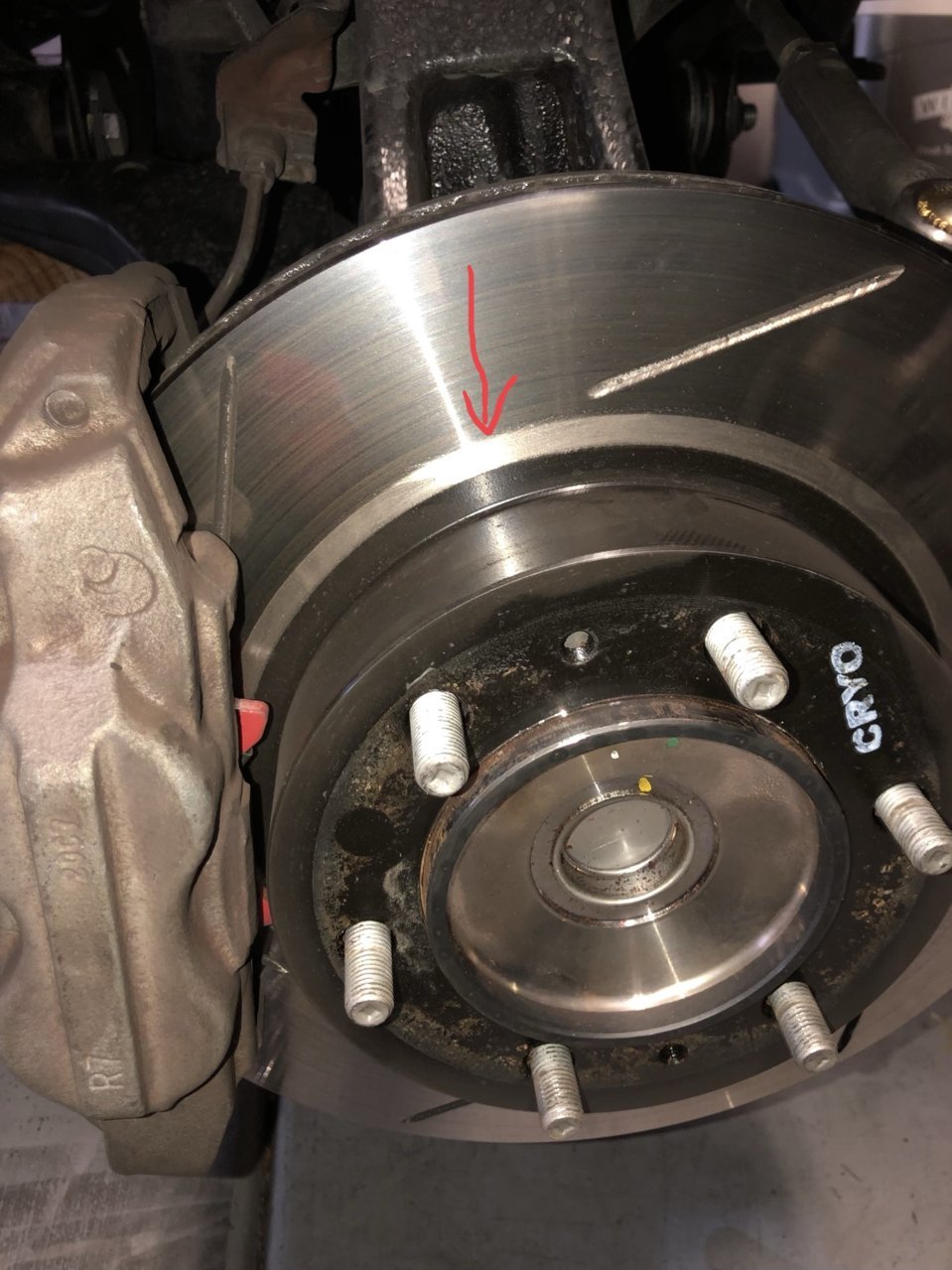

    I have my stoptech rotors and TRD brake pads installed for 500 miles now. I noticed a scratch on the inner diameter of the rotor above the black circle. Running a finger over it feels like a scratch too.

    Is it a scratch or is it just an area where the pad doesn't contact the rotor leaving that surface un-smoothed.

    You're right, the pad doesn't contact that portion of the rotor. False alarm!

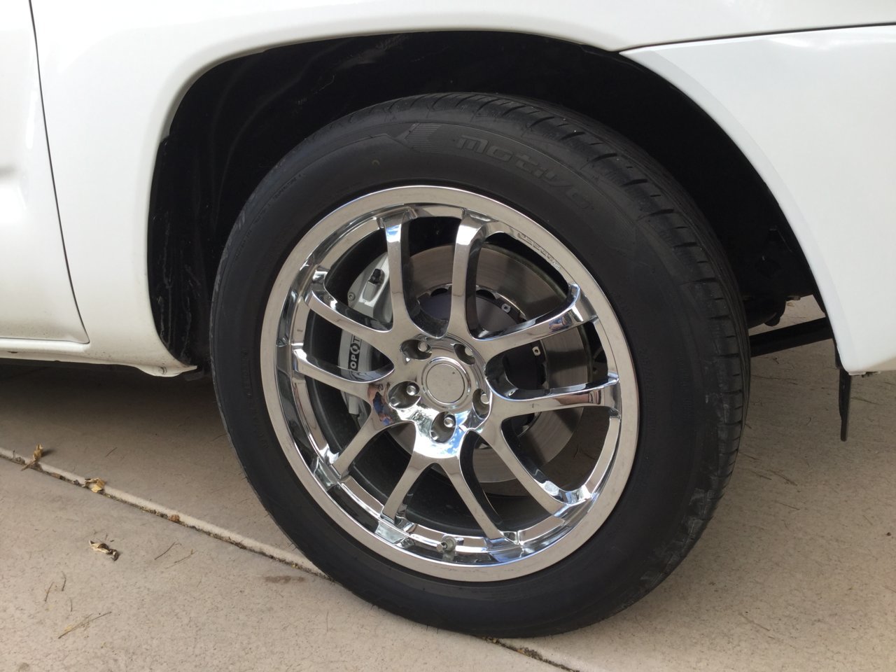

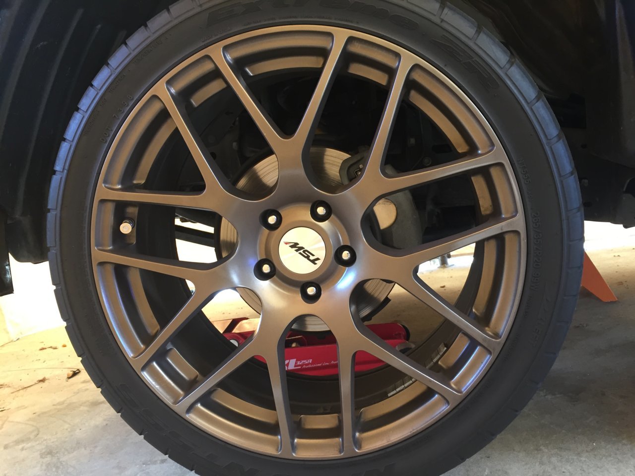

    As a random datapoint, I have had 3 trucks that I have put drilled rotors on, put over 100k on each and never had any issues with cracks forming.
    The last two I was aware that the holes did nothing for performance but what can I say, I like the look of them.
    Current daily driver has drilled ones because I couldn't find Lexus IS-F rotors in stock that were slotted only. StopTech does make them, they were just out of stock when I ordered mine.
    I did a Lexus IS-F rotor, Tundra caliper brake setup on my truck. There is a guy on the X-Runner facebook group that does small runs of the caliper adapter brackets.
    Used Stoptech rotors and braided brake lines, brand new Tundra calipers and EBC green stuff pads.
    Great upgrade for the 5 lug crowd.

    Richie,
    I myself waited for the gentleman to make a run. I then realized after a long wait and more research the rotors are rear rotors for a Lexus, design to have a parking inside i.e. Added weight. The calipers are cast iron i.e. more weight and the adapters are thick heavy steel plate even more weight. Sprung weight may not matter so much on Pre-runners & 4x4's but it does the lighter the vehicle gets. Driving light weight cars you can really feel it. So I decided to go with the Stop Tech / Tundra racing BBK with two piece rotors. The stock brakes with rotors and splash plates were 29 lbs. (if memory serves me right) The kit weight saved 4 lbs. (alloy top hats, alloy calipers & alloy adapters) So between losing 6 lbs w/ lighter weight forged wheels and the brakes the ride improve! Plus I can now do nose wheelies‼️
    Now I just need to install the QA1 coilovers & URD SC setting in the garage.

    @05prerun82 This is the brakes/rotors im putting on my sport when it's time to upgrade.

    Those 2 peice rotors are nice! I looked at them for the 6 lug but they are quiet spendy by comparison.

    I looked at that same kit as yours and almost pulled the trigger on it.
    It came down to money for the most part, parts availability being the other. In a pinch I can find all the parts at the neighborhood parts store.
    This truck will never see track days, it is my work truck so squeezing that last 1% of performance out of the setup isn't too much of a concern.
    BTW, cool seeing a built up 5 lug that isn't an X-Runner. Almost went the 4 cyl base route but got a good deal on the X.
