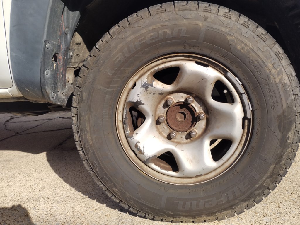

    Well it does look like he has aftermarket wheels or something. Below is my wheel it came on the truck not sure what kind these are.
    But I dont know the spacer he's talking about. If i had the spacer I would just get a caliper and try if it fits. If caliper fits probably the rotor and everything else will too.

    For fitment testing you need the caliper and rotor. The rotor will help make sure the wheel is in the real world spot. The spacer is for clearing the caliper with the spokes. Some wheels won’t clear those calipers, the spokes will hit. That is part of why 4Runner wheels are shallower than Tacoma.
    Wherher or not the 16” portion fits will totally be up to the wheel. A sterile like you have is more likely to work than an alloy. Especially because you normally clip wheel weights to the outside of a steelie instead of sticking them on the inside in the caliper area. Buy the parts and try it out to see how it goes.
