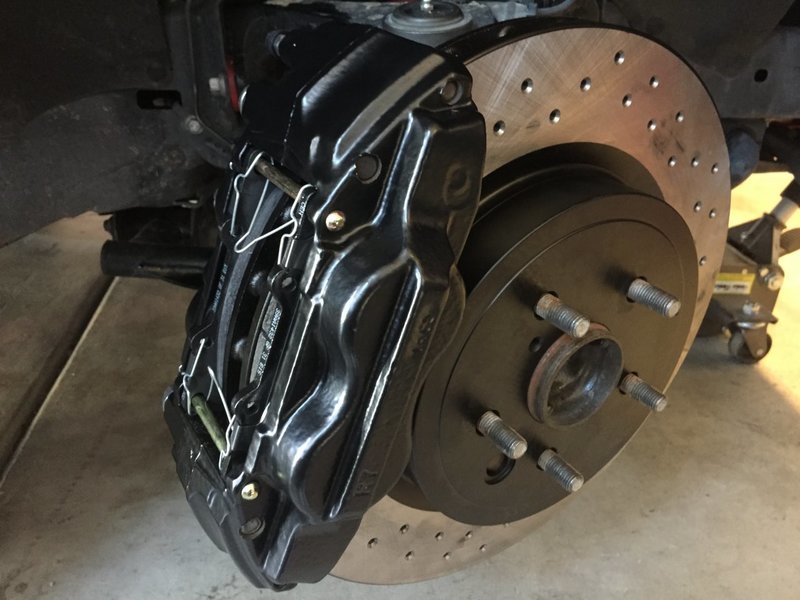

    Put together this brake setup for my 05 X-Runner. What yall think?IMG_2362.jpg

    :rofl:missing 1 wheel stud.

    Sorry it's not a 4x4/PreRunner but its better than spending $1,500 on BBK.

    Who'd you purchase the adapter from? Are those the Tundra calipers?

    I made the adaptors, and they're Tacoma calipers. I also made an adaptor using the Tundra Caliper.

    Good job man. Probably saved you some money, versus the adapter kit available, on XRU. Pretty certain that kit is only for the Tundra calipers though.
    Still a much better improvement over the stock single piston.

    Well I use the username in XRU. So you've might seen my brackets.

    I have a bracket using the Tacoma caliper with 345mm rotor and Tundra caliper with 360mm rotor.
