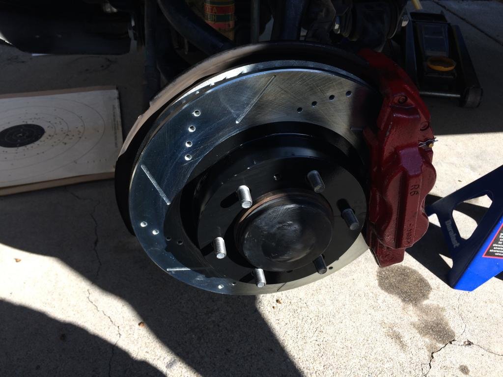

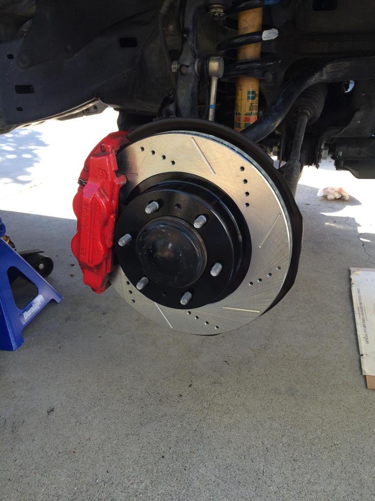

    Sorry for the delay in response.. Didn't actually end up installing the kit until 2 days ago. The brakes looked fine when I pulled them apart a month back so I decided to leave them on. After about a month, the wheel shake got a bit worse so I decided to install the kit.
    First Impression: The brakes work! That's always a good thing right lol. Break in went great. Very straight forward on their website. They seem to be pretty strong. Defiantly feel as good as stock did. I haven't really slammed on them too hard since the break in but I'll give them a test on the way to work today. Will post my findings later tonight.
    Defiantly look cool for sure! :D:D

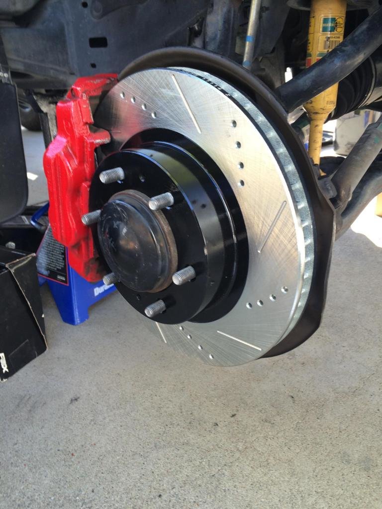

    Toytec Boss kit & OME leafs, 231mm tundra brakes SCS wheels...
    I upgraded my 1st gen tacoma & 3rd gen 4runner with tundra brakes. It's a direct bolt on. Made a big difference.

    Will the tundra setup swap right into a 2nd gen, provided rims will clear it?

    Wow! Very cool. The visual comparison is impressive!! Did you have to change wheels after the swap?

    The stock 2004 16" trd wheels cleared the calibers just fine. I did have to trim the backing plates a little where the caliber mounts. pictured is the larger 231mm tundra calibers. On my 2000 4runner i installed the 199mm tundra calibers, also a direct bolt on. I tow a small camper and sometimes atv's on a trailer so that's why i upgraded.
