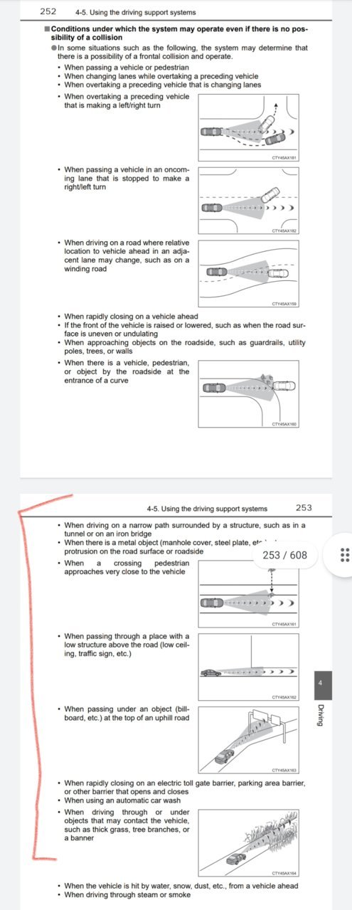

    Any sort of overpass or bridge in front of you as you were approaching the intersection? I believe the owners manual mentions this as a condition of "situations where TSS may not work as expected".

  8. May 2, 2022 at 7:25 AM

    Just the light rail tracks.

    Happens to me occasionally on my 2018. Never caused a problem. A overpass scared it one day, poor truck!
