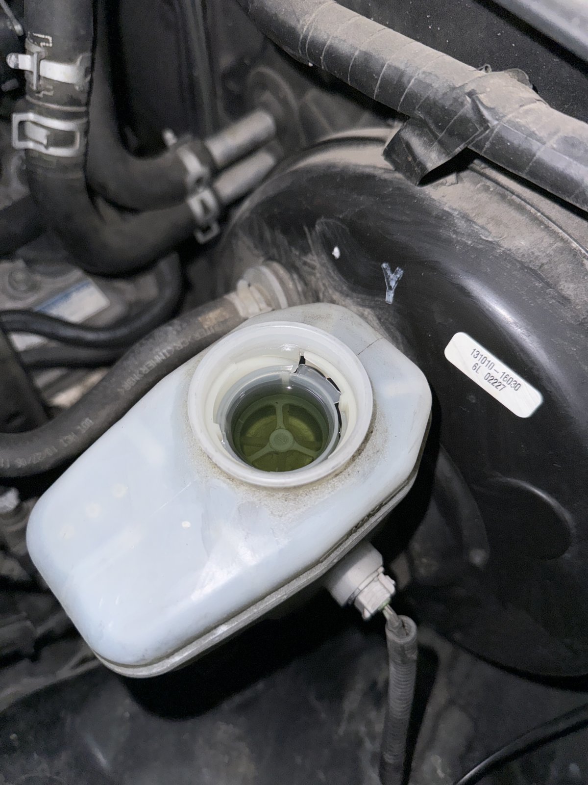

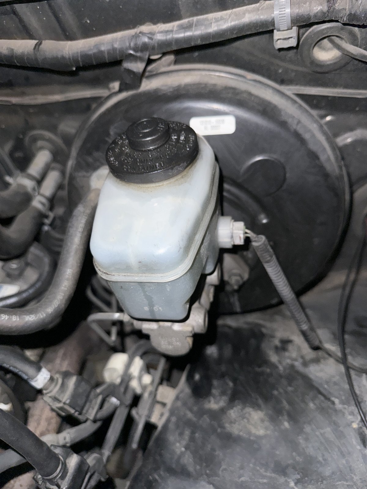

    It could be a bad master cylinder. Was the brake fluid black or green when you got it?

    #423175
    116
    When I was bleeding the brake fluid, it was dark brown in color. The brake fluid I got, I think was green (don't quote me cuz it was months ago)

    I mean the brake fluid in the reservoir. Was it green or very dark? That could indicate a "corrosive" behavior that could damage the internal seals in the master cylinder

    Zdosse935 [OP] Well-Known Member
    Apr 24, 2023
    #423175
    116
    It was a dark green color.

    Pressure bleeder. Hopefully the BMC is not internal leaking allowing pressure to leak past the seal.
