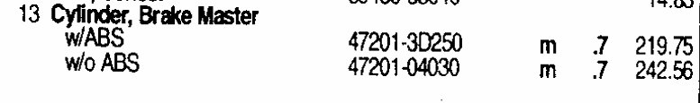

    Also, from a parts perspective, the master cylinder was different for '98-00 models depending on ABS, but was the same part for '01-04, so I don't know exactly what changed in the braking system there, but it resulted in the same master cylinder working regardless:
    '98-00
    '01-04
    I might give this one a shot since it's only $40, or maybe the Dorman ($97) since it's shipped/sold from Amazon and so easy to return. Plus, the Dorman lists the OEM part number in the description (47201-04060).
    Otherwise, take your pick from the options on RockAuto; I'd say they are probably all mostly the same.
