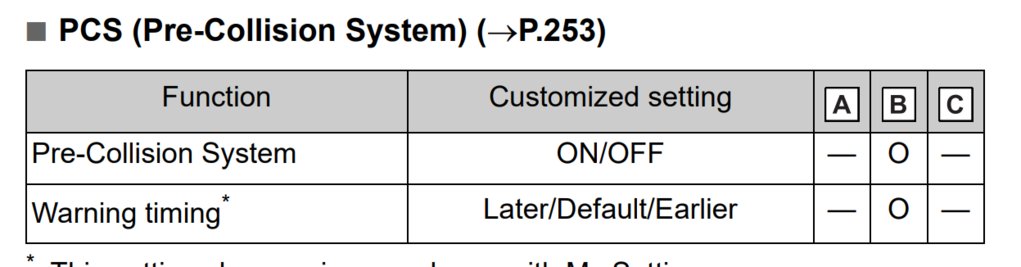

    You probably need to turn off damn near all the “safety systems” in chapter 4-5 of the owners manual.

    I think you need to turn precollision off too.
    It's under the setting in the dash.

    I’ll try that.. :crazy: But I think that’s the front TSS sensor PCS. The blade is on the rear hitch mount, figured the only thing would be parking sensors on the rear l?

    Ok. I did a little digging.
    It is called PKSB. Or Park Support Braking.
    You are NOT the first to have this issue.
    See post #4 in the link below.
    Then post #6 on how to turn it off.
