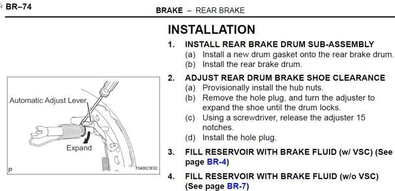

    And make sure you properly adjust the rear drum brakes.

    I have new drums in the rear and have tried adjusting them with the drums off but I can't seem to get them tight enough that way. Yes, the adjusters are very hard to get to lying on my back. I had a shop put the truck up in the air and tighten the rears with the drums on, but I think they could still use some more tightening. I bled them out again before driving the truck and the wheel spins to easy. When the pedal is depressed I can't spin the wheel, not much of a test, but it does show the wheel cylinders are working.

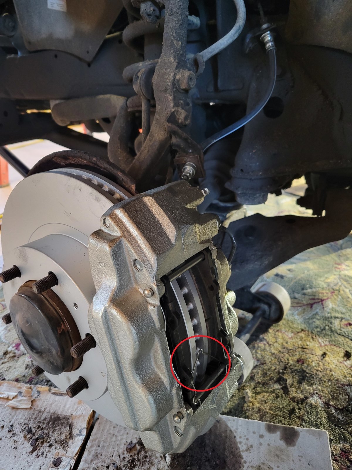

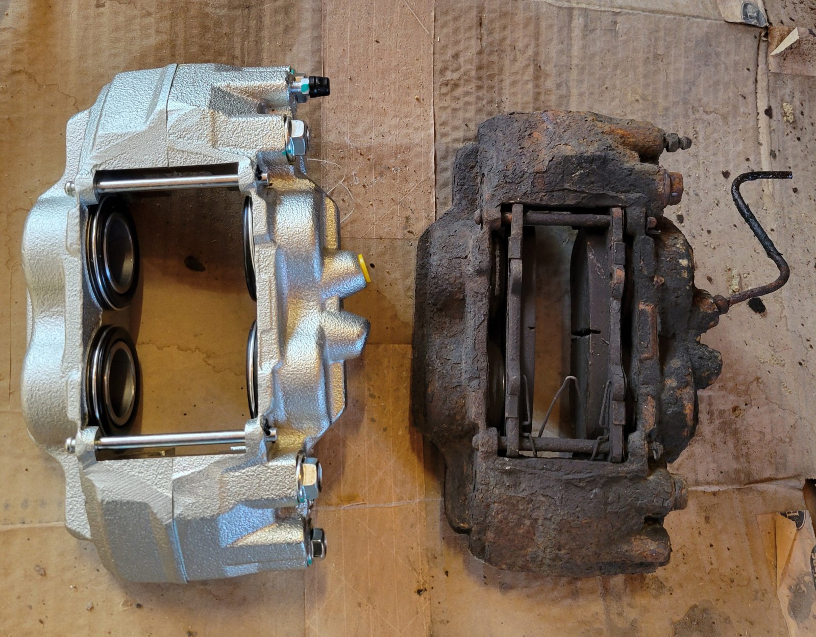

    Is that "W" spring contacting the rotor? It also looks like the spring isn't installed correctly.

    It is installed the same way as the one in the caliper I took off, but the spring in that caliper doesn't touch the rotor like the new on does.

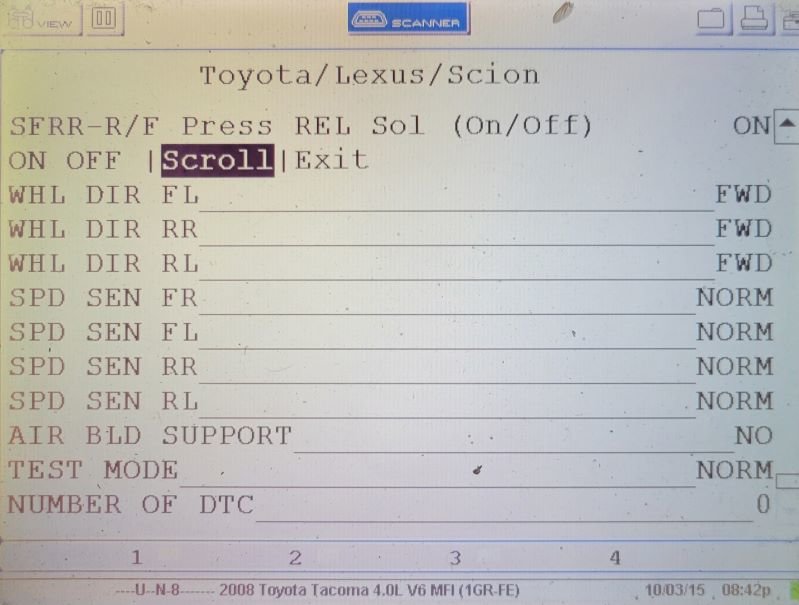

    Tonight I hooked up a Snap On MODIS EEMS 300 scanner using the K-20 key and could get to the ABS section for my truck. But when I am in that menu with a long list of items like "SFRR-R/F Press REL SOL (on/off)" etc. I can use the up arrow when the 'OFF' is highlighted to highlight the 'SCROLL" and then the list scrolls to a point but will not go to the 'AIR BLEED' item. It shows in the list but it won't come up next to that line with the "ON OFF SCROLL EXIT choices. Anybody know how to get to that Air Bleed choice?

    Looks to me that it's telling you that it doesn't have the air bleed function for the particular vehicle.

    LOL...I kept reading that as ON/OFF...I bet you're right!
