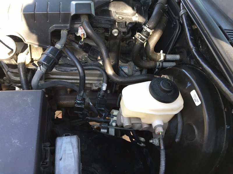

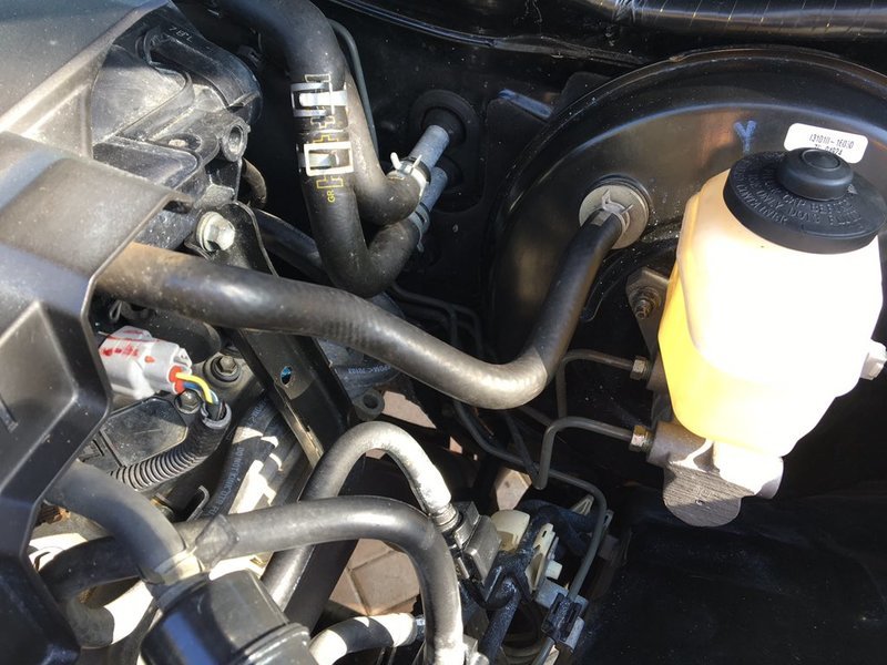

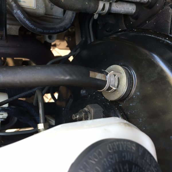

    Is there a vacuum valve or anything on the manifold or just the check valve in the booster?

    What I find strange, backwards even, is that when the vacuum line was removed from the booster, then pedal would get soft again.
    I had capped off the vacuum line routing to my brake booster, to do some testing. Within a 1/8 mile the brake pedal had so much pressure, that I had to use an incredible amount of force to get the truck to stop just from 30. Frightening amount. Put the line back on, and good ole brakes again.
    Which makes me wonder if there is a vacuum routing that is wrong? Except it should possibly be visually obvious to the OP?

    I inspected the vacuum line and it appears fine. Is there a way to check he valve in the booster its connected to?
