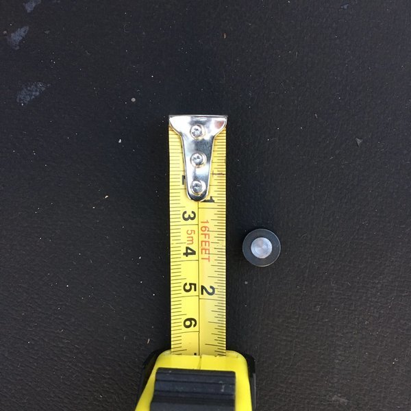

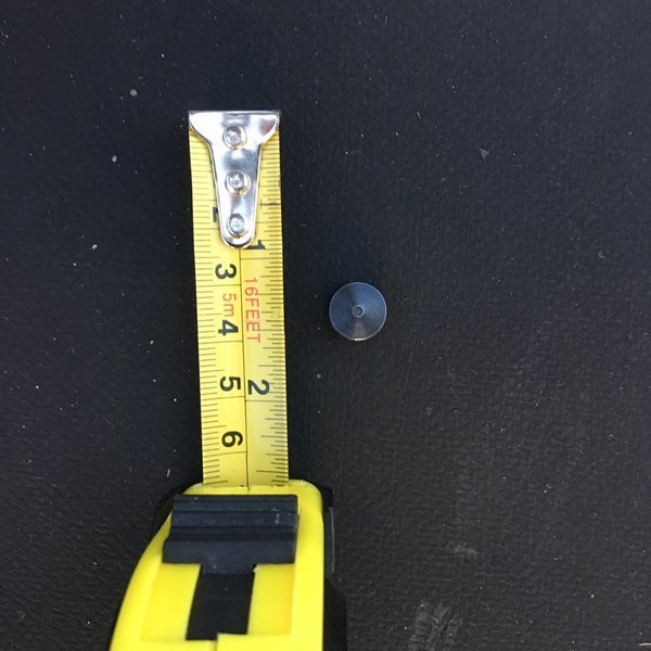

  13. Sep 13, 2016 at 9:42 PM
    #93
    Scrapla
    Scrapla [OP] Rebel Without a Clue
    Nov 15, 2015
    #169709
    301
    South Florida
    2007 Tacoma PreRunner 4.0 V6
    1.5" lift, ARB bumper
    Pulled off my booster today and heard something rattling around inside and this eventually fell out. Any idea what it is? I installed a rebuilt booster and took it for drive on the highway and side streets and the peddle felt great so hopefully this was it.
    Ruggybuggy likes this.
  14. Sep 13, 2016 at 10:45 PM
    #94
    Torspd
    Torspd Tor-nication
    Sep 18, 2009
    #22958
    26,453
    Tor
    The Great America!
    MMVI 4.4L 4x4 Access Cab
    Torspd Custom Turbo kit [] Borg Warner 9180EFR Turbo [] Haltech Elite 2500 [] TiAL Q BOV [] TiAL V44 Wastegate @ 15psi [] CP Pistons [] CP Carrillo Rods [] ARP Head studs [] ARP Main Studs [] ARP Header - Head Studs [] Ported Heads w/ 1mm oversized valves intake/exhaust [] Brian Crower Forged Stroker Crank [] Darton M.I.D. Sleeved Block [] Kelford Camshafts [] Torspd 160* T-stat mod [] APR Large Fuel Rail [] Walbro 460 LPH E85 Fuel Pump [] FueLab FPR [] APR T56 Conversion Kit [] KP RACING Built T56 [] McLeod Racing Custom Twin Disk Clutch [] One Piece Aluminum Driveshaft [] MGW Shifter [] Custom lowering kit [] Ohlins Front Coilovers [] QA1rear shocks [] Custom Ron Davis Radiator [] Dual SPAL Electric Fans []
    Is it tapered on the black face side? A vacuum valve of some sort perhaps?
    Ever the persistence has paid off. :thumbsup:
  15. Sep 13, 2016 at 10:47 PM
    #95
    Scrapla
    Nov 15, 2015
    #169709
    301
    South Florida
    Yea looks like its tapered on one side and on the other side it looks like it sheared off something. I have my stock booster debating on sending it out to get rebuilt just to have a spare or sell it on ebay. I also want to rip it open and see exactly what that part came off and to really see how the thing works.
    #95
  16. Sep 13, 2016 at 10:47 PM
    #96
    Torspd
    Torspd Tor-nication
    Sep 18, 2009
    #22958
    26,453
    Tor
    The Great America!
    Just think. Now your truck is no longer a death trap. ;)
  17. Sep 13, 2016 at 10:48 PM
    #97
    Torspd
    Torspd Tor-nication
    Sep 18, 2009
    #22958
    26,453
    Tor
    The Great America!
    Dig into it, and share. I am extremely curious.
