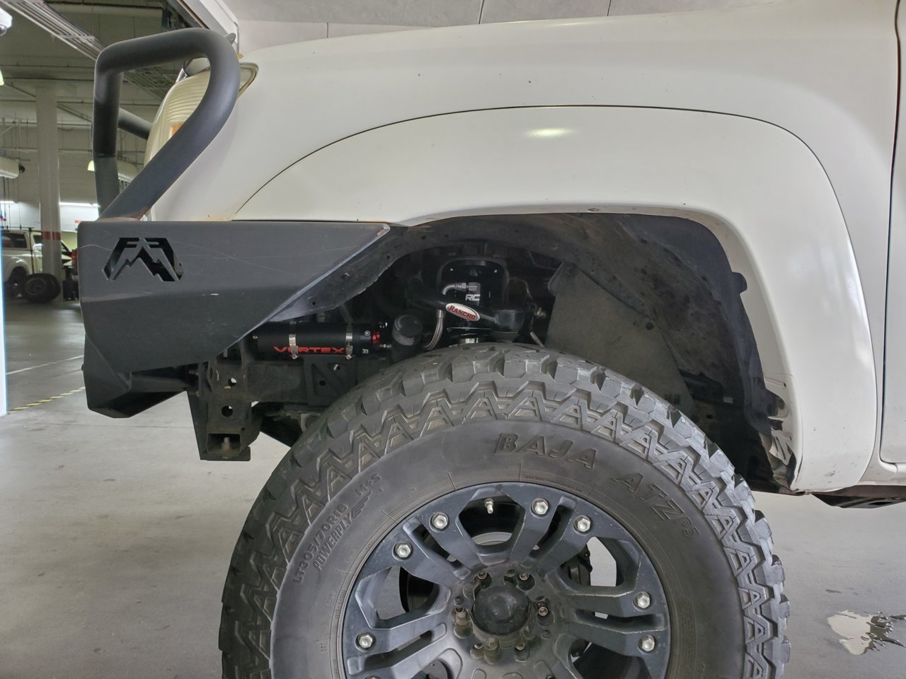

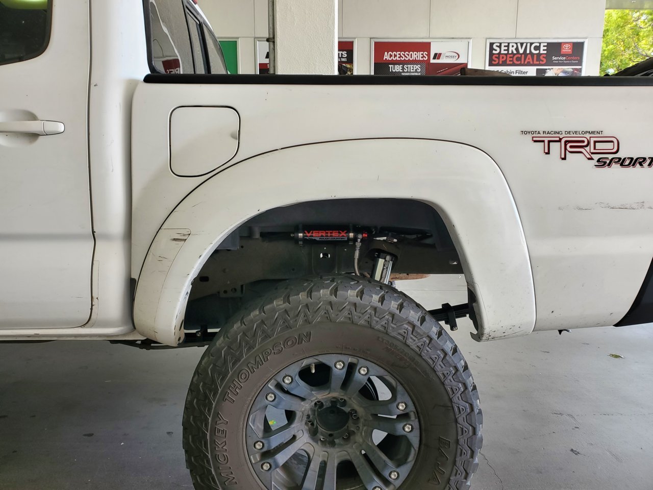

    I just got new Rough Country front and rear Vertex suspension installed at ORW in
    San Diego. While replacing these parts, they also installed new LCAs (Moog), Calipers, Pads, Rotors, Sway Bar Links, and Tie Rod Ends. I am having the exact problem Scrapla describes, reported to me by ORW during their test drive. ORW and Toyota Dealership service department both don't want to touch the truck. ORW thinks it's an ABS issue they are not qualified to fix. Toyota dealer says it has too many aftermarket components and too much recent work that they don't want to touch. Since everything has just been bled and calipers are brand new, I assume I have a similar problem with the booster. ORW mech told me when pulling the hose from the vacuum pump, the brakes would release. This is insanely frustrating. It is weird to me that this problem occurred immediately after all this work was done.
