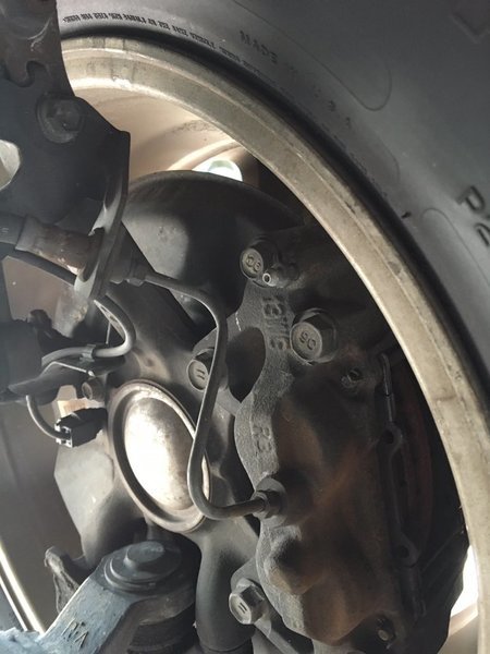

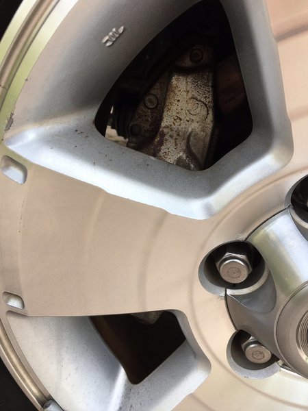

    Did not see a red hot brake after I pulled over. I think it was just the front passenger thats where the smell and a little bit of smoke was coming from. My battery came with the truck its an older one but I never had any problems before this as in braking. The truck didn't want to start like I said at first and it also didn't want to leave park for me to roll it back to get a jump. I'm new to working on my own truck. I just washed her not to long ago and only noticed some new dust on the front passenger side. Anyway I can check the master cylinder or anything myself? I have no warning or service lights in the dash and all my fluids are fine as in all at the full lines.

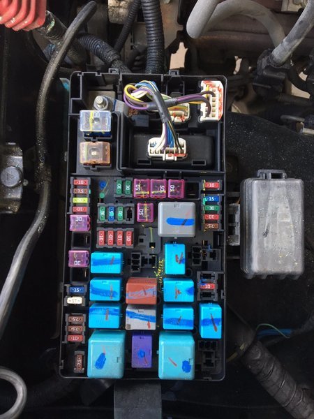

    Just checked the fuse box and wires and they all seem good this truck isn't to abused the engine bay is pretty clean for being an 07 just my positive terminal always builds up that crust but its never been an issue with not starting. Would a dying battery cause any of this?

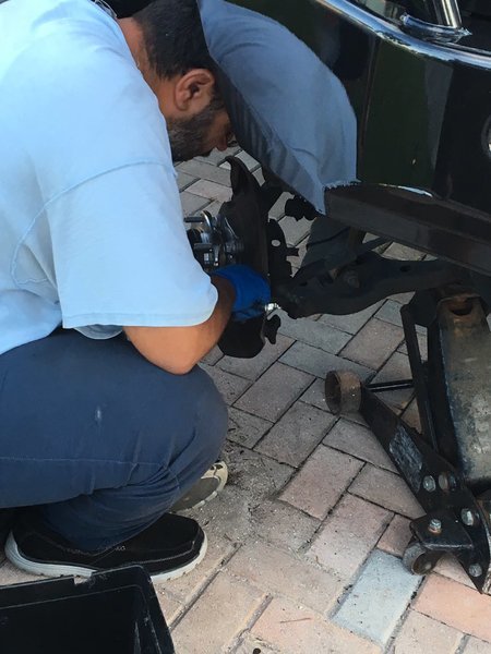

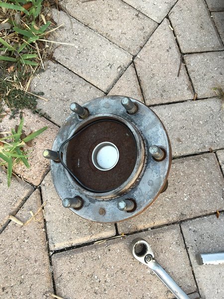

    Ok so dumb and so sorry for forgetting this but when I bought the truck the guy said it may need a new wheel bearing on the front passenger and I bought the entire bearing and assemble from a link I found on here months ago and never got around to installing. Is there a chance my bearing just went out causing the front caliper to lock up? I ran the volt meter on my battery and its fine I got 12v off and about 14v when running.

    Sorry for being annoying but I replaced the bearing n hub assembly kit and it seemed to do the trick. Took it out for a spin and no noised, grinding or pulling to either side. I also checked the pads which were very beefy still a lot of life left.
