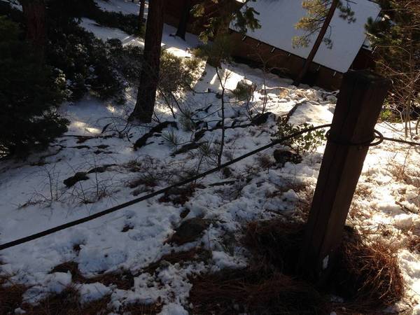

    Im not a fan of the sliding down a hill brakes wont engage because of abs thing. Made a down hill right hand turn at 3 miles and hour and hit Ice. Brakes would engage and Id almost stop then disengage. I almost died. Hope your truck gets fixed.
    The Post that is under my truck in the first photo
