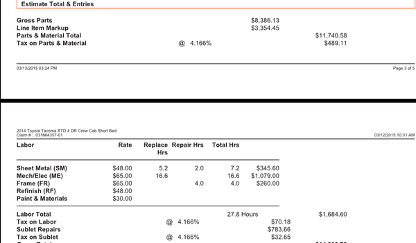

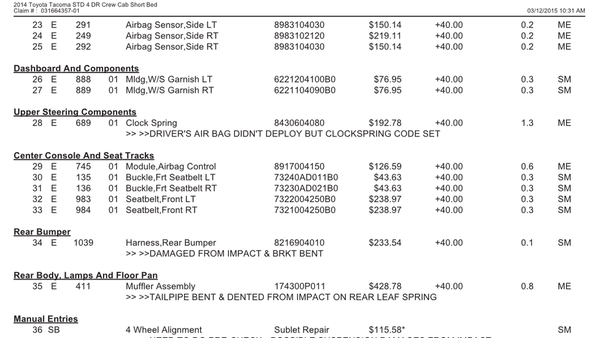

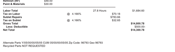

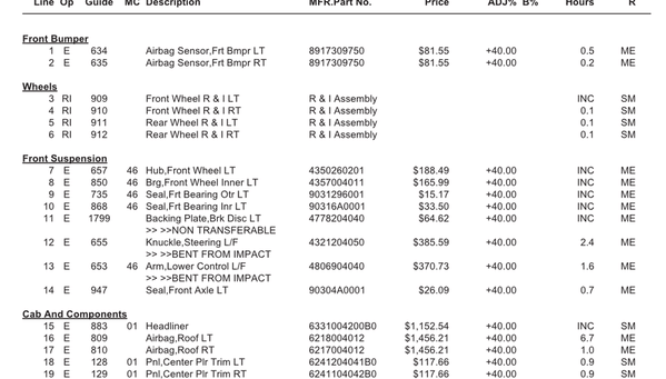

    [​IMG][​IMG][​IMG][​IMG]
    Grand total for me to get my truck back. Turned out to be a pretty major accident after all.
