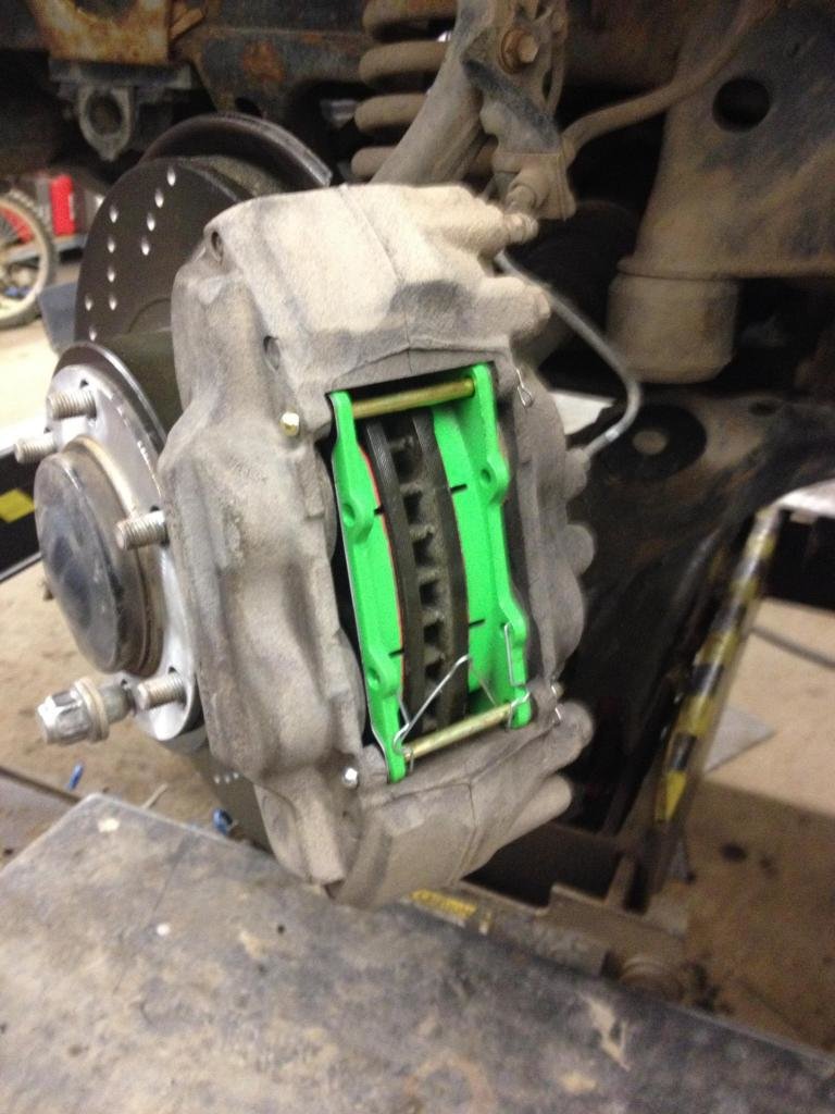

    Here in Alberta, I just went to NAPA & they had fresh retainer clips for the Front. and Pins. I did both. You can see in my pic (green pads) the new mounting hardware.
