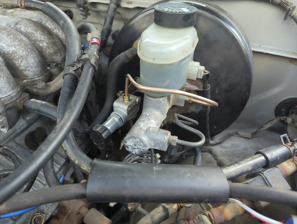

    - I have removed the ABS system and installed a Willwood valve up front. It was way easier than I thought. I only had to make two lines. It took like 4 hours I think before I was test driving it. Willwood set to max limit. This is I think 50% reduction to rear.

    Wait, I’m confused. You installed a Wilwood proportioning valve to the front brakes after removing the ABS system? The picture indicates the valve being use for the rear position. When folks installed the valve, it’s to replace the LSPV. Hopefully you’re not running the Wilwood in line with the LSPV.
    Also, hopefully with the ABS delete, you got the correct line routed from the 3-way splitter from under the MC.

    No the valve is running the rear, lspv deleted with abs. Yes the t under the mc is feeding the front brakes. When I say "installed up front" I just mean the valve is in the engine bay, not out back as some have done. Sorry if that was confusing.

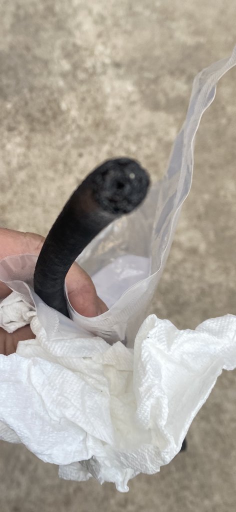

    Lift the whole front end. Have an assistant or use someting to apply brakes see if one wheel turns and other doesnt. Could be collapsing rubber hose under pressure

    Bourbon state
