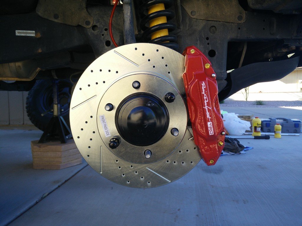

    You can always do the 13wl tundra brake upgrade

    Putting tundra calipers on the tacoma. Bigger calipers and rotors. However, only certain rims work.

    I did it because with all the extra weight from front and rear bumpers made the brake not as great.

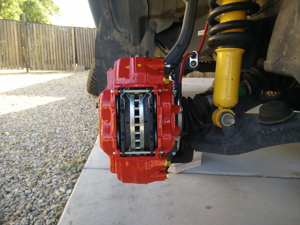

    I did the Tundra brake upgrade with S13WL calipers. Bought them from Advance Auto for under 100ea after core charge. I bought genuine Toyota pads and rotors though because the pads were non-camfered and the OEM rotors are generally higher quality than aftermarket ones.
    There are numerous threads about the swap on forums; I used that I linked to from the 'DIY links' sticky thread. That thread convinced me to purchase said OEM pads/rotors and to use the S13WL calipers (not the smaller S13WE). If you're dropping the coin on Tundra brakes, you should also do stainless lines too (the increased caliper size can cause the rubber lines to flex and give the brakes a 'spongy' feel, supposedly). The lines from Wheeler's installed easily and removes the need to drill any banjo bolts. I don't have the receipts in front of me so I can't give you a cost, but it wasn't much more than a standard complete brake job.
    I am very happy with the brakes. 1.5 years and 20k miles later they still feel great. The pads are holding up very well and show very little wear. I worry less about stopping power with the added weight of an ARB bumper, winch, bed rack, and rear bumper. Definitely paint the calipers if you get them new though. Mine are covered in surface rust now and I wish I had done it.
