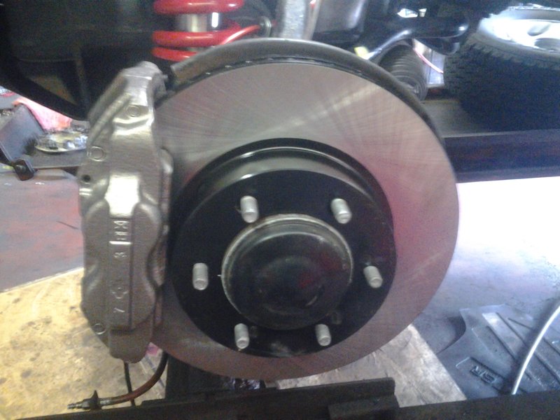

    Just to piggy back on what others are saying, my truck is far from stock. I just swapped in my 231 Tundra calipers and man... It's got that new car, touchy brake feel. I also have rear disc brakes on my fj80 axle. It's brings my 35s to a halt with ease. I bought my calipers off eBay. I did a little searching and found a pare with less than 100k on them. Then I bought new pads and rotors from Toyota. I bought the brake line kit from wheelers, although I just used the banjo bolt and kept the stock rubber lines.

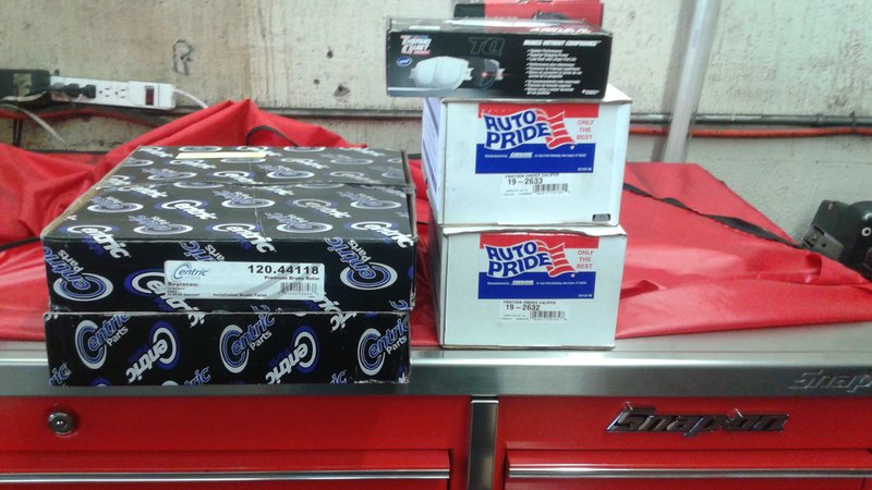

    Yes it is the same. There is a company LCE Performance who makes a kit. It has everything you need to do a Tacoma to Tundra Swap if you don't feel comfortable finding the pieces on your own.
    I got calipers from Napa (13WL 230 MM.)
    & ordered EBC Rotors and Pads ( Stage 3 Kit I think they call it) thru Amazon.

    I did the 231mm tundra upgrade to my taco and the 199mm tundra upgrade to my 2000 4runner. BIG improvement over stock on both trucks. I have a 199mm tundra kit sitting at work to install on my wife's 02 4runner. The stock 16" tacoma wheels do clear the 231mm calipers.
