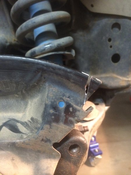

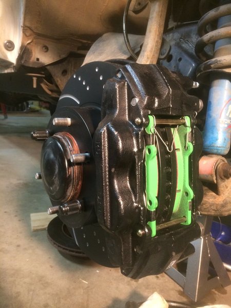

    Did the Tundra Brake swap tonight. 13WL fit with Method NV 16x8 4.5 BS. I have at most 1/4 -5/16" clearance at the narrowest point between the caliper and inside of the rim. Very minor trimming of the dust shield, one spot I just bent it back 1/4 inch.

    2nd gen 4x4 rotors are 319 mm. :)
    If you really want to upgrade, you can get 338 mm rotors and calipers meant for the 4Runner Limited, code 13WH, but they require minimum 17" wheels to clear.
