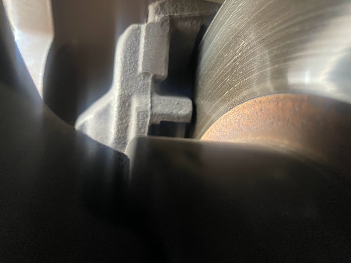

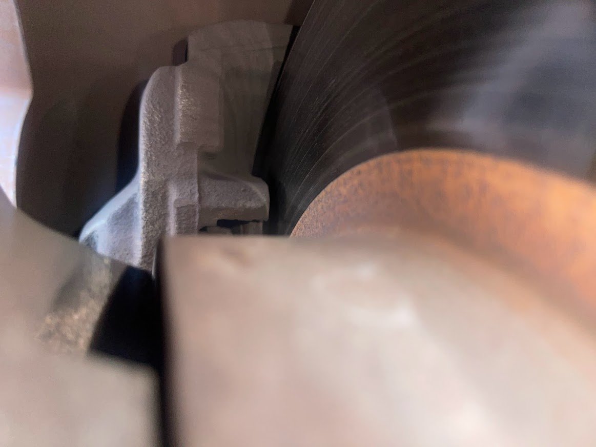

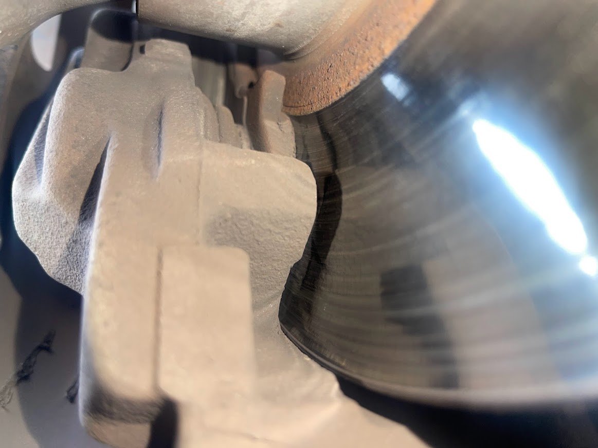

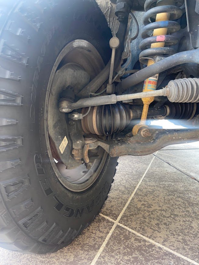

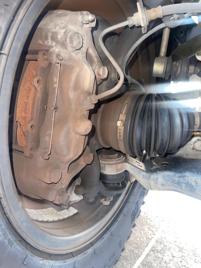

    Hey folks!
    I was told in a past inspection that I need new brakes. (As some of you know, I don't really know what I'm doing but I'll get the job done) Can you tell by the pictures if I need pads, calipers, rotors? I was planning to just replace the pads with OEM but I'd love to hear what you have to say. Thanks in advance!

    HOLY WHEEL WEIGHTS BATMAN!
    Take the rotors to get turned, replace the pads n call it good.

    Need to machine or replace the rotors.
    Pads do not wear the rotor flat, so it bows and creates a U shape on the rotor face.
    So when you install the new pads, the force will be only on the outside of the U and have irregular wear.
    Also I think you have aftermarket pads in there right now, and the shims on the pads need to be transferred, or you need to buy OEM shims (if you want oem pads). Sometimes aftermarket shims don't like to come off the pad and will break on removal.

    I’ll try to explain. The last picture. The brown rusty part, the rotor. The rectangle with 2 pins in the outer holes & 2 little ear’s with holes, the pad. The gap between is the brake friction material, which does look thin.
    Doing a brake job on discs is very simple, even for someone who claims to not know what they’re doing. You could probably find a step by step instruction in the stickies, or a video.
    Drums on the other hand is complicated but not impossible. It can be done with sockets, pliers, screwdrivers but your hands will hurt, your head will hurt, and your cussing vocabulary will be exercised. It’s so much easier with the brake drum shoe specific tools. It also helps to take pictures before taking it apart or do one side at a time. Have a friend to call if you get stumped.

    I look at what's left of the pad material and the only to do it is to take the wheel off. I just checked mine when I did an oil change and rotated the tires. I measured mine with a caliper and one pad measured about 3 mm or so and the other three were about 4 mm or so, so I'm letting it go for another oil change and will check them again. I did order Akebono pads and Advice rotors from Rock Auto. Apparently, Akebono pads are U.S. made. The rotors came with a certified sticker on them saying something like "certified high carbon". It's the first time I've seen such a sticker on rotors.

    You DO NOT need to replace or turn the rotors. I actually recommend against it unless there is a problem (like a pulsation/judder, rotors too thin, excessive grooving, etc). Based on the pictures, those rotors look to be in excellent shape. You will be fine simply changing the pads. If you're happy with the performance of the OEMs, I would go with those...
