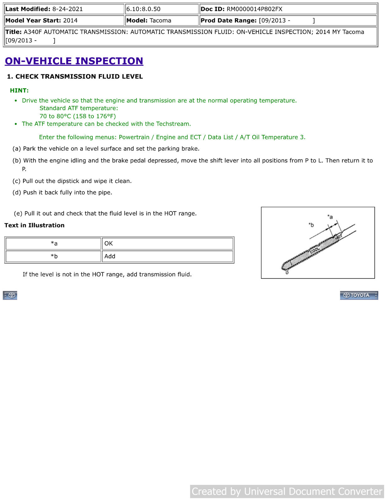

    Have you checked your transmission fluid level? Sounds like it may be low.

    When you are going down a steep grade , any transmission fluid moves to the front of the transmission pan away from the filter inlet . As others have mentioned , You sure your trans fluid level is up to snuff ?
    You have the 4 cylinder . Be happy you have a transmission dipstick
    Engine must be running to check for proper transmission fluid level
