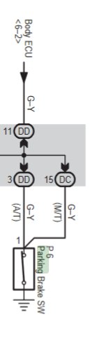

    Hey everyone, just wanted to let y’all know I figured out the problem with my emergency brake. First I have to rewind a little because when I was looking for the pigtail for the plug n play I found an adapter already plugged into it from the original owner. Everything was in tact including an xtra wire that I assumed was the ground, but it didn’t match the trailer brake controller that I had so I took everything out except the ground. as the adapter I had was relatively the same and had the xtra wire for a ground as well. So rather than just find somewhere to run a new ground i spliced into what a thought was the ground from the old adapter, so I buttoned everything up made sure I had a constant green light to the controller for electric continuity which I had so cool everything was good to go. Well turns out that “ground wire” was a wire that went up and attached the emergency brake. What it’s for I have no idea but it wasn’t connected to anything before I spliced into it so I just disconnected it, reran the ground and voila!! Problem solved. Now if anyone can tell me what the wire coming from the e brake is for that would solve a mystery. Thanks for all your input.

    This is the parking brake circuit.
    Body ECU >> Parking Brake Switch >> Ground
    So if you tied the ground wire into the Green/yellow wire then you would have thge symptoms you described: Brake light on and dinging chime when moving.

    maybe previous owner had a switch to bypass the parking brake for something, example is that head unit won’t play the dvd or navigate change unless parking brake engaged?
