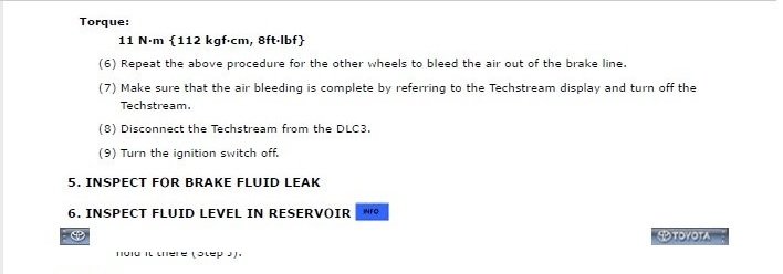

    Any trapped air inside may get out.

    FWIW, that's for vacuum boosted...it's a little different for hydraulic boosted.
