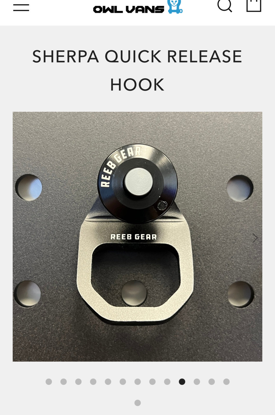

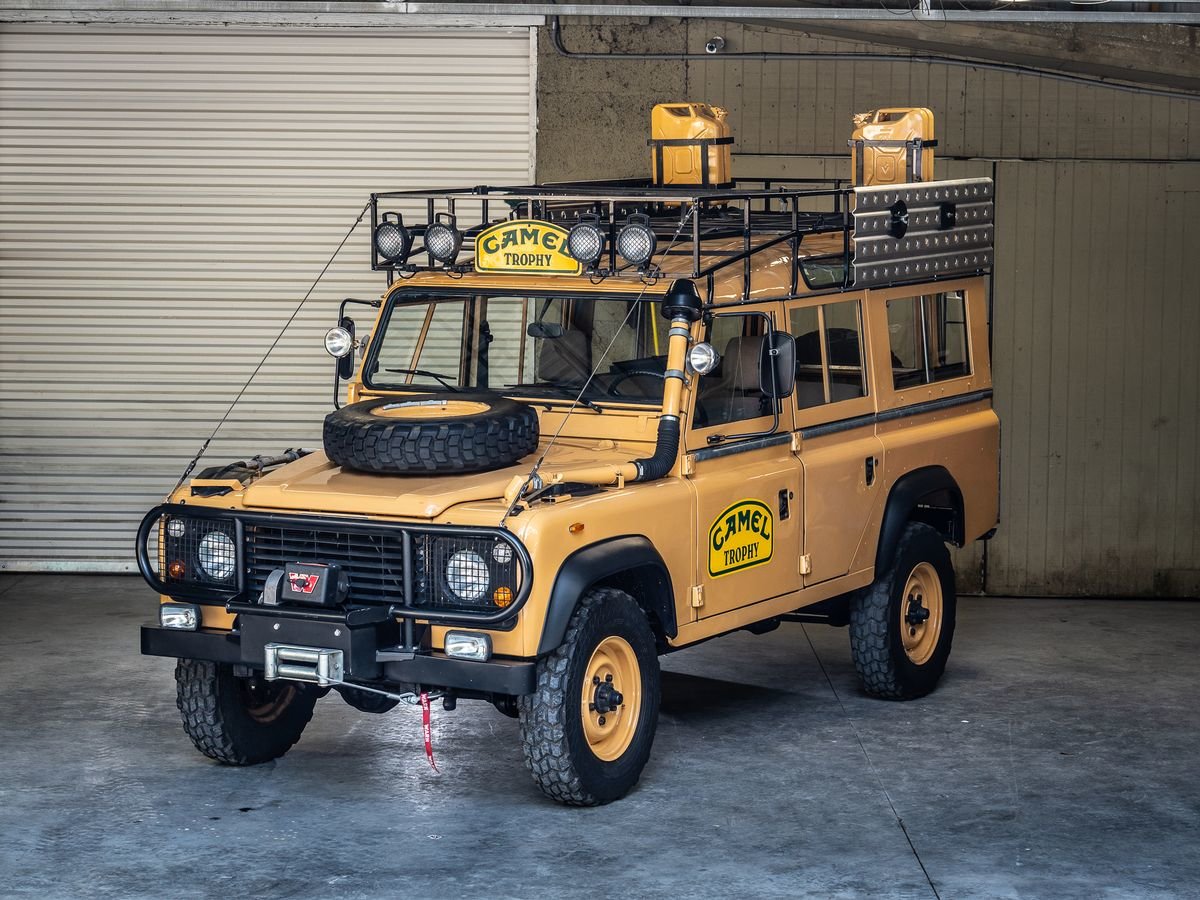

    dang. Yeah my Sherpa rack doesn’t go that high lol
    Snorkel currently has Syklone precleaner that hopefully continues staying put. Metal clamp is tight and added anti theft backup wires (metal cable) parts from a member here
    was gonna say, welding tabs onto bull bar looks cleaner than tube clamp
    but it appears above Camel truck took it a step further with holes drilled through it for eye bolts; seems like that could cause internal rust allowing moisture into the tube hoops

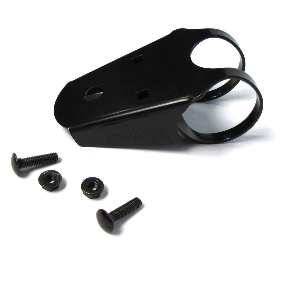

    I see the site says make sure to insulate the bracket to avoid paint rub. How is this done?
    Ordering separate to install a flat piece of adhesive backed rubber (thin) in that area or something? (Not that I’m even worried about paint rub on an almost 20yo truck)

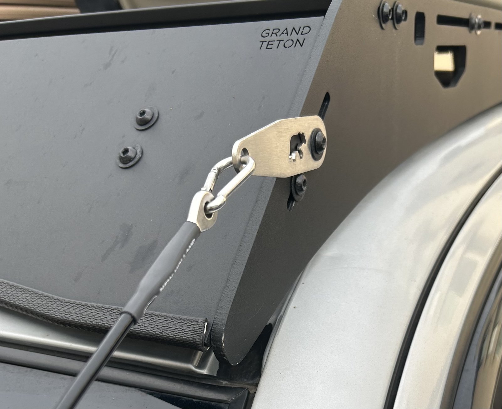

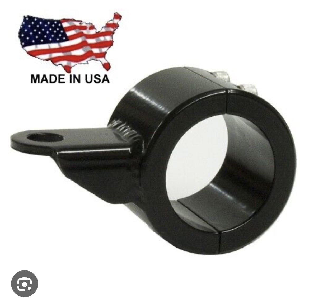

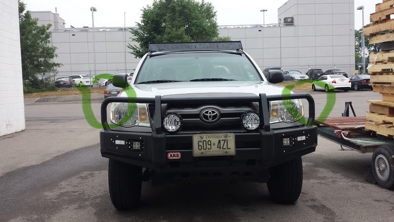

    installed NHO kit
    later on want to change it longer mounted to bumper hoops
    anyone done or know the best way to create a bumper hoops mounting point?
    Can think of 3 ways not not sure which is best
    -clamps, or ARB CB clamp. Movable, but might be bulky and ugly
    -weld on a mount; could compromise PC of the bumper and is permanent
    -drill a hole and screw an eye bolt; also can compromise PC and be permanent
    ARB CB mount could potentially look clean due to being the same black, and flush facing backwards level
    Looks better than all those Amazon universal light mount brackets
    These don’t look bad either
    Guess I’ll pick one and see what happens.
    ideally, the clamp would also be able to be installed on the curvy corner of the bumper hoops rather than only on a level part, to maximize outside protection and clear hood opening.
    the ARB CB clamp might be able to do that while the others wouldn’t.

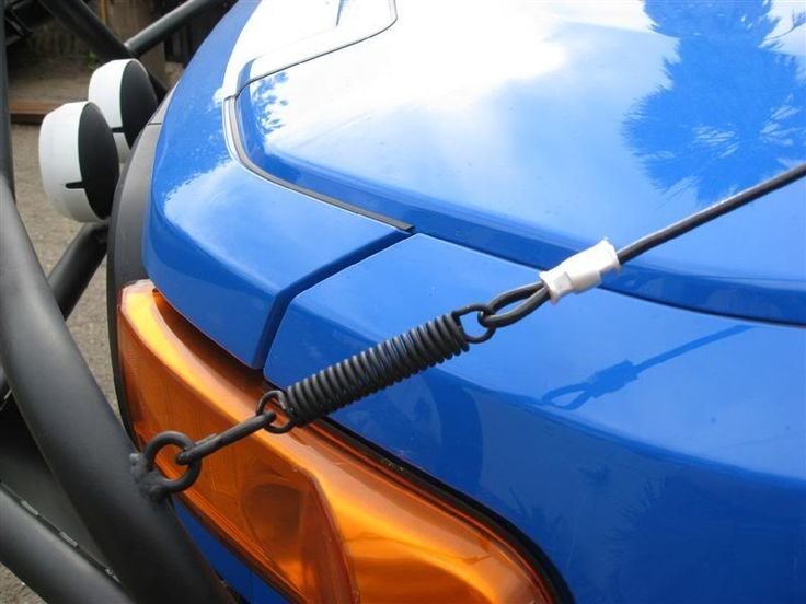

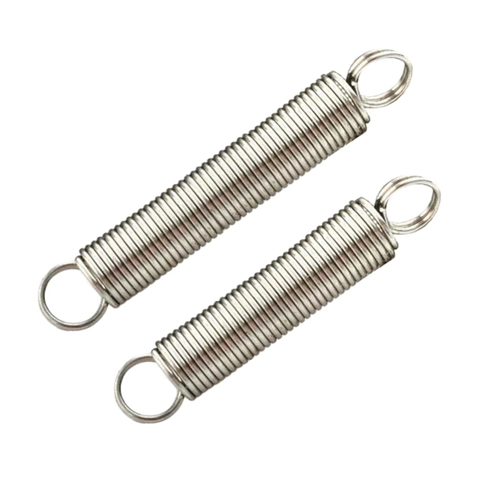

    body to body shouldn’t have flex. But if I make it body to bumper there will likely be flex and I’ll have to figure out what expansion springs to put to allow for that.
    hopefully the springs are not so weak that they result in slack and shaking of the wire.
    would be cool if there’s a way to figure out not just spring dimensions but how much tension it should have.
    Many online spring ads only list dimensions. Only seen one so far that showed tension (40lbs)
    kind of like how hood, cargo box, etc struts all have a certain desired force spec that isn’t too much or too little
    maybe it won’t hurt to overdo it on the spring tension as it may still allow for some give that a solid wire wouldn’t have with no spring.
    Theres a bunch on Amazon. Maybe Home Depot. Even HFT.
    Guy with the FJ cruiser used springs from Home Depot. Said he found long skinny springs too weak and picked short wide.

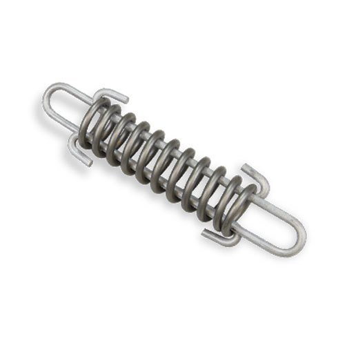

    Then there’s “drawbar springs” that appear to have more secure ends, whatever the hell a drawbar spring is.
    But drawbar could require modding or additional carabiners which would not be idea, overcomplicating the wires and making them look ugly like a jumbled Home Depot aisle on the truck
    even more convenient, a spring would allow for quick disconnecting of the Limb Riser without having to mess with the adjustable tension shaft.

    Id look at something simple like an exhaust clamp, u-bolt, etc. As long as you can find the right size, you can weld whatever you want to that. Paint it all black and clamp it anywhere on the bar. As long as theres no sharp edges and you don't go ham clamping it down you shouldn't break through the powder coat

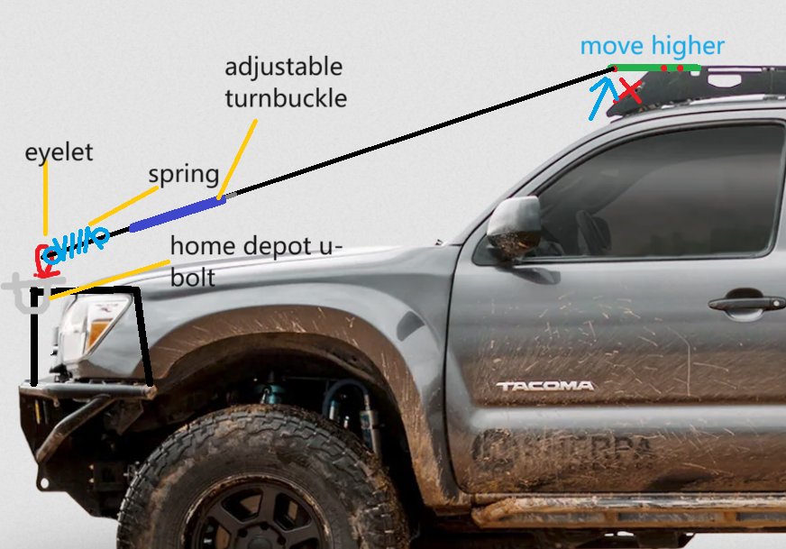

    alright
    So
    Was at Home Depot looking what they had and it seems to be a good amount.
    they’ve got U bolts for cheap that come with a flat piece

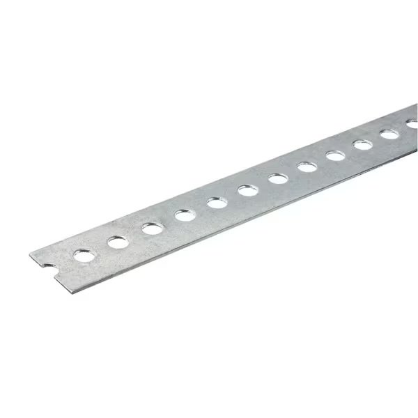

    I need to figure out a clamp to bolt onto them, or make a longer flat bar and drill holes. So it sticks out on the backside to hook the cable to
    any springs they had were either small or huge so idk if they will work.

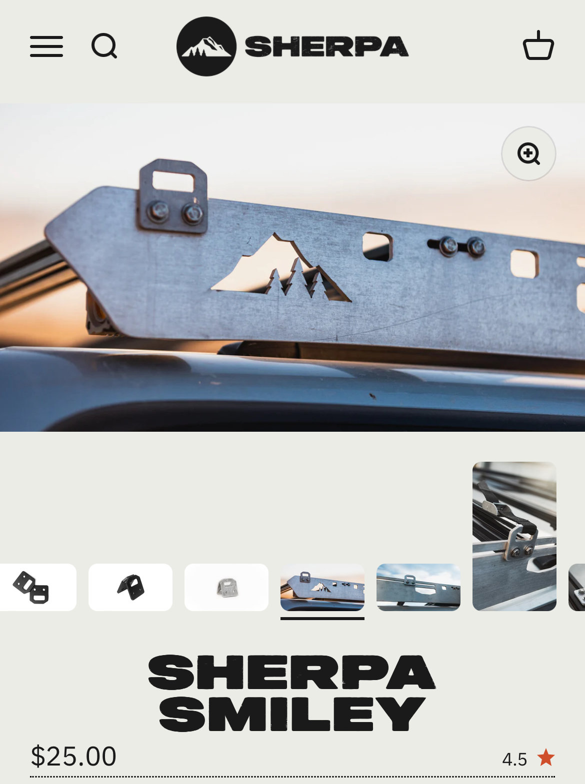

    I might try to make a longer mount at the roof rack too. So it bolts to both fairing holes. That way it’s higher up for better deflecting, and stronger mounting.
    maybe generic SS flat bar, grinded to length and rounded for smooth shape so it doesn’t snag
    they also sell pre punched bar, if the holes even line up

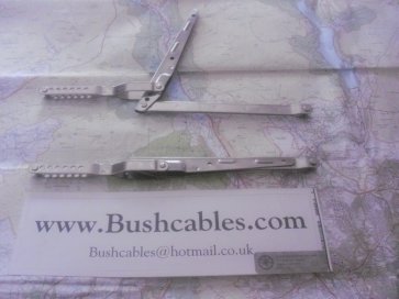

    might get longer 3/16 sheathed cable or use something smaller like what Bushcables UK uses
    if anyone knows how to do this, please post

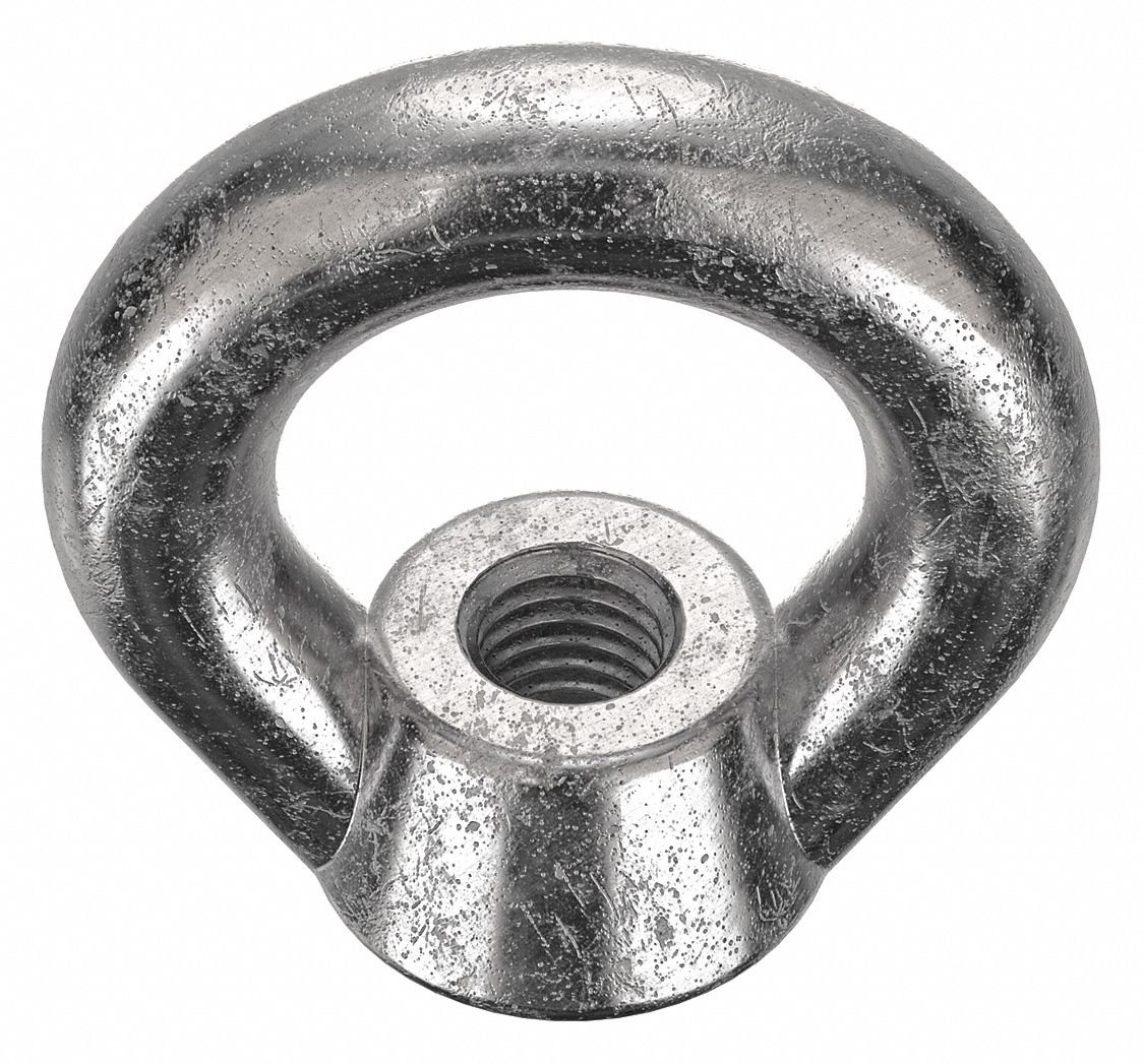

    an eye nut of the right thread could theoretically screw onto the rear Ubolt stud (trimmed to length)
    but odds are it won’t end up finally sitting at the bottom turned to an ideal angle after it’s screwed on.
    But, an eye nut would mean no welding required.
    IDK if they make a swiveling type, or way to put a bearing to add swiveling, but that would add cost. And more parts to fail.
    Or, maybe the cheap U-bolt can be treated as one time use, and has enough ability in the thread to simply overtighten the eye loop nut to whatever position you want, even if that stretches the thread. And done.
    Then if needed, replace again for $2-4.
    Hopefully that tightening, combined with thin profile of a Home Depot u-bolt, does not cause cracking into the powdercoat.
    In which case, a clamp may be safer, but cost more.

    pretty much something like this:
    whatever somewhat medium size spring I found at Home Depot advertised being 10lb rating. I'll see if that's good enough or not in practice. At least it has some give. No spring means no give or tension.
    what they had was an open spring. Easier for someone tampering to unhook it. Hopefully that doesn't happen.
    they had like one drawbar spring (enclosed on both ends) and it was gigantic.
    quicker releasing locking pins could even be added too.
    though hopefully a bumper mounted sits wide enough to not need disconnecting.
    As for fender-mounted, it may need disconnecting every time to open the hood.
    maybe a drawbar spring is not useable. I see McMaster sells two kinds. Basic expansion, and drawbar, with drawbar being a minimum of 4" length which sounds too big for this application.

    when i build these back for my land rover years ago I used the draw bar spring from a dog run cable kit

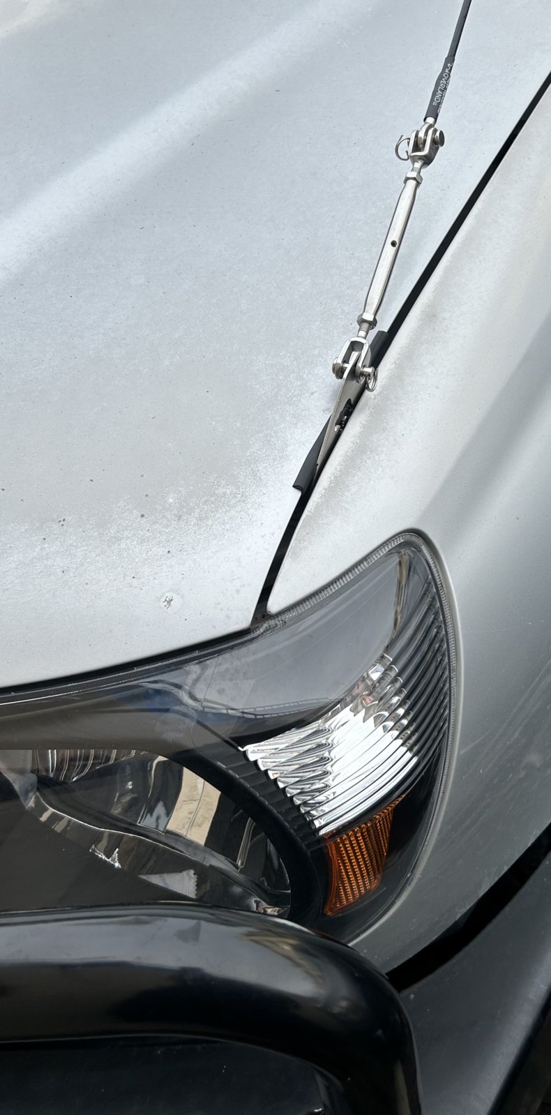

    I wanted an easy and quick setup for my limb risers. I will be making a change once I install my snorkel, but this is what I did recently.
    I did not want to use plastic coated wire because I believe it cause some things to snag on it and I expect the plastic would get gouged and look bad fairly quickly. I chose 1/8” stainless steel wire for the risers. I used some 5” extension springs I already had, and I used some 12” vinyl coated 4mm stainless steel sections I got off Amazon for each end. I figure the vinyl coated wire will stay in place for the most part on my roof rack and ARB bumper better than uncoated wire.
    Once I had the 1/8 wire measured, I added the crimp loops to each end; however, on one end I permanently attached one end of the 5” spring with the loop.
    When I install them, I wrap one of the 12 vinyl coated sections around the 1” bar on my roof rack. Then I used a stainless locking ring to connect the spring to the vinyl coated wire.
    Next, I wrap another section of the Vinyl coated wire around my brush guard on my bumper and connect the other end of the 1/8” wire with another locking ring.
    Simple, quick, and replaceable.
    Per the OPs question, if I did not have my ARB bumper or roof rack I would fabricate a bracket like what NHO sells for the under hood mount and fabricate a bracket that would mount to the roof mounting points like my roof rack uses.

    the NHO kit is one of if not the cleanest design out there
    just need to figure out how to make mine attach to the highest point of the rack and bumper with a spring.
    -a spring will provide give to thick branches to reduce stress
    -high two-bolt rack point clears better and is stronger
    -attaching to bumper hoop; same thing. Clears better, is stronger
    -less interference with hood opening
    -spring also necessary to allow for body to frame/bumper flex
    I need to figure out where to get that spring.
    yes, adhesive shrink tubing can be used to clean up the look. I saw Home Depot has a crimp tool.
    maybe your bumper mount is better than the idea of a u bolt with eye nut
    as that would look like crap.
    Only bracket that would look good is the ARB CB antenna bracket, but at $50/ea fuck that. Maybe only actually worth it to run a single one for its original purpose to hold an antenna.
    I might make a bracket that mounts to the highest point of the rack using more bolts
    possibly out of flat steel bar stock from Home Depot
    hopefully that loop is not moving abrading the bumper, or the wire not shaking around. If not then I guess that 5” spring works, might consider trying that.
    Whatever spring I got cheap at Home Depot is much smaller and may not be up to the task.

    I got my spring from McMaster Carr part # 9654K237. Its not Stainless and will probably upgrade it to stainless at some point but it was what I had laying around at the time. came in a pack of 6 for ~ $17.00
  19. Jan 24, 2024 at 3:07 PM
    #39
    TacoTuesday1
    TacoTuesday1 Well-Known Member
    Jun 19, 2019
    #296781
    7,776
    SD CA
    Honestly what I’m most concerned about is what pressure spec the spring has to have to work for this, and haven’t found any info on it
    the little spring I got from Home Depot is rated at 10lbs which I’m guessing is not enough
    1. to avoid excessive shaking while driving
    2. to provide enough tension so the wire is taut straight and not sagging
    I’m guessing the 5” spring is a higher spec due to being thicker and larger
    the cheap little ones at Home Depot are smaller than a pinky. Probably would look too small and goofy installed too.

    here’s pics of how it’s currently set up
    don’t know when I’ll figure out higher rack mount, bumper mount, determining ideal longer cable length
    or if higher rack mount is even really needed (multiple ways to do it)
    Might try to figure out how to add a quick release, or put easier releasing clips in the turnbuckle pins for a more streamlined look
    as of now to remove it I grab pliers to loosen the turnbuckle locking nuts. Not instant but doesn’t take long either.
    I don’t know if the hood would clear the wire in any case but it definitely doesn’t clear the turnbuckle now.

    So if using bumper U bolt with an eye nut, to make it able to swivel when screwed tight

    Don’t know if it fits Sherpa
    Prinsu hook

    actually, there is confirmed fitment Sherpa stuff
    angled rack bracket probably better than flat one, to prevent limb riser cable from hitting the front fairing area.
    the Sherpa smiley is offered in 45 and 90 deg
    If using that option not sure which is better for clearance
    Might test with a cardboard mockup first
    looks stronger and easier to attach to than their 90deg antenna bracket
    this looks clean (bumper tube)
    looks like SS rubber-lined clamps painted black, with flat bar welded on
    but bolt at the rear for use mounting lights forward, so it's not welded for best appearance if flipped to use as limb riser hook point
    found these, thinner than the ugly bulky wide ones
    and a lot cheaper than ARB CB bracket which is $50/ea x2=$100
    looks better than above
    full circle, rubber ring
    should be less harsh to powdercoat
