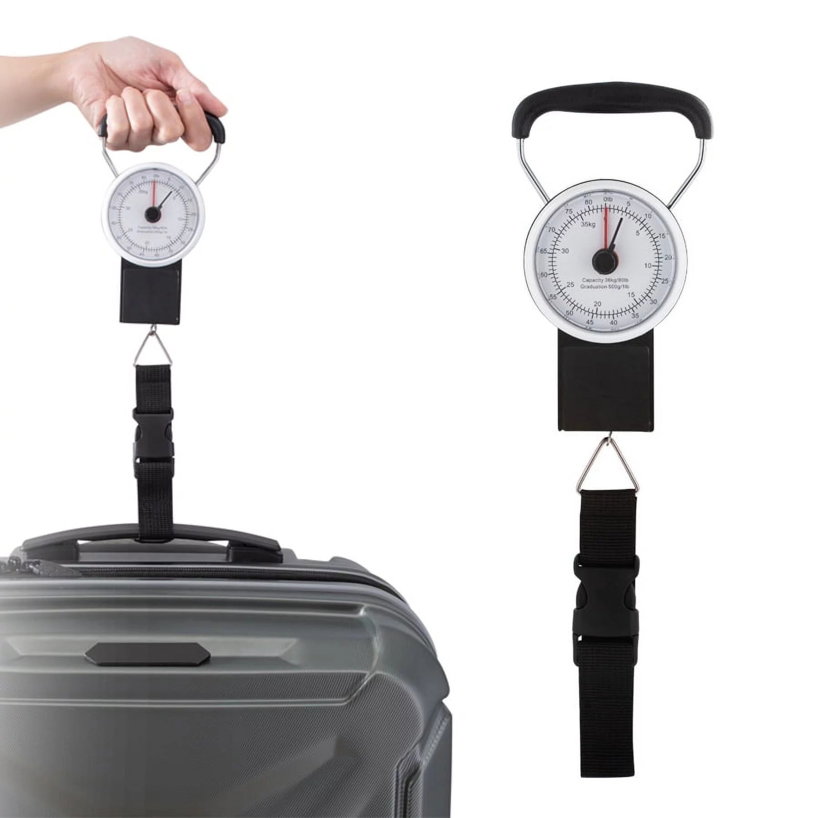

    Pretty sure I have a luggage scale somewhere. That might be a way to figure this out.
    1. incorporate scale in line, and set proper wire tension. Note weight on scale

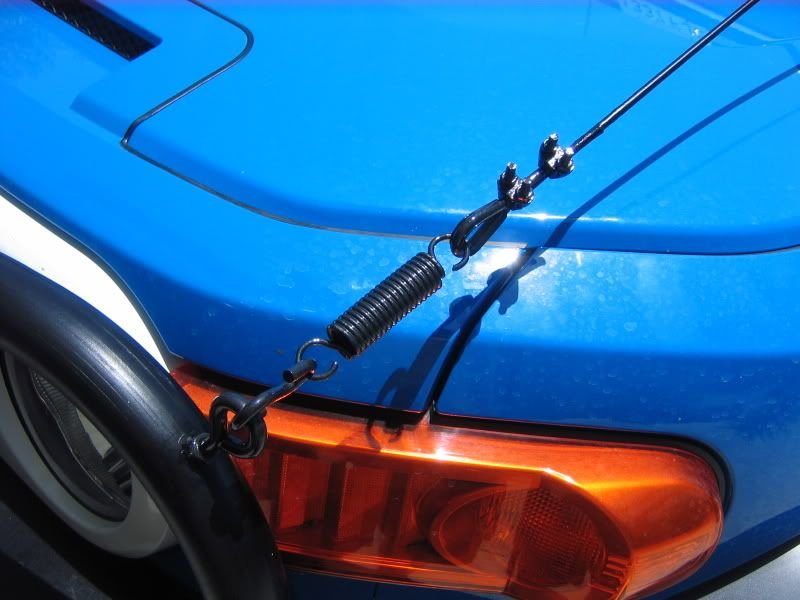

    stronger spring that remains compressed when not pressured by a tree branch would be ideal so there isn’t open spring gaps for things to snag on. Or constant force to cause fatigue.
    black would be nice but if it’s stainless oh well. Short or medium would probably look better than long.
    the fact that this guy's spring is still compressed while mine is not also tells me whatever 10lb I got is inadequate

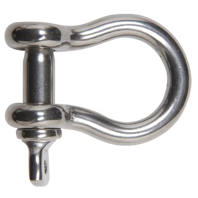

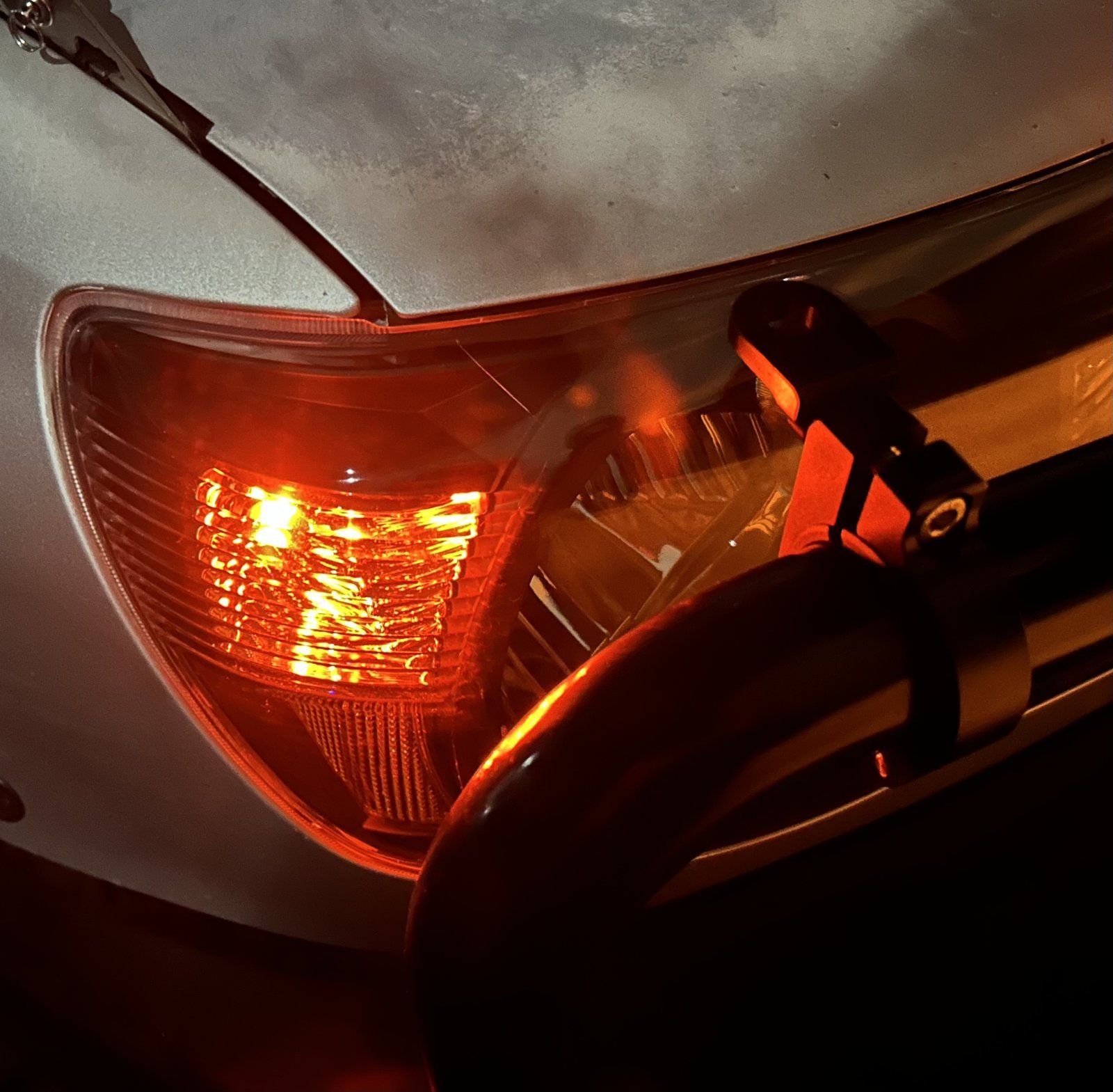

    mounted a bumper bracket from Amazon using 1.85” rubber sleeve adapter
    Gotta figure out how to mount to that. One way could be mini shackle looped into the bracket Home Depot sells.
    Slid the bracket outward as much as possible while keeping it on the flat straight part of the tube before the curve bend
    tried a stronger ~16lb spring and noticed it has less expansion and allows for more tightening of the cable, better than the weak 10lb or less spring I tried
