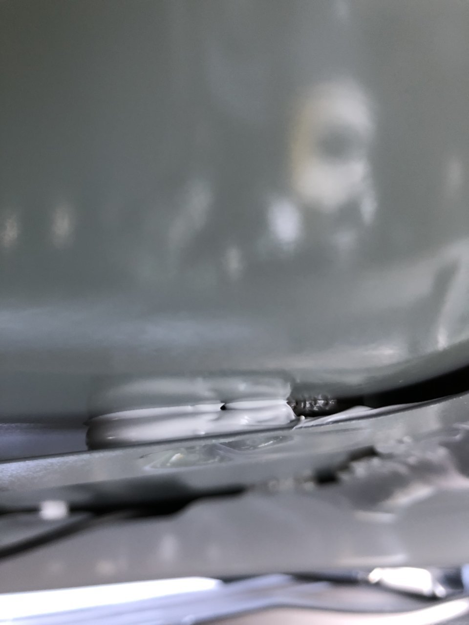

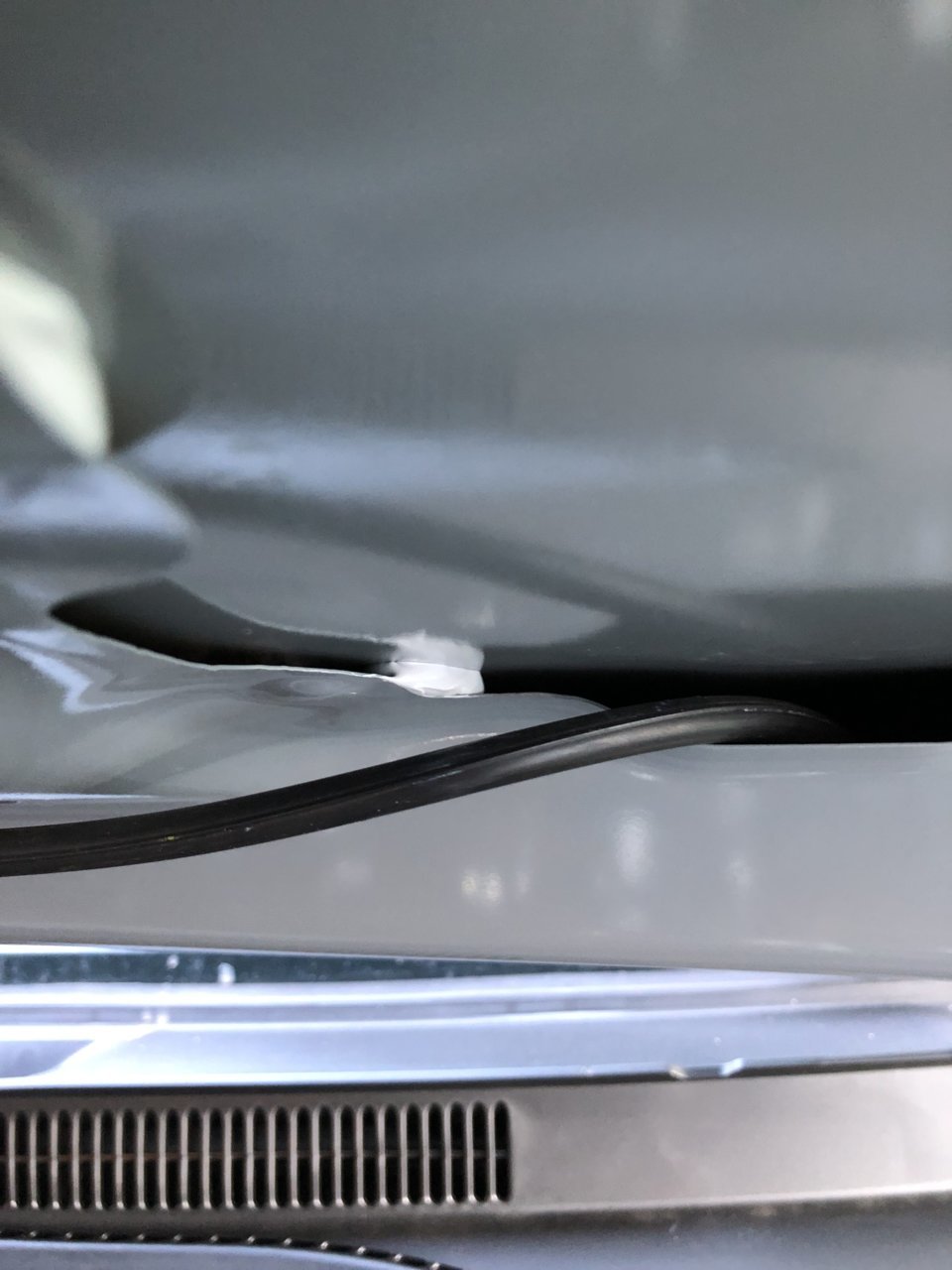

    noticed it on the way home from dealership. Googled the problem and found in the past they had problems with the glue holding the hood skin to the bracing. Popped my hood and sure enough the glue is stuck to the braces but not to the hood skin. Anybody else with a 2019 had this problem? Not sure whether to take to dealer or fix myself. Don’t really want to take it in if they are going to take the hood off. I’d rather get the right adhesive and just squirt some in the voids myself.

    I had it fixed by my dealer on my 16. I’d just do it myself, it’ll look better when you are finished.

    Google this stuff It's made exactly for this application To lay it done correctly you will need the gun
    3M 08463 Flexible Foam - 200ml
    You want to use material that has some flex so not to create distortion in the sheet metal under wind loading.

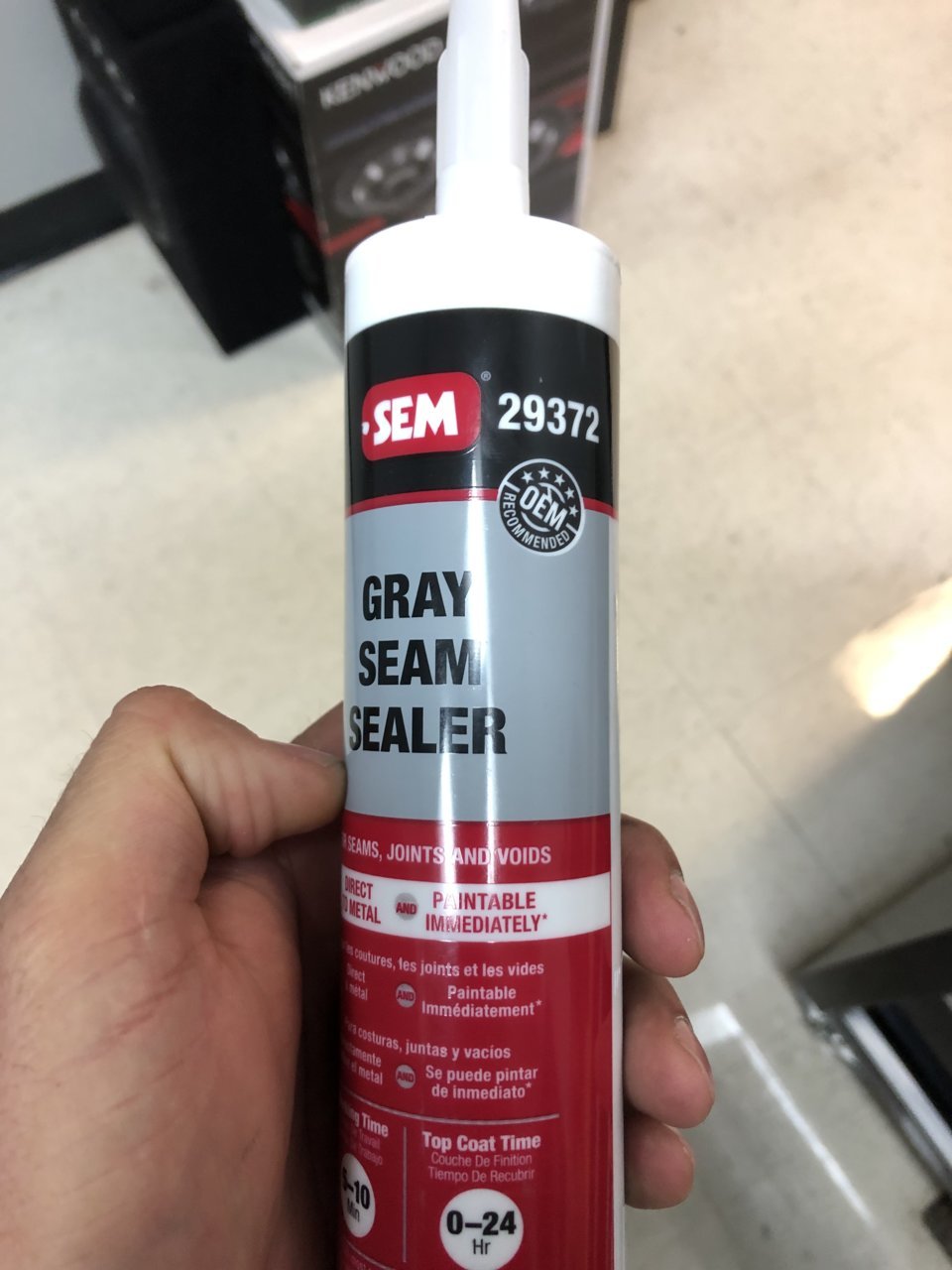

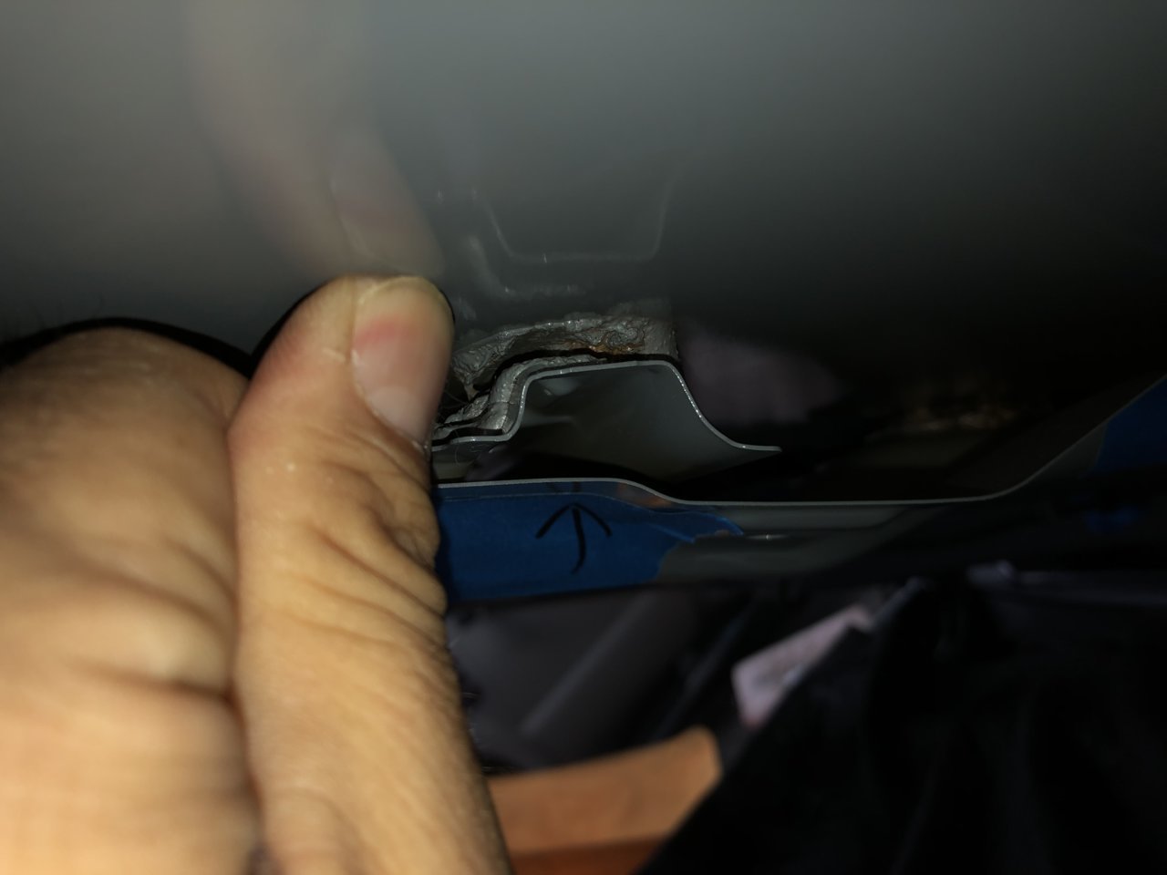

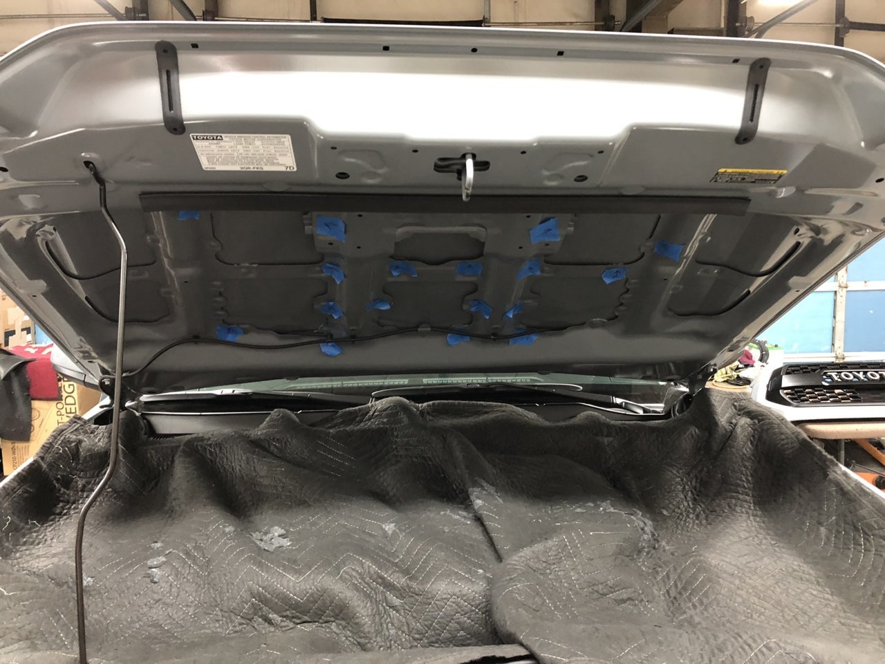

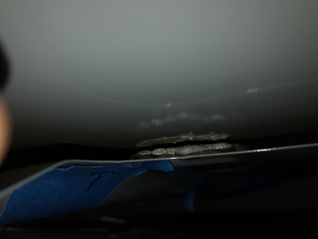

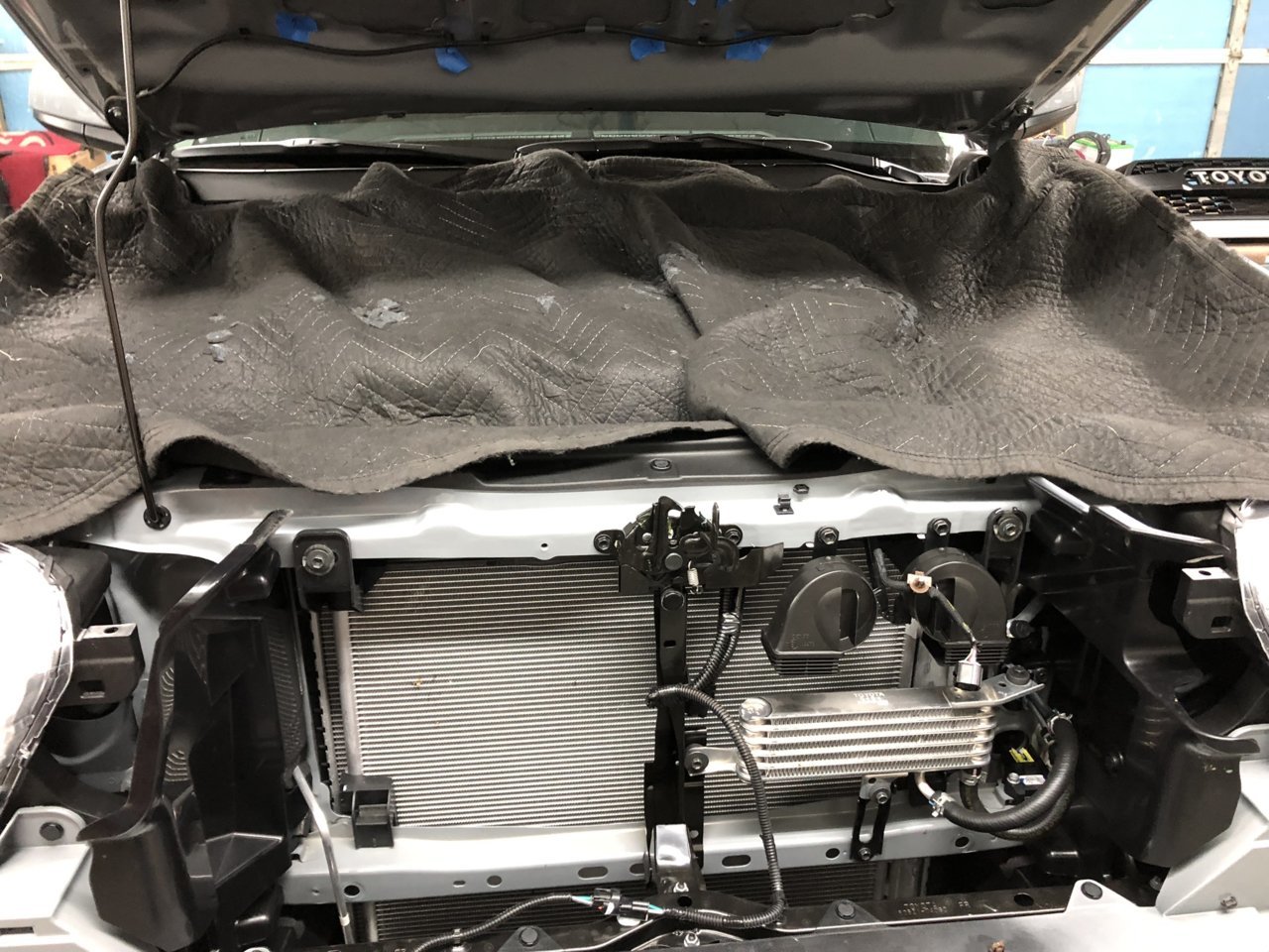

    Finally tackled this problem today. A buddy owns a body shop and brought me a tube of SEM seam sealer in gray. It is applied with a caulk gun. I removed the grill for better access. Covered the engine compartment for drips if any. Stuff went on easy and worked great. The first 2 pictures are before and the last 2 are after.

    Guys. I bought mine the day it came off the truck at the dealership and noticed the problem the next day so it was definitely bad from the factory. I contacted the dealer and they gave the usual never heard of it response. I had already researched it and there have been lots of people with this issue. Some people said the dealer removed their hood and fixed it. Others said they replaced the entire hood. Problem with that is the hoods aren’t painted so the body shop has to do that. I have a friend that owns a body shop and after talking to him I was sure I could do as good if not a better job of fixing it and without removing the hood. He gave me the seam sealer but it can be bought for about $15 online. It uses a standard caulk gun and it’s easy to apply. Don’t be scared to try it. Just cover the engine compartment for drips and keep wet rags or paper towels handy for your hands and any excess that might squirt out. I basically visually inspected the whole thing first and marked all of the bad joints that way the repair would be smoother. I pushed up slightly on the hood skin in the effected areas and squirted the sealer in. When I let go of the hood skin it returned to its natural shaped and smushed the sealer. The end result was clean and worked perfectly. No more vibration. Ps I also removed the grill so I could reach all the areas better.
