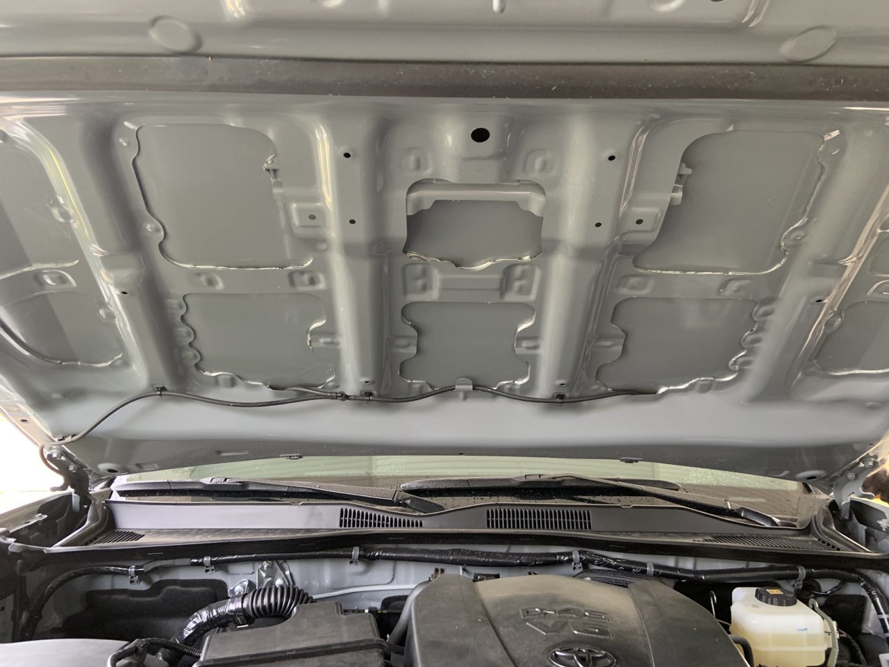

    My new 2020 has the same issue. Highway speeds causes the hood skin to flex dramatically. It's quite annoying.
    Upon examination, there are only (4) points of "glue" between the support framework and outer skin. And three of those has torn through. I don't believe that the glue points are actually suppose to glue the pieces together, but only to act as a deterrent to metal on metal vibration. The substance they use as a glue is a foam of some sort. As an actual glue, I don't see how it would be successful.
    I also used a 100% silicone (crystal clear) to buffer the outer hood vibes. I'm not caring if it actually "bonds". I just want it to support the metal. So far so good. My only downfall was that I didn't apply it in enough locations. I'll have to revisit the caulk gun again.

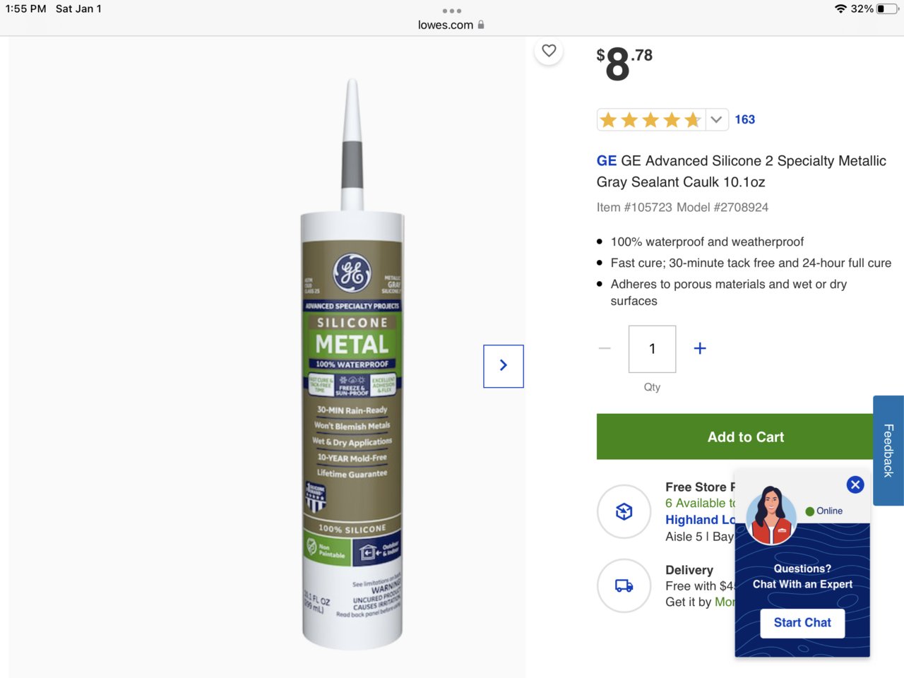

    I finally fixed this on my ‘21 TRD OR today. My hood vibrated from day 1 (I’ve had the truck for about 14 months now) and almost every factory foam connection point was broken by the time I got around to it today. I also used the gray GE silicone (for metal) from Lowes, and I agree it matches my cement color nicely.
    It was very easy to do, the whole process took maybe 10-15 min. Way easier than wasting a half a day waiting for the dealer to probably not even do it nearly as good as I did it. I just pushed up lightly on the hood with one hand (when necessary), and I stuck the tip of the silicone in there and pumped the caulking gun with the other. I used it very liberally and then I pushed up on each glob a few times from the bottom to make sure it made good contact and got smooshed in there well. Have a roll of paper towels handy and put an old towel down or something over the engine because it gets pretty messy. A step stool helps too for the area of the hood that closest to the windshield. I’ll give it the rest of the day to cure since I have no plans of leaving the house today anyway, but it says it’s waterproof in 30 min on the tube, so it’s probably already fine to drive.
    I’ll report back if it this GE stuff doesn’t do the trick, but I don’t see it not working well (and it’s a fraction of the cost of the other 3M adhesives that others are recommending - especially with the special gun you need to buy for that stuff!). I can’t believe the original factory stuff is such shitty foam that gets dried out and breaks so easily. Silicone will hold up 100xs better. Sometimes I wonder what these automaker engineers are thinking. This is exactly what I used…
